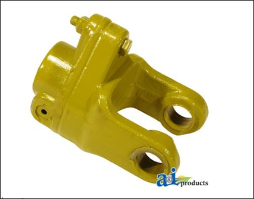

I installed shear bolt yokes in a tiller, brush hog & flail mower PTO shafts, and have snapped the bolt couple of times while running brush hog.
