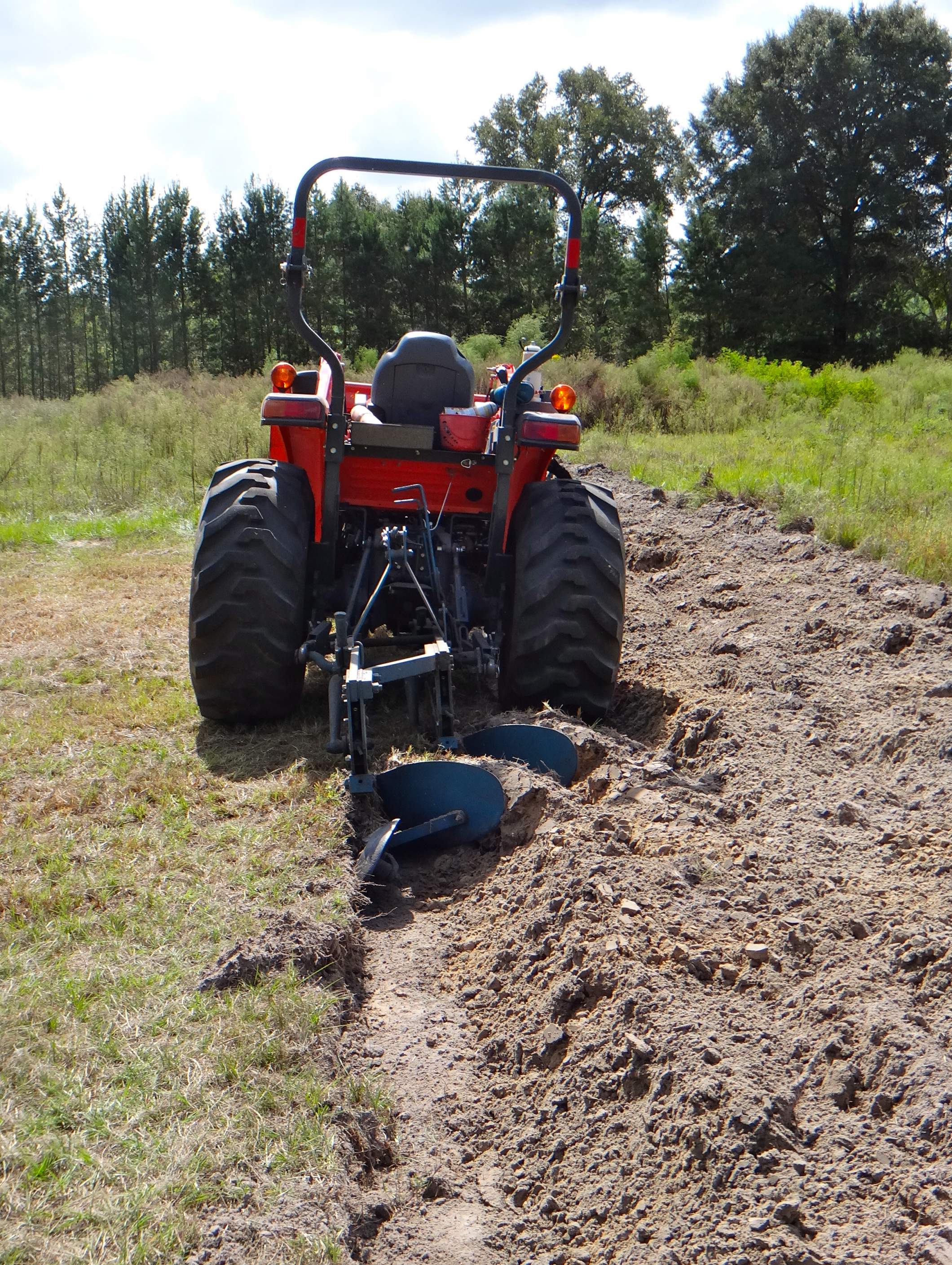

No. FEL buckets do not skim. I suggest a Three Point Hitch mounted traditional Moldboard Plow in 12" width. An MX will pull a three bottom 12" width moldboard plow. A 12" plow will properly invert soil in the narrow range of 5" to 7". After plowing use the roto-tiller to smooth the field. PHOTO

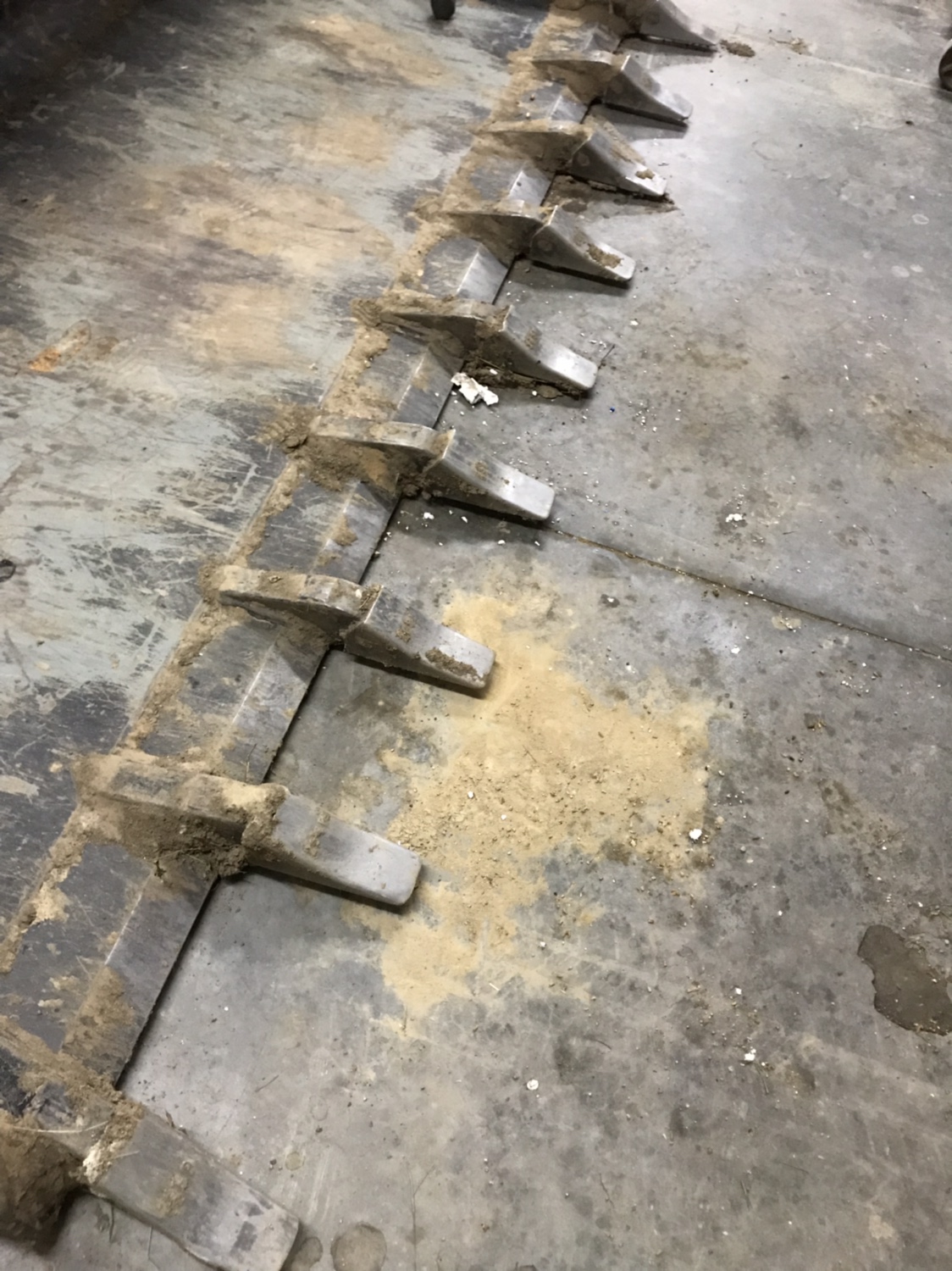

I have a heavy duty round back FEL bucket. I put a nine tooth - tooth bar on this bucket. Essentially I gave up the back dragging function with the addition of the tooth bar. As /pine indicates the heel of the bucket is not as good as the cutting edge w/out the tooth bar. I now have an UBER heavy grapple on the FEL.
I also have a heavy duty Rhino 950 x 8' rear blade. I reverse this blade 180 degrees and drive forward. It does every bit as good as the lip of the bucket ever did.
Different strokes for different folks............View attachment 640572

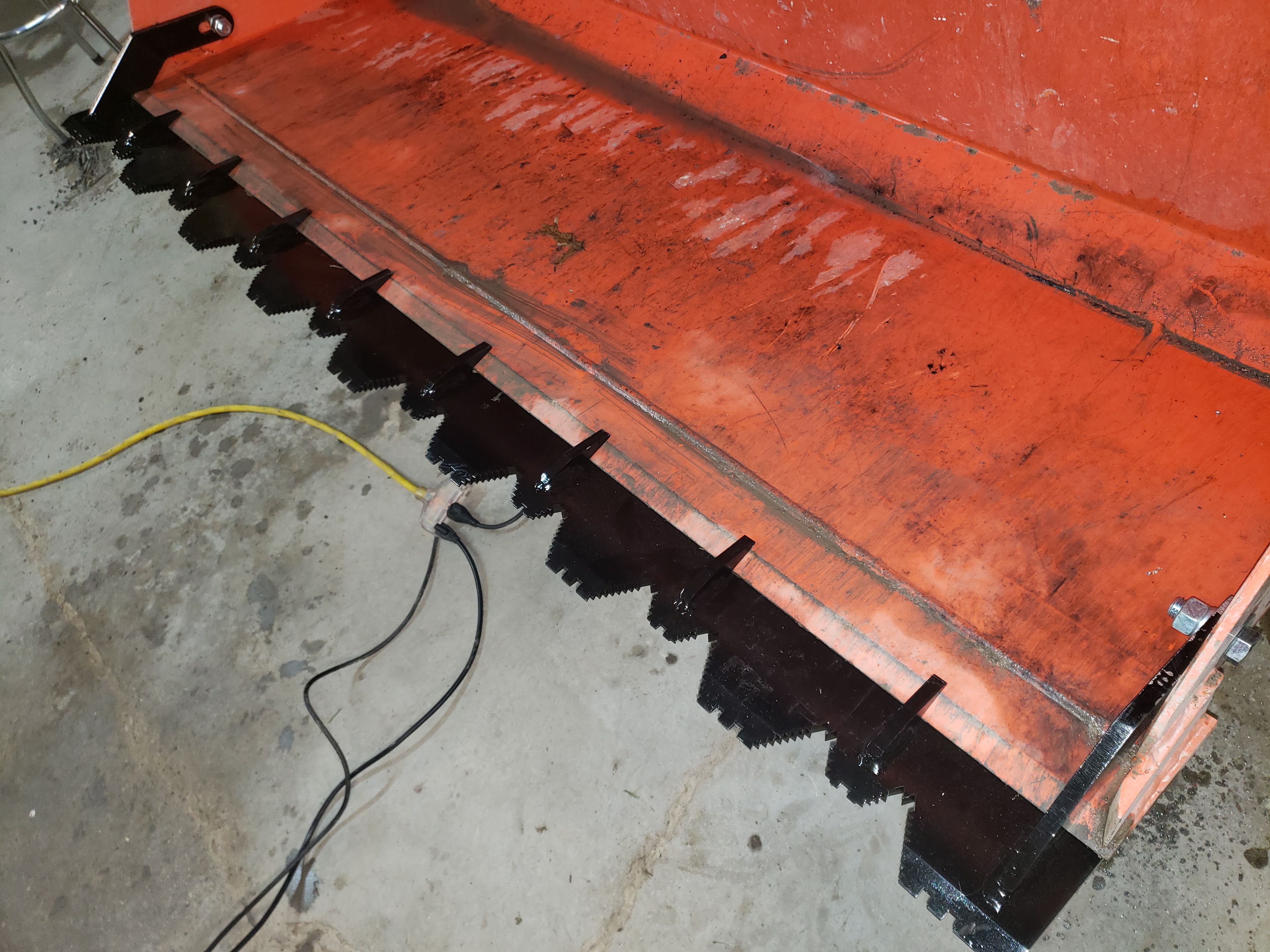

Just wanted to follow-up on this thread as the original poster. I eneded up with the EA Wicked Toothbar. This went on my light-duty bucket using the 3/4" bolts on the side. Install was a breeze and the sizing was about as spot on as humanly possible. I did spend the time to get the measurements right, but they made it to those specs exactly.
I have so far done some quick tests and this thing is blowing through my hardened dirt/clay/tree root piles with ease. It also does pretty good at removing the top-cover of my unworked fields. I've pushed/cleared brush back and it seemed to do really well in cutting/ripping/slicing through brush, vines, small saplings. I'm no where near beating it as hard as I saw Ted do in his test video but it seems like a good add to the bucket so far.

Thanks for the letting us know. But it's only an internet rumor without pics :)
You are correct!! I wish someone showed more before/after of what they did with it. Here's a pic of the bar installed.toothbar.jpg

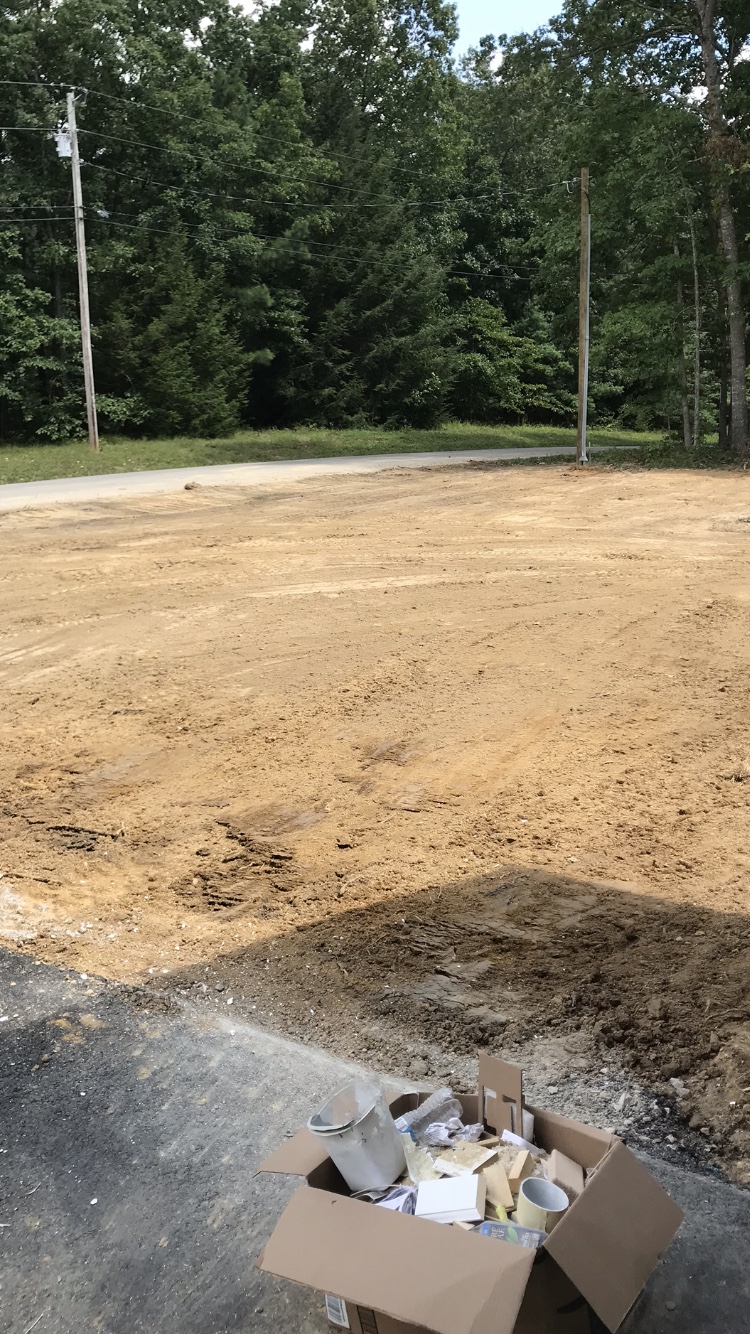

Built a U shaped berm last night I'll use to burn my piles by digging up my large piles of weed, rock, roots, clay that came off my foodplot. This stuff has been sitting for 2 years and was composting/compacting. The toothbar had no issues with that pile at all. I did also push some brush back off trails. This was mostly multi-flora rose and it did pretty good. The issue with a toothbar/bucket combo is that it still can't pick up the stuff although it does a good job of shearing it off. Maybe even a rock-skeleton bucket to allow for rock/dirt sifting. Can't have it all I suppose.
Seems like a bucket/toothbar/grapple lid OR a toothbar mounted to the bottom of my grapple would be the cats pajamas for ripping, tearing and REMOVING brush. It seems like I can still back-drag good enough for my purposes which is rough leveling.
