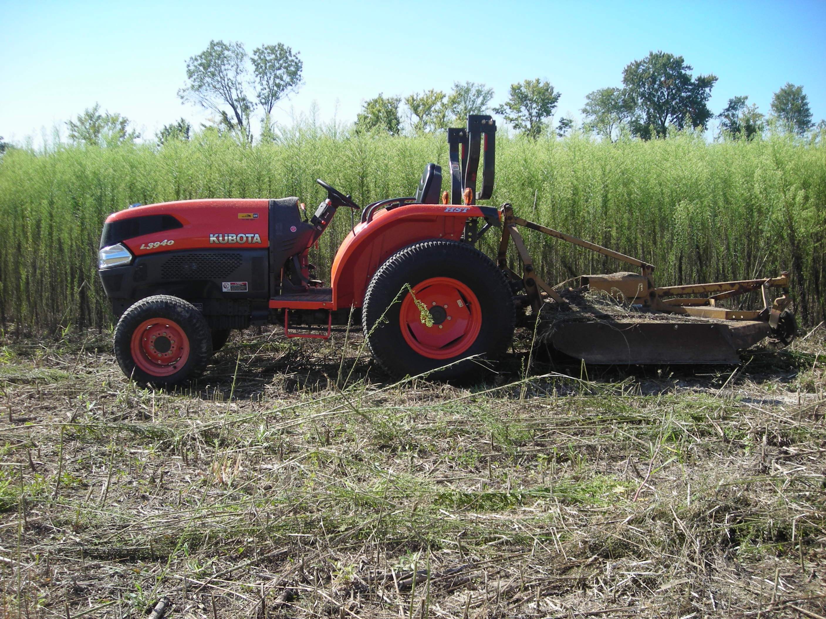

Here is a 3940HST with 6' hog mowing down 6' of weeds. When it gets this tall, I have to slow cruise down to 4 mph or so. Normally run cruise at 4.5 to 5 mph. Philip.
