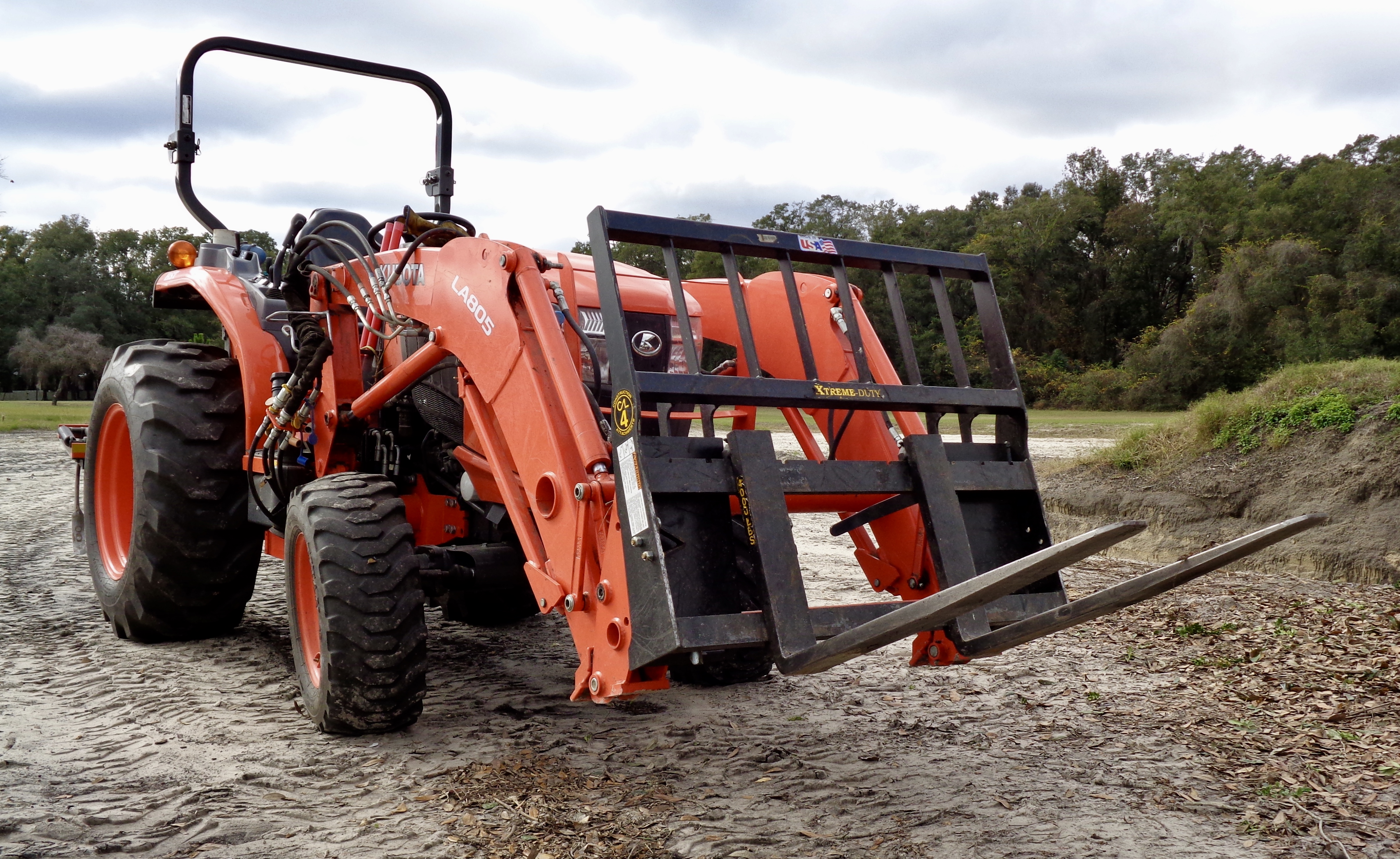

If you can forego the mid-PTO standard on the Kubota 'B' series buy the L2501 instead.
Sufficient tractor weight is more important for most tractor applications than increased tractor horsepower. Bare tractor weight is a tractor specification easily found in sales brochures and web sites, readily comparable across tractor brands and tractor models, new and used.
Within subcompact and compact tractor categories, a significant tractor capability increase requires a bare tractor weight increase of 50%. It takes a 100% increase in bare tractor weight to elicit MY-OH-MY!
The JD 2305 has always been ( under powered ) under weight for what I need to do.
You will realize minimal tractor capability increase between an 1,800 pound Deere and an 1,800 pound Kubota 'B' from increase in tire/wheel size without stepping up tractor weight. The taller wheels/tires on a same weight Kubota 'B' will make the 'B' seem tippy to you. Instability will be exacerbated by installation and operation of a grapple. You need the 900 pounds greater weight and 8" wider rear wheel spread of the L2501, relative to the Deere.
Kubota L2501
  • 12" ground clearance
  • 3-range HST transmission
  • 100 cubic inch displacement engine
  • 2,700 pound bare tractor weight
  • Tier IV emission paraphernalia NOT required
BUY ENOUGH TRACTOR THE SECOND TIME​
I believe FEL Pallet Forks will do everything you wish a grapple to do on 12 acres at 1/3 the cost and 1/3 the complexity.
I have had almost no issues with my two Kubota's over the years.
I buy enough tractor so I am not beating it during normal operation.
I keep the tractor options as simple as possible.
TRACTOR PALLET FORK VIDEOS:
