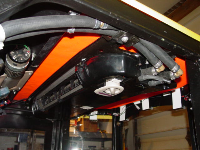

/ Question on cabs for X738 #6
if you have head room. you can do this air coil from a dodge duringo celing looks like this DSC04230.JPG

/ Question on cabs for X738 #10
I had the BM24082 Original Cab CO from Deere Dealer soft cab on my X748 and tried a lighter type plug in heater from the local auto parts store. It did not work well at all. I bought the BM21480 coolant type Deere heater from my local dealer. What a difference. This year I replaced the soft cab with the John Deere 9354M hard cab. Then the fan motor died on one of our coldest days. I replaced the fan motor with a Gentle Typhoon 120mm 4250 RPM from Coolerguys.com. What a difference in the air flow and heat from the heater. No more fogged windows, and now I have a lot of heat. I just installed the wiper this weekend. Now I need to install a washer system for the wiper because of how dirty the windshield gets.
