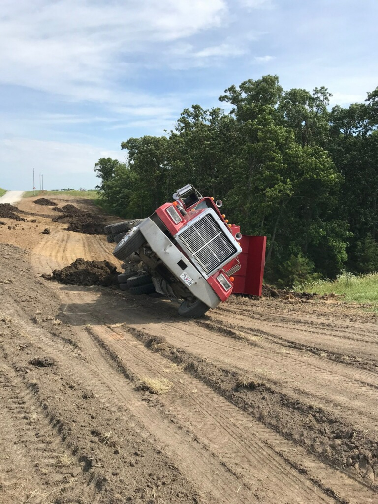

/ Question: is it difficult to drive dumptrucks? #20
Yeahhhh, we're going to try to avoid that
It doesn’t take much to flip one dumping on a side grade. The tolerance for side dumping angle isn’t more than just a few degrees slope. Gravel that spills out at a low angle isn’t as bad as dirt that’s bad to stick until full height and sometimes doesn’t release then.
