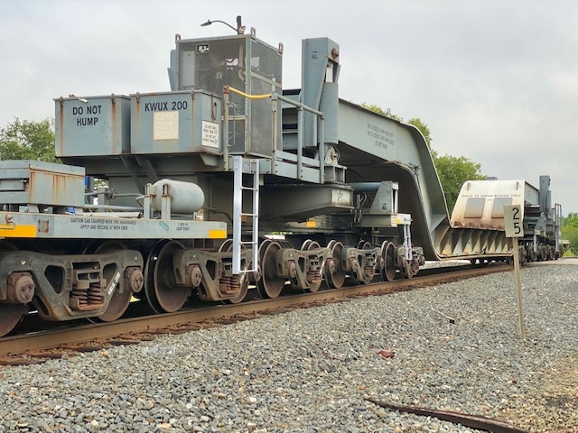

On our morning walk we came across this massive train car. I've never seen one like it. Five sets of trucks on each end. Massive hydraulics on each end for lowering and raising the bed as well as moving it side-to-side for some reason. Big metal pads on the angled parts of the bed that indicate 'weld here'. Obviously for handling huge loads but I'm not sure exactly what. I've seen flat bed cars hauling Abrams tanks and huge dozers that were nowhere near this big or complicated.
Has big letters saying max speed loaded is 25mph, max speed empty is 45mph and "Do not hump" whatever that means.
Curious if anyone knows any specifics about it. Hooked in front of it there was a "Scale Test Car" which also said "Do Not Hump".

It's a Schnabel Car used for hauling VERY large transformers to electric power distribution centers needed by server and data farms. The "DO NOT HUMP" sign indicates it is not to be floated at a 'hump' yard where car sorting is done by free rolling them down a hill to various sidings used to build a train manifest.
You should see the semi-trailer needed to move these transformers to their final resting place. No more room for wheels.

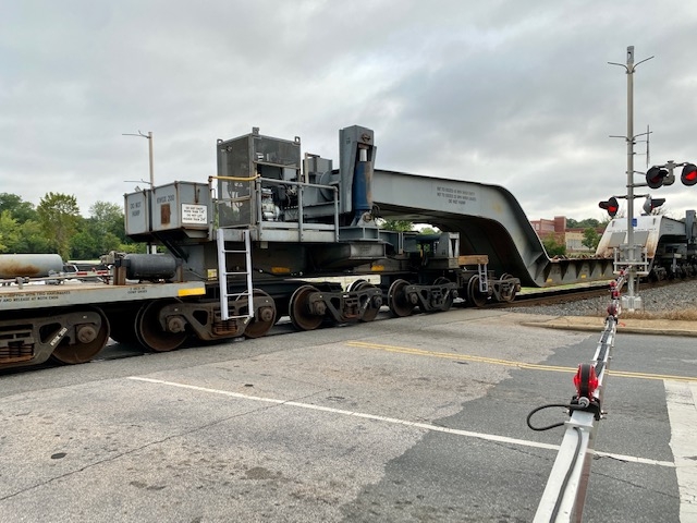

/ Question for train geeks. #4
See these all the time in Schenectady, NY - steam turbine and large generator transport.

I wonder if those large pistons on each end are shock absorbers or lift pistons or leveling pistons or both.
Edit: According to the data @bcp posted those are lift pistons.

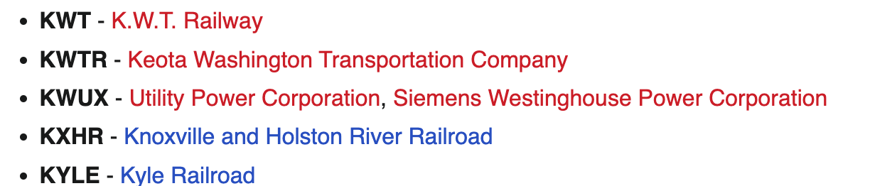

KWUX 200. Same number = same car.
Bruce
PS: The "X" on the end of a railcars owner initials (reporting marks) means it is not owned by a railroad.
