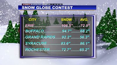

I like most others have said would just drive over it but knowing how South deals with even a 1/2" I would mount a piece of 2"x6" or 8" to the back blade so you are actually using it to push the snow and not the blade. You can also push with the back side of the blade if you don't want to add the 2"x. for the amount of snow you are talking about this will work fine.
