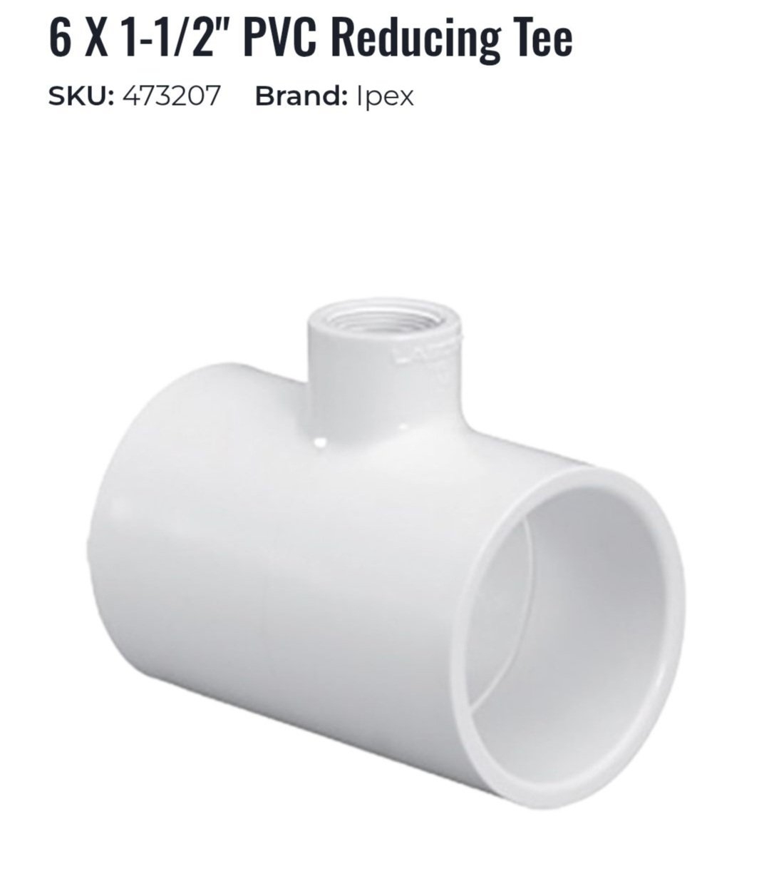

I'm in the process of doing something similar, except I'm tapping into a 4 inch sewer line so I can install another cleanout. Once I bury it in dirt, I never want to mess with it again. For the money, these look like the best way to get it done.
