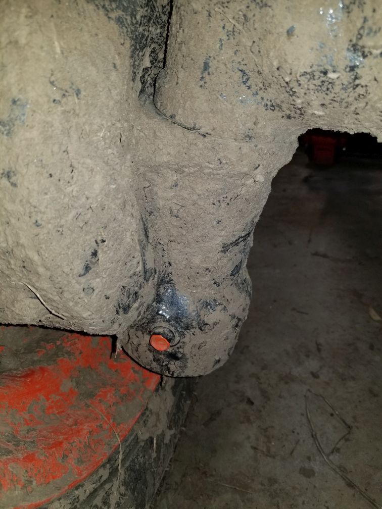

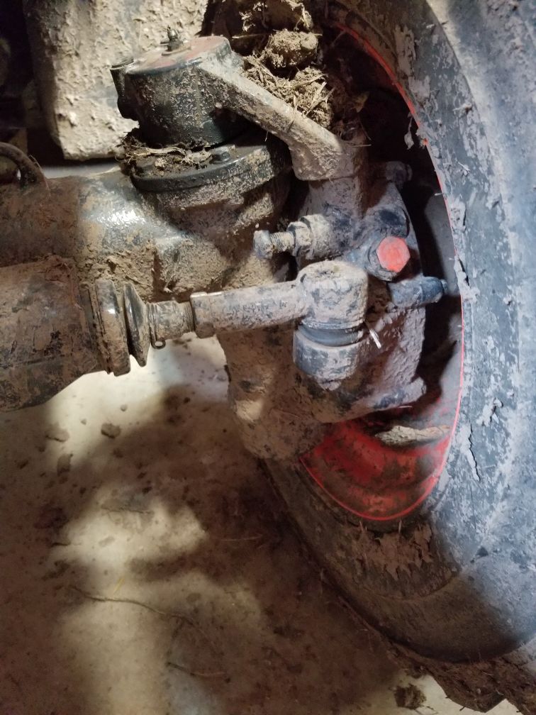

As others have indicated it is much faster to remove those two 15/16th plugs at the top of each side on the front to allow for removal of air when refilling. IIRC the drain in the center of the axle on mine was 9/16 while the drains at the wheels were 14mm. I used premium TSC Hydraulic Fluid to replace the factory fill. None of the drain plugs on my axle were very tight so something you may want to check if you've not got to your 50 hour service point yet.
