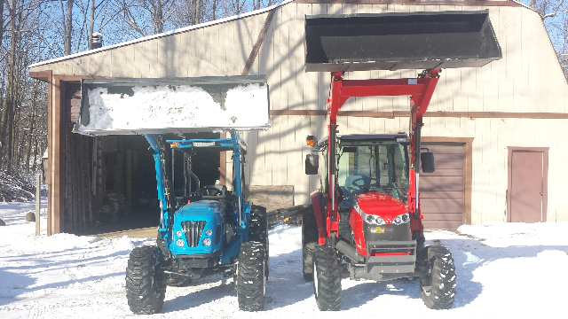

Just picked up a new Massey 1648. <img src="http://www.tractorbynet.com/forums/attachment.php?attachmentid=359135"/>
You lucky dog you! :laughing: My dream tractor! How do you like it so far?
/ QUESTION: any problem adding larger front tires?
#85
Thanks! So far so good. I'm liking the cab for sure, and the auto throttle is probably my favorite feature.
Just got a surprise hour of seat time on her ... got back from a long trip and had to spend an hour getting my truck & trailer unstuck in my driveway ... got sucked into a snow bank from all the snow and I want home to plow it.
Just what I wanted to do after 16hrs of driving. But, at least I had a heated cab & radio.
