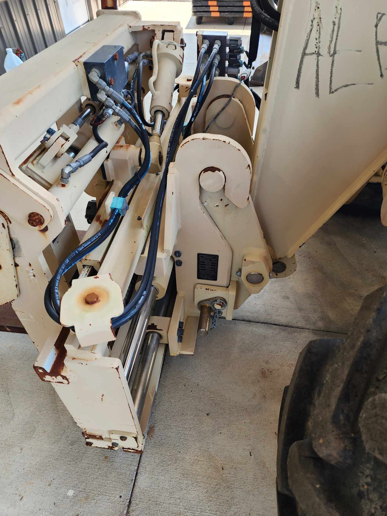

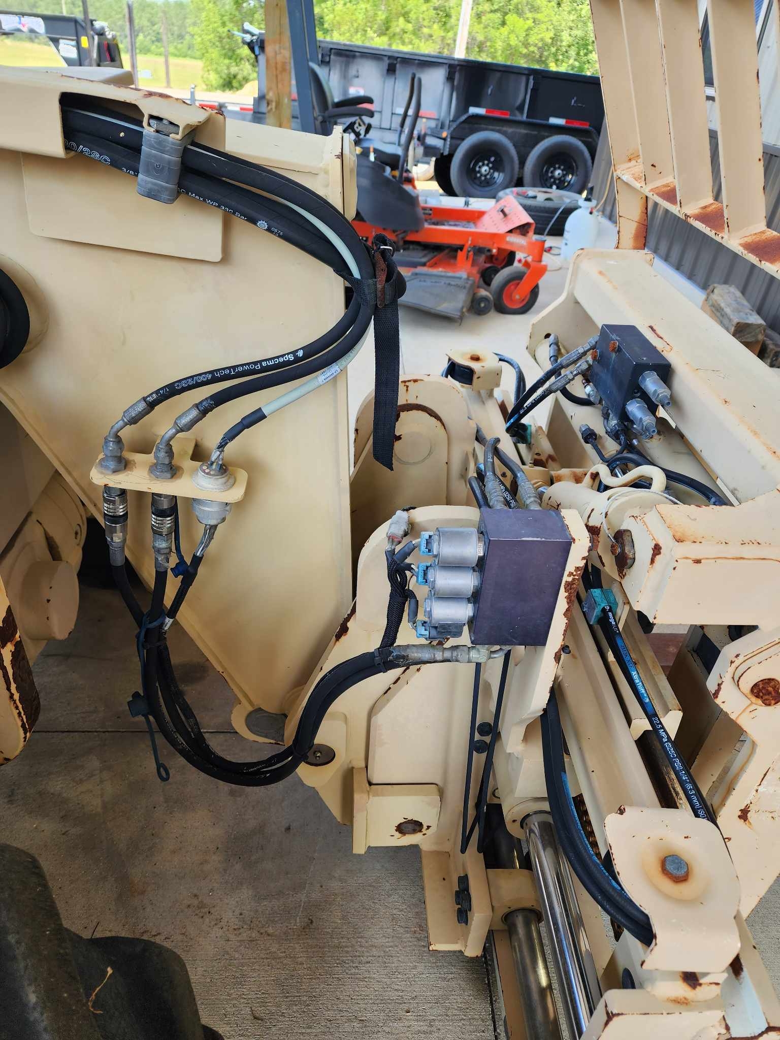

I am wanting to buy a telehandler that I can change the attachments on the front end.
I have seen a lot of the Kalmar RT-022, ex military rough terrain forklifts for sale at a decent price.
Can you change the forks to a bucket or grapple? Or even better, install a quick attach plate on it.
/ Question about converting to a SSQA type attachment. #2

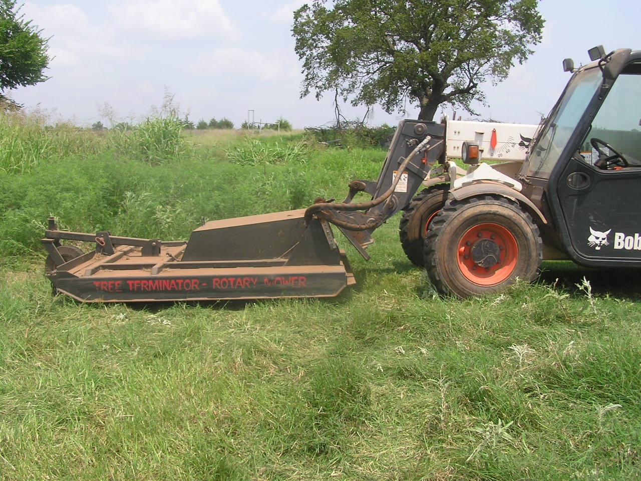

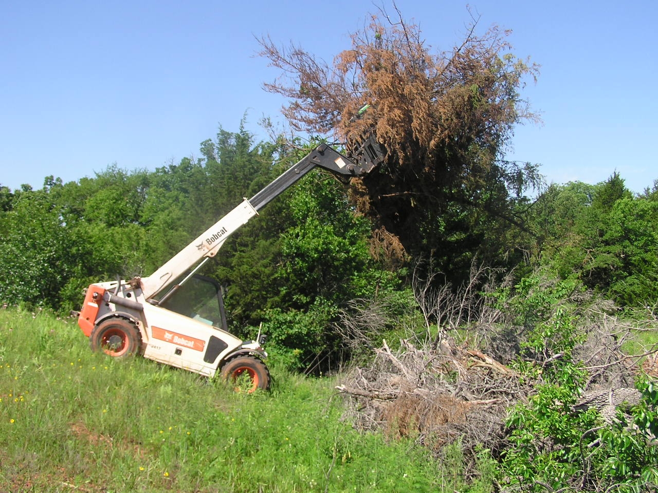

You can change most anything to suit your application. The issue arises in the complexity of the change and your pictures sure make it look complex.
/ Question about converting to a SSQA type attachment. #3
All that metal looks like at least twice the thickness of any typical tractor or skid loader quick attach implement I've seen.
/ Question about converting to a SSQA type attachment. #5
I wouldn’t put SSQA on a full size Telhandler. They’re twice or 3x as big as the machines designed to work with SSQA. The global style mount they already have is way better and stronger anyway.

I wouldnt put the SSQA at your current quick change. Put it on the current fork frame so you dont loose the shift, tilt and other hydraulic functions you currently have.
/ Question about converting to a SSQA type attachment. #11
That would make a very slick setup
