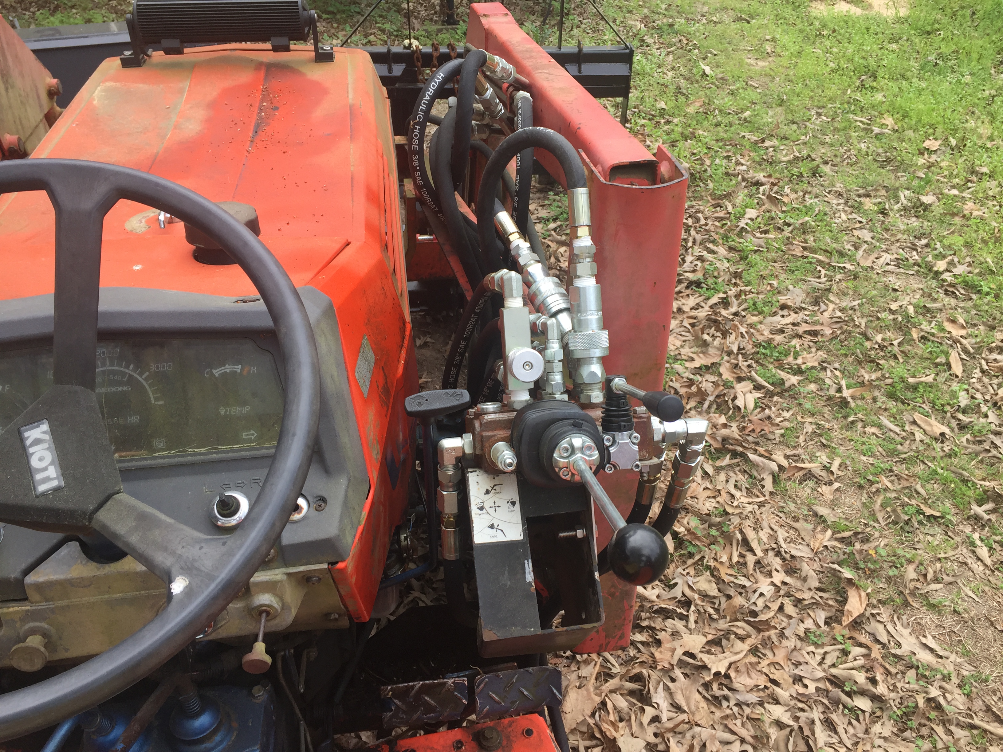

That should work if your valve has good feathering ability. I have an adjustable priority flow divider in my system that can slow things down to any desired speed, but it only works for raising, not lowering.
