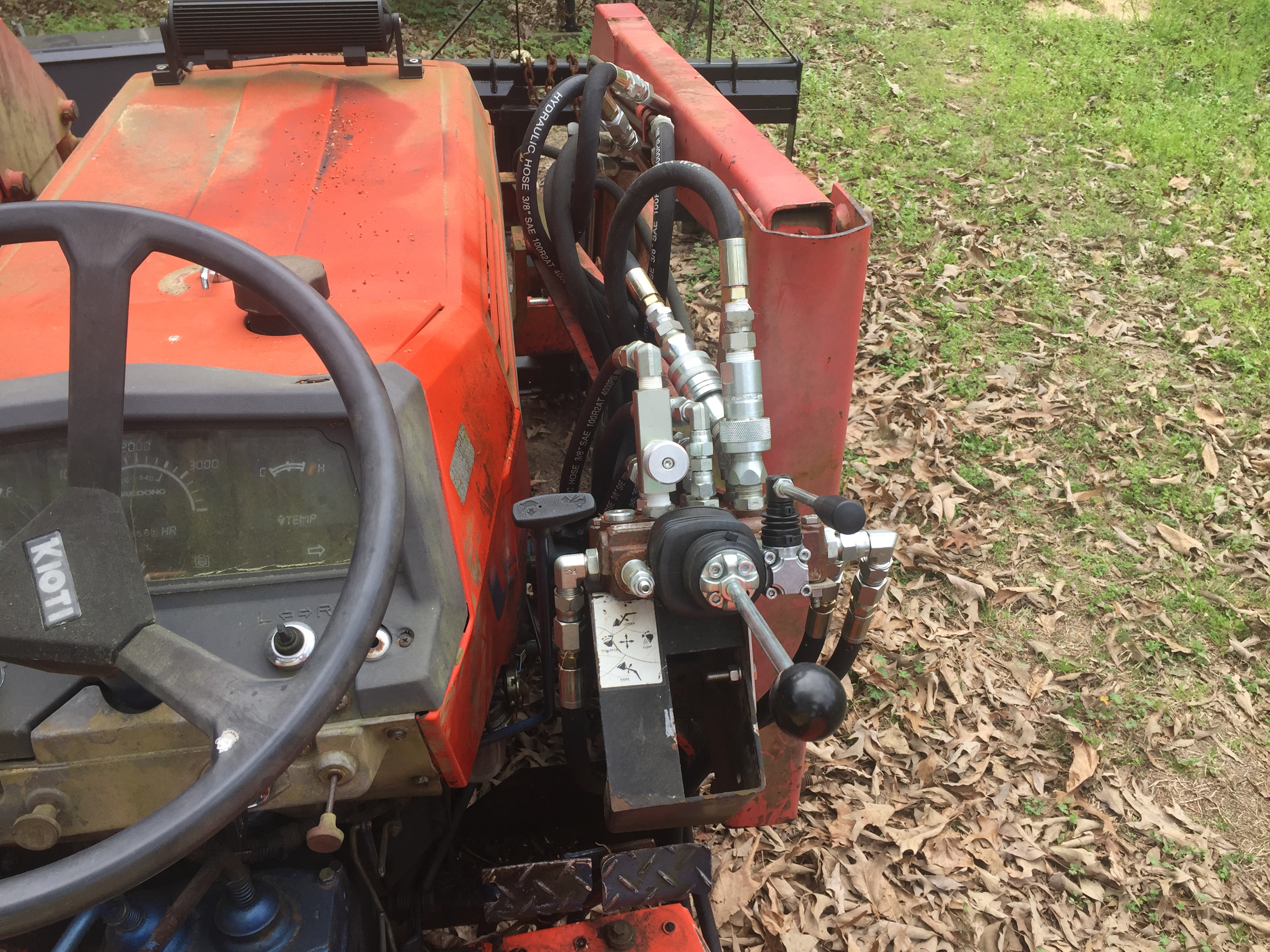

This is what I did.
It is a flow control valve installed on the return line when lowering. It only meters in one direction of flow so raising is still at normal speeds. With this, I can adjust up or down to match the task at hand and it is easy to reach. Works very well.

I can see that being quite handy.
