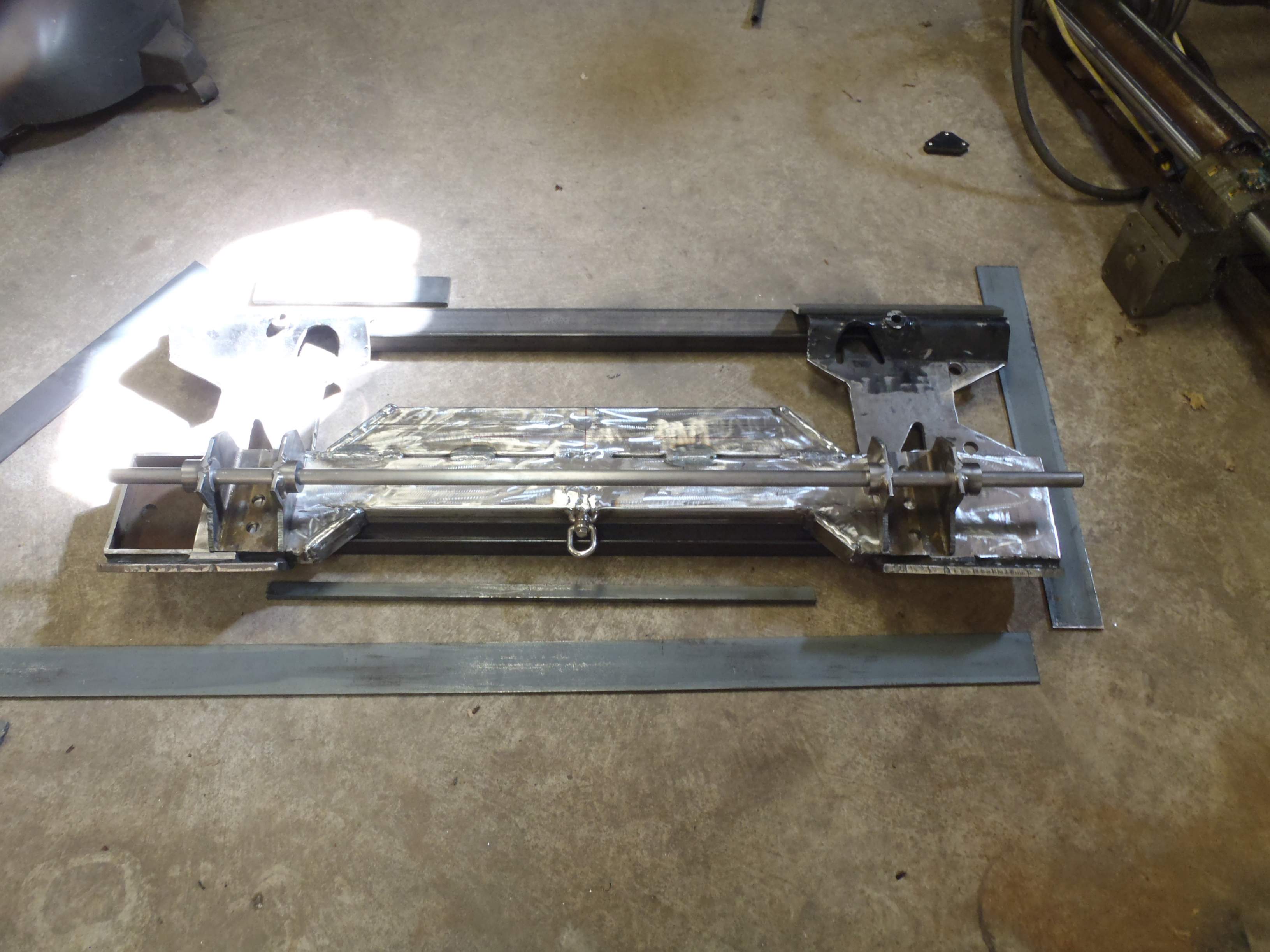

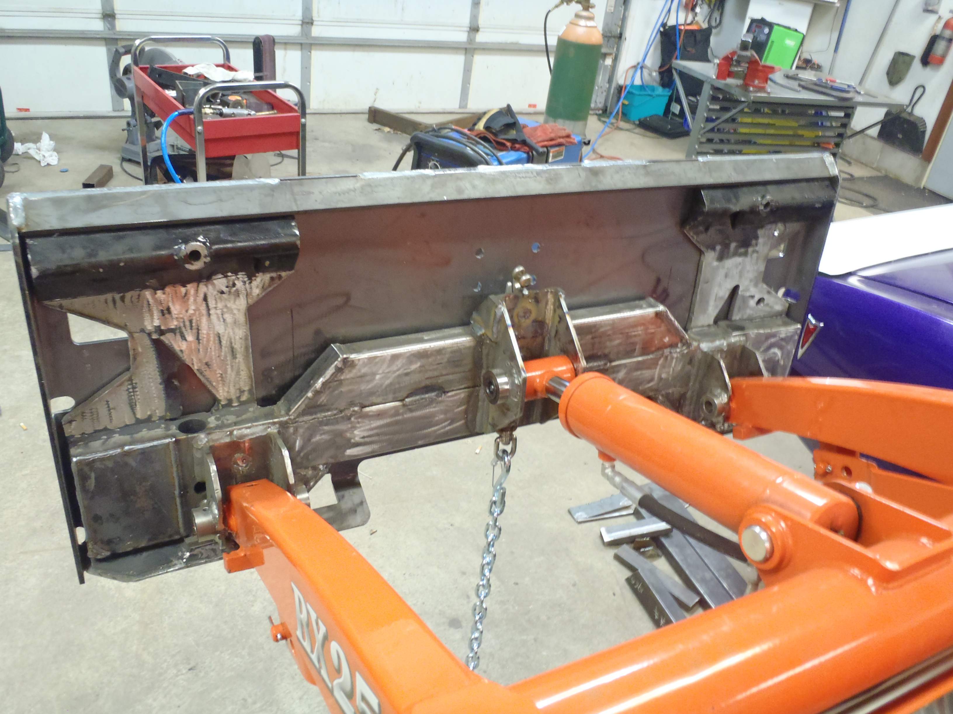

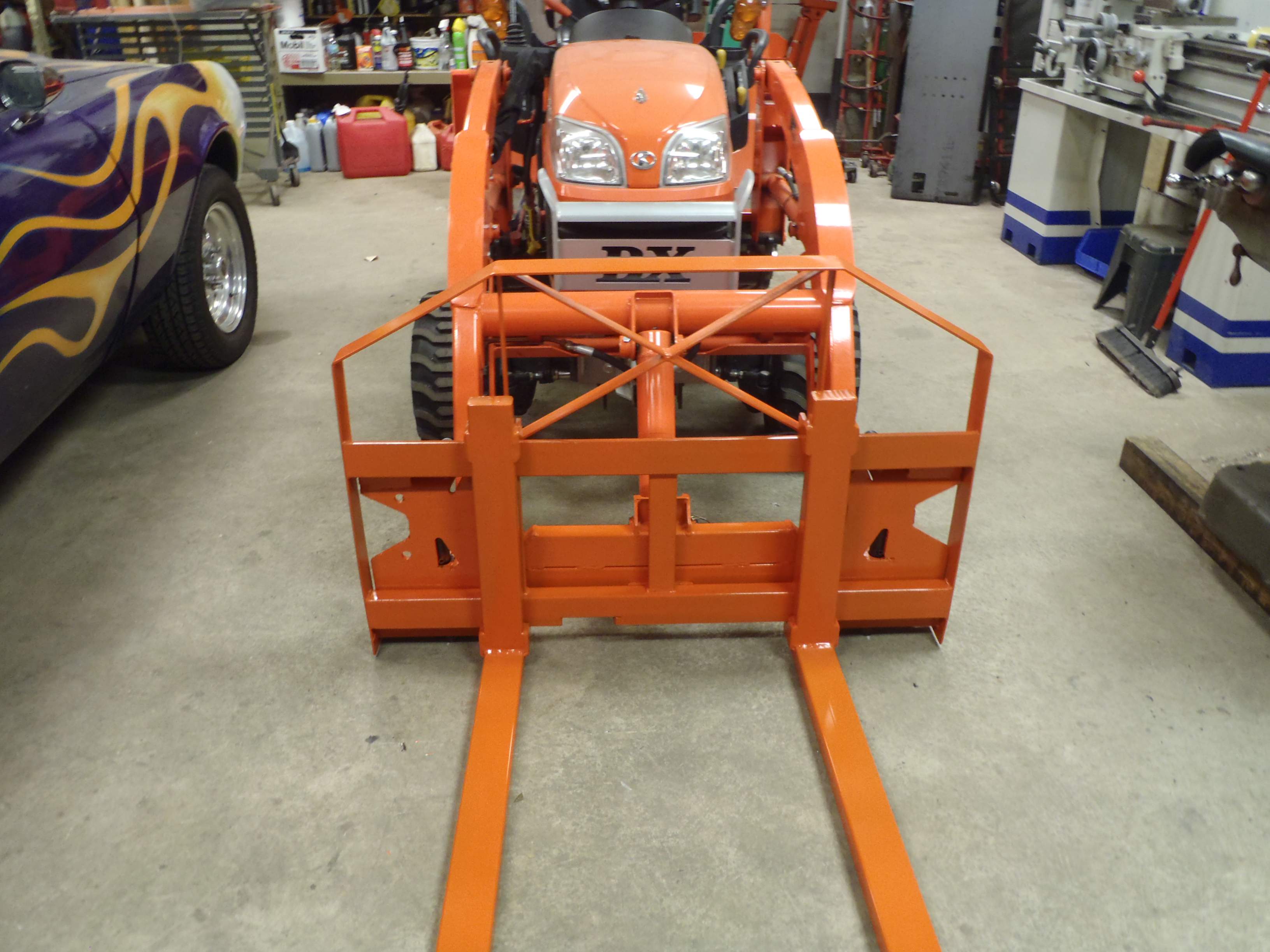

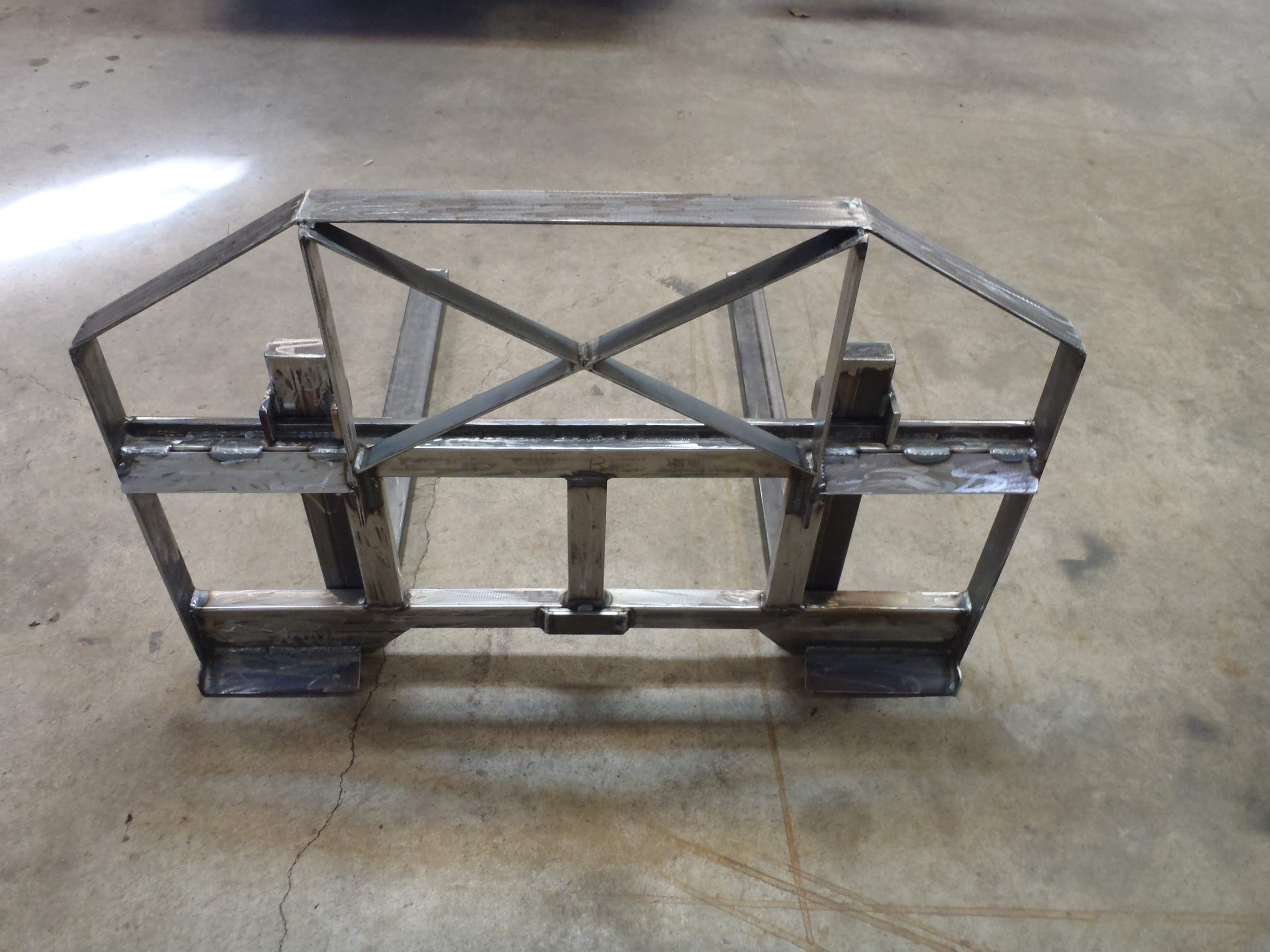

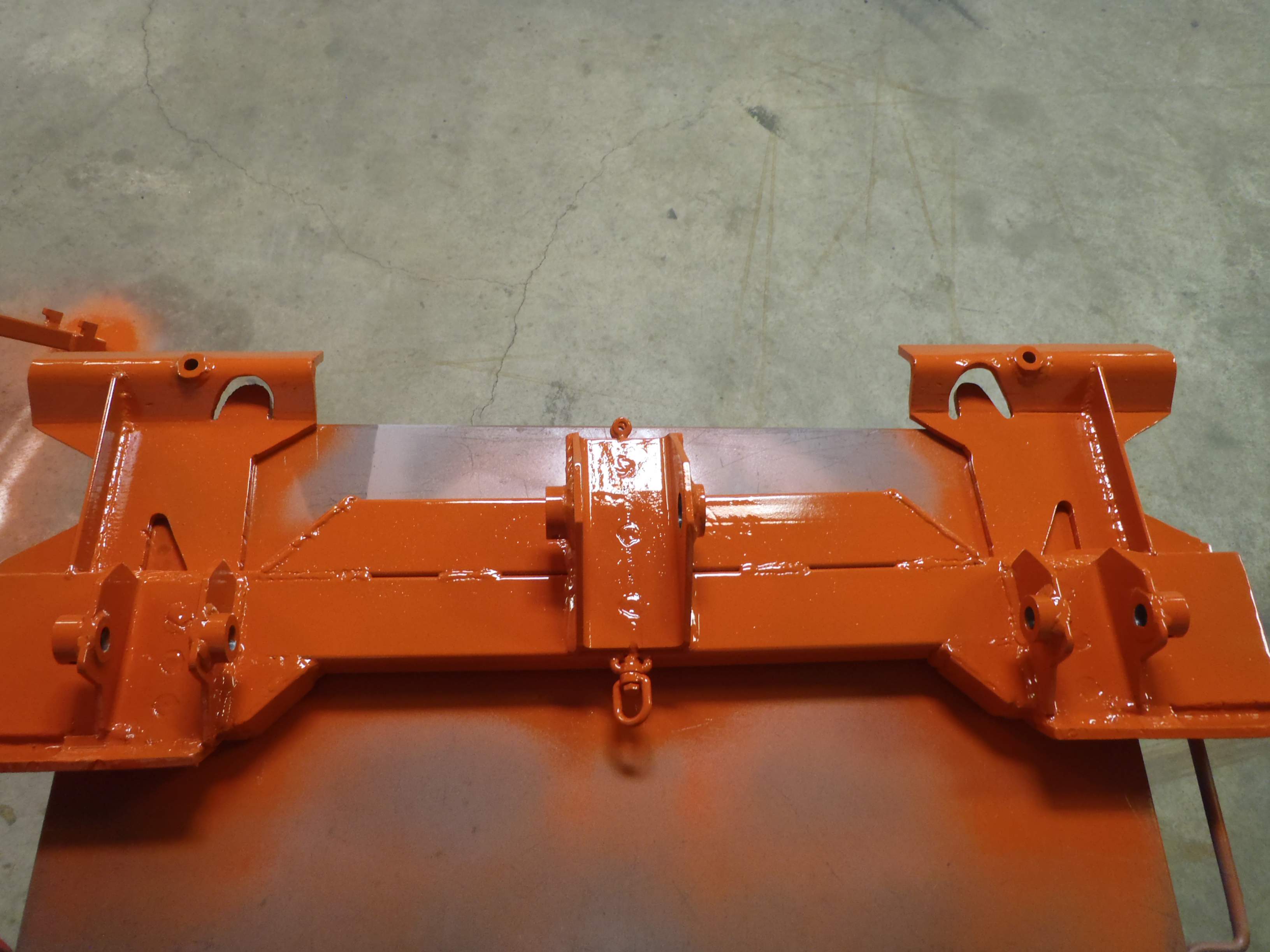

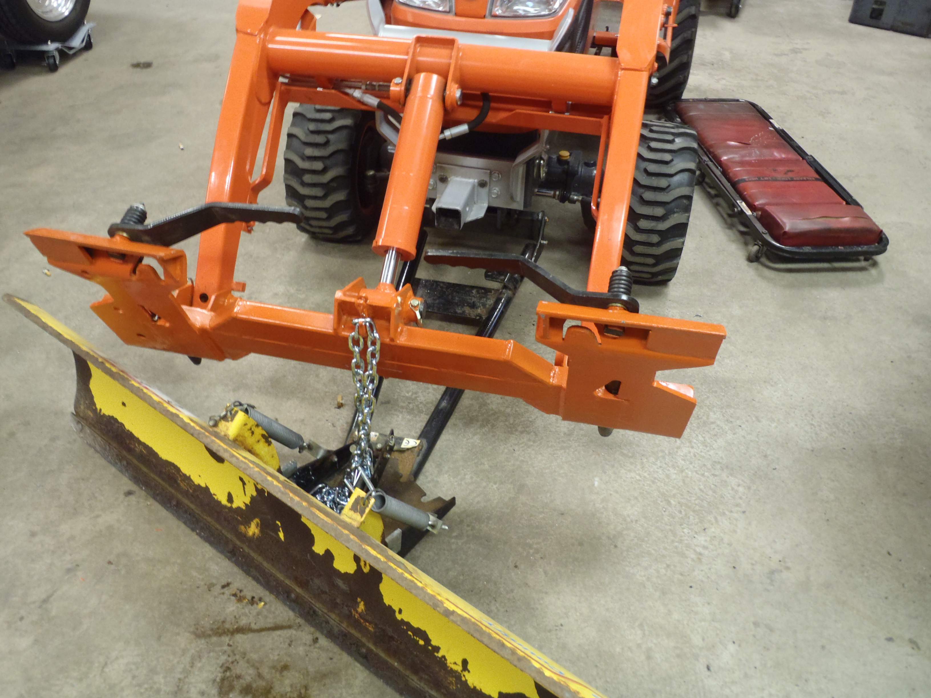

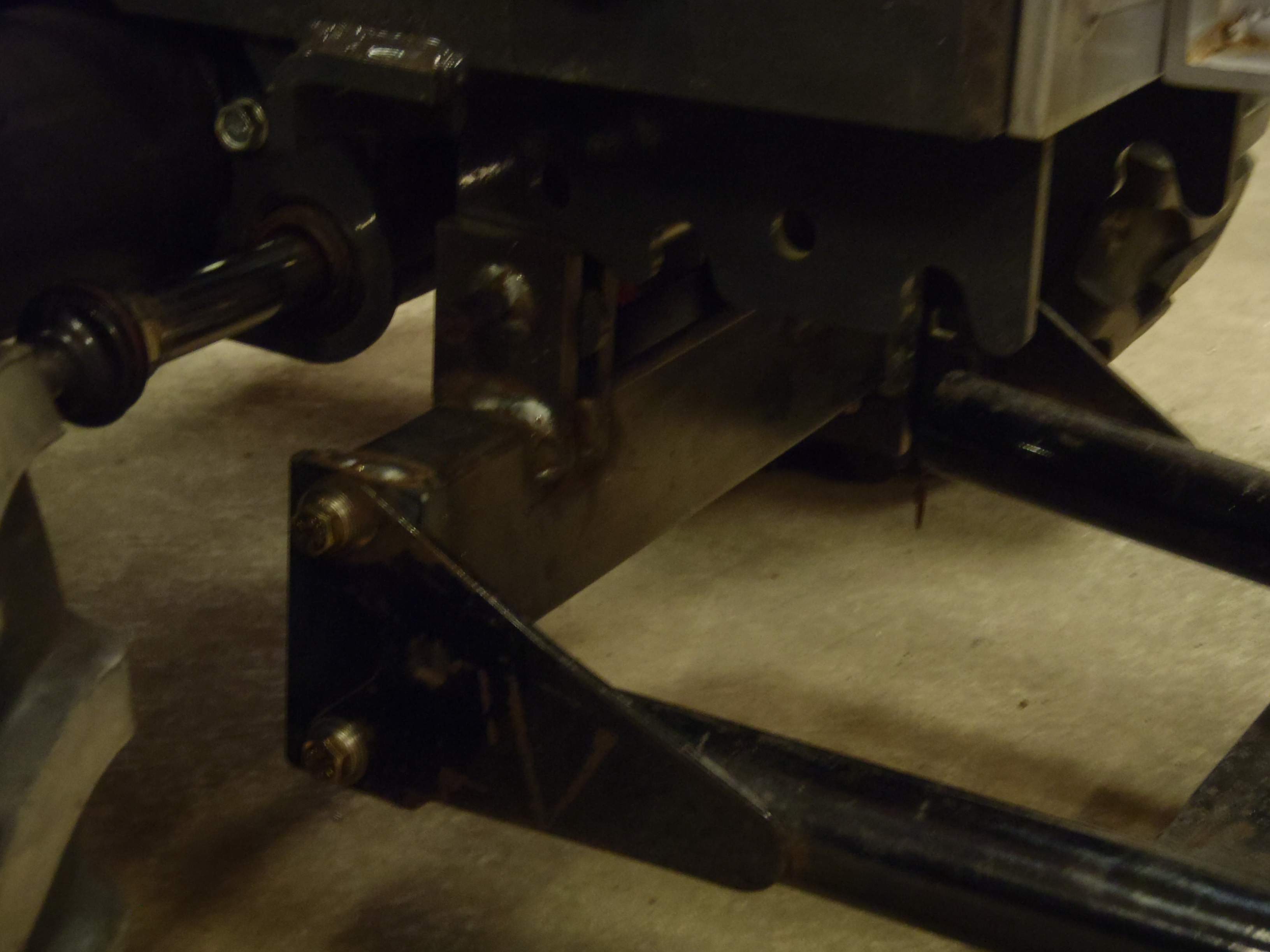

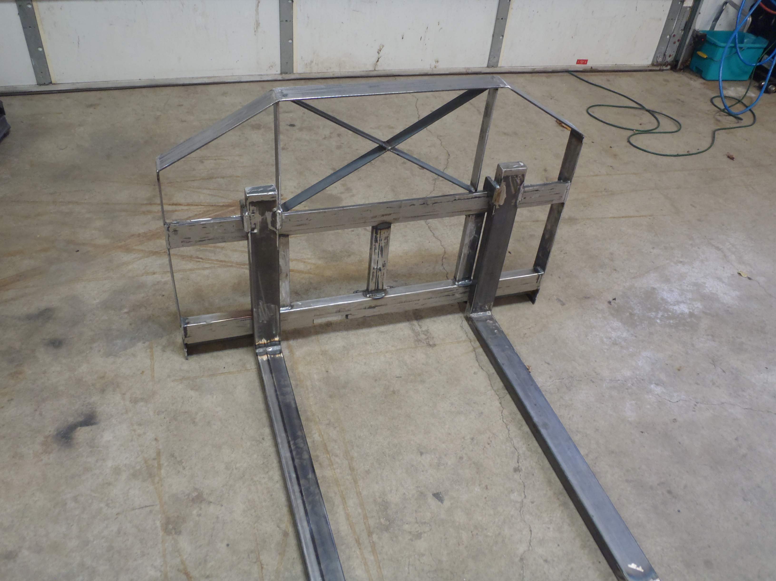

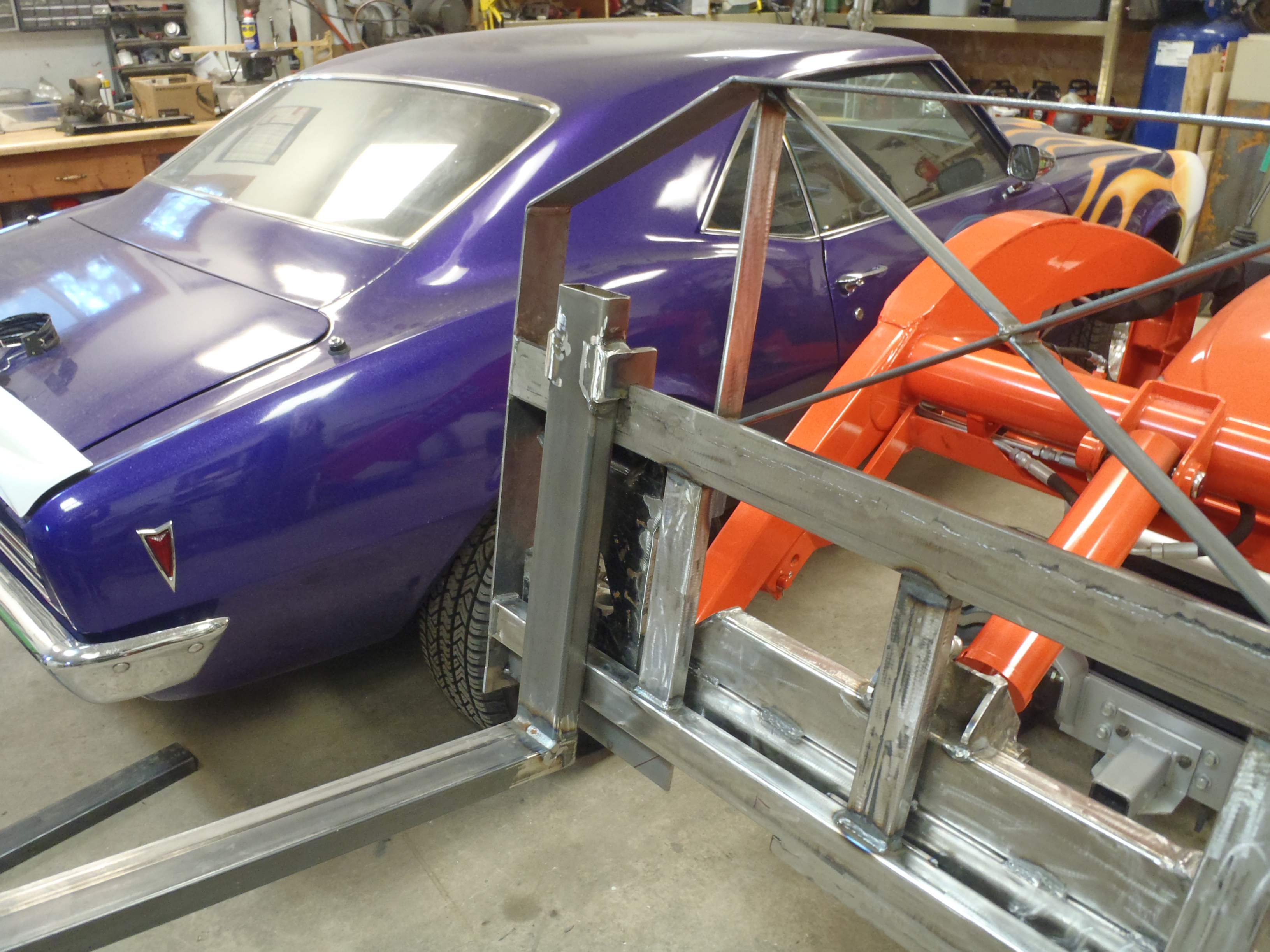

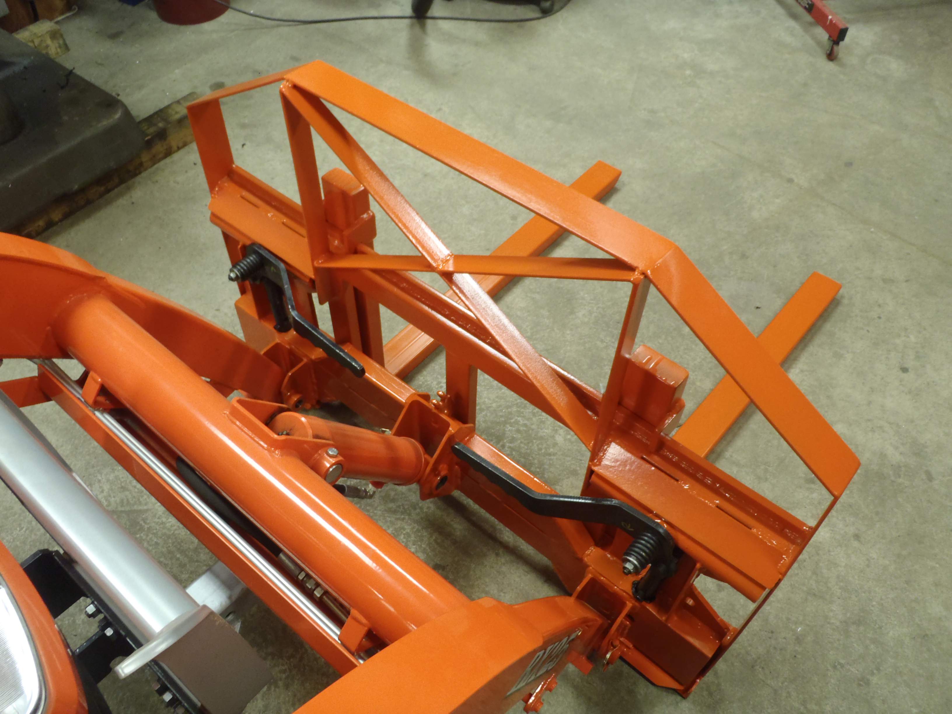

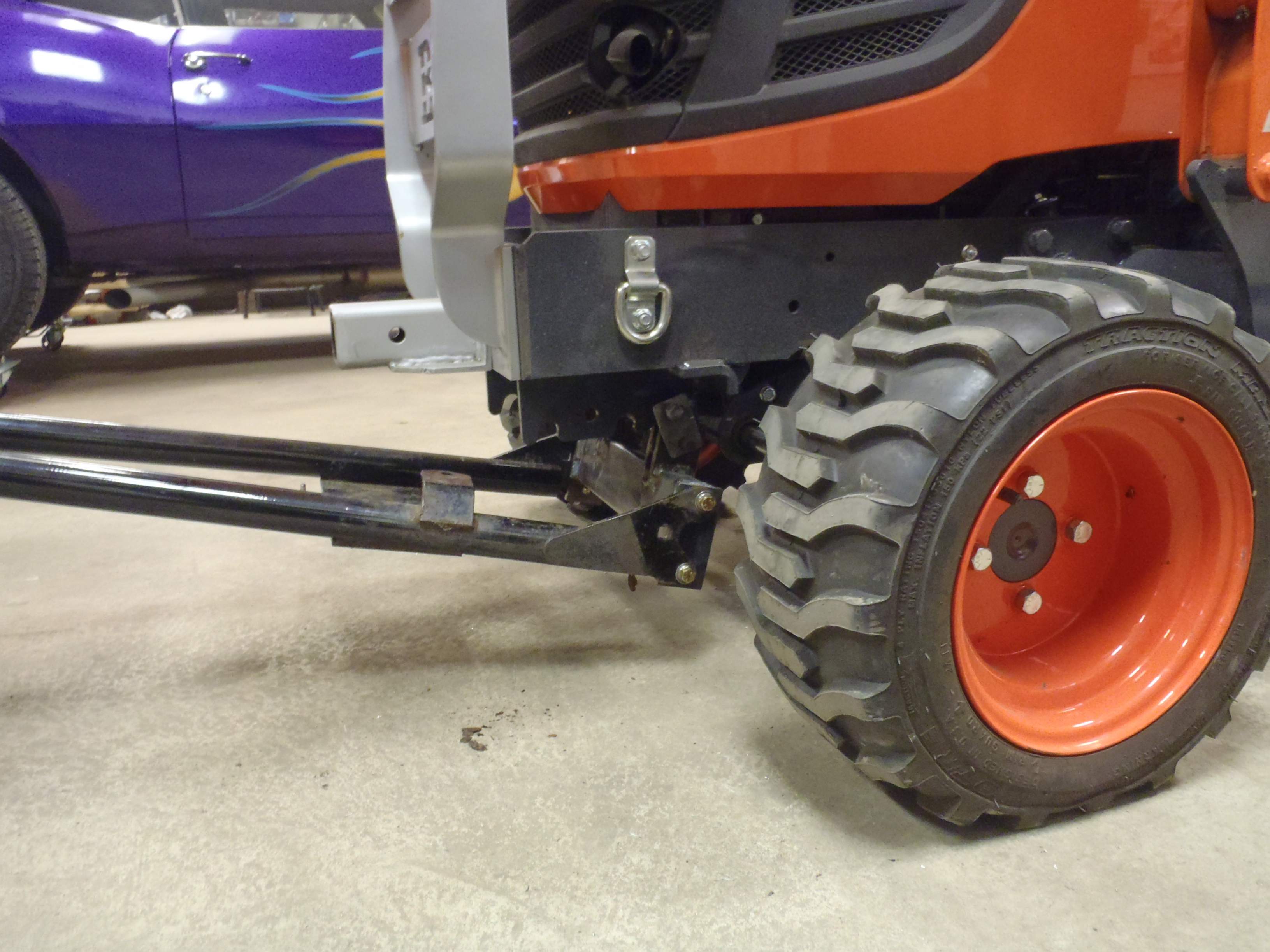

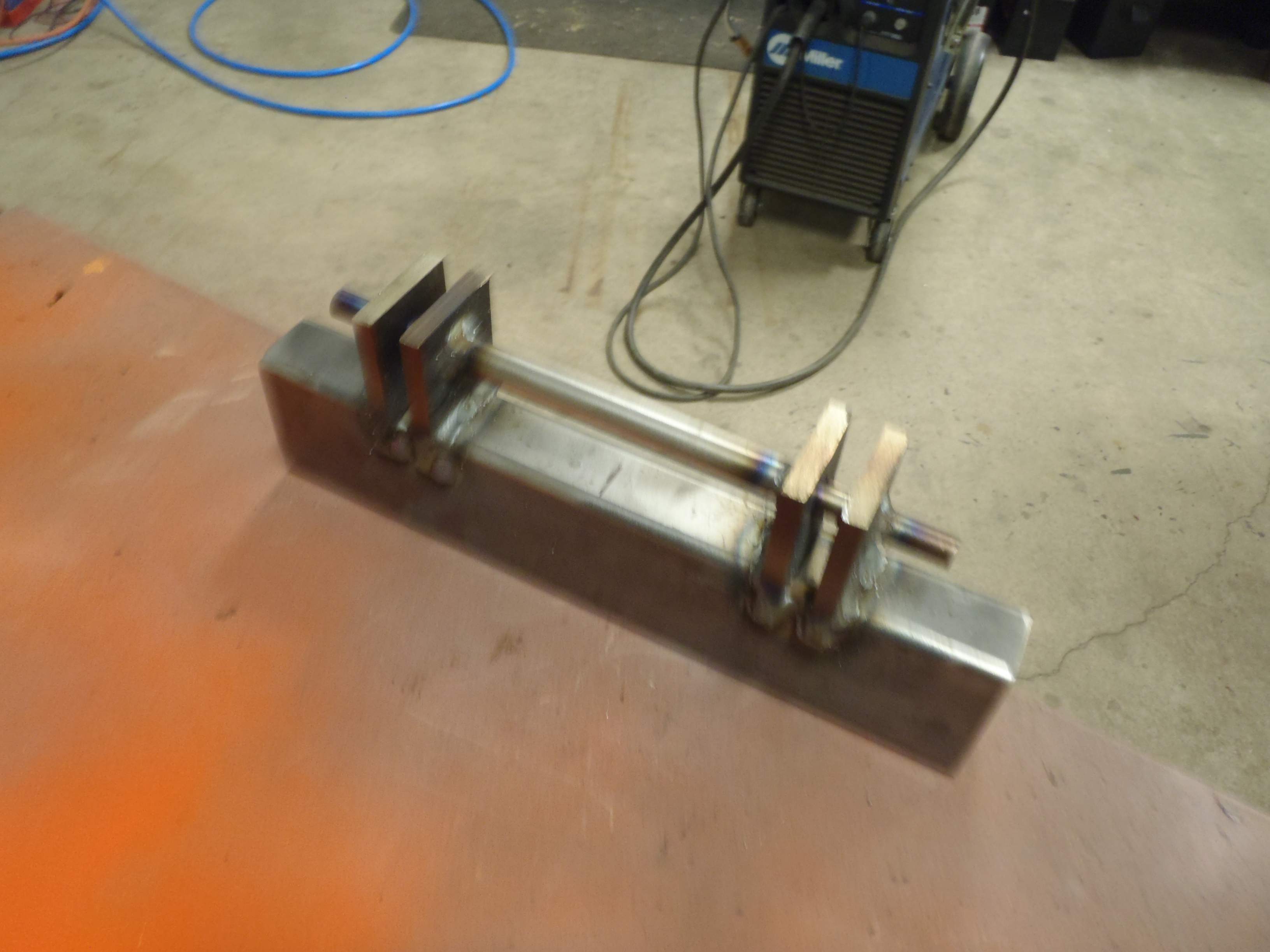

Here's my version of QA forks. They work great. So far the only complaint of the tractor is its loader height. It will barely get over my 1ton box with the bucket. With the QA and forks on it weighs 6lbs. more than bucket assy. Forks are flippable too. Also made a mount for an atv plow just in case the blower goes down. Maybe later will add hyd. swing. MISC. TRACTOR 068.jpgMISC. TRACTOR 060.jpgMISC. TRACTOR 006.jpgMISC. TRACTOR 074.jpgMISC. TRACTOR 069.jpgMISC. TRACTOR 033.jpgMISC. TRACTOR 001.jpgMISC. TRACTOR 003.jpgMISC. TRACTOR 007.jpgMISC. TRACTOR 009.jpgMISC. TRACTOR 011.jpgMISC. TRACTOR 017.jpg
/ QAforks for my BX25 #2
I like the forks! How about some details? Materials used, sizes etc. I need to build a lightweight set of forks,and these look like just the thing, modified a bit to fit my QA.
