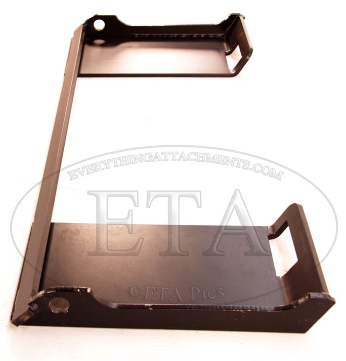

/ QA Loader roll back angle adapter?? #23
Basicaaly Im imagining the lower bracket with two slots .one would be standard and the other would be further out. So I could choose which one. But then the pressure would be on the pins and not on the face.(not good)
Can't do this because of the the way the bucket fits onto the quick attach at the top.

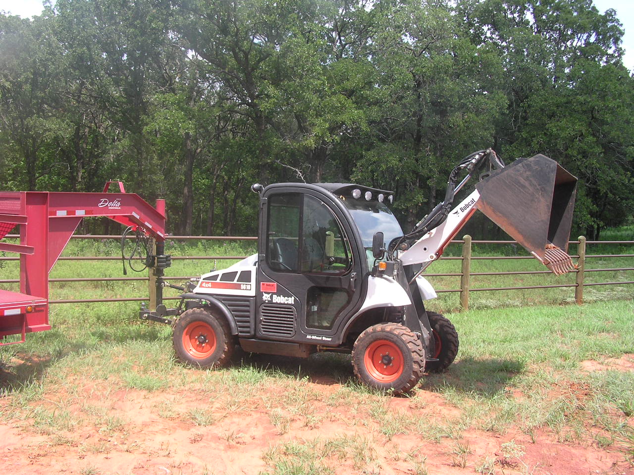

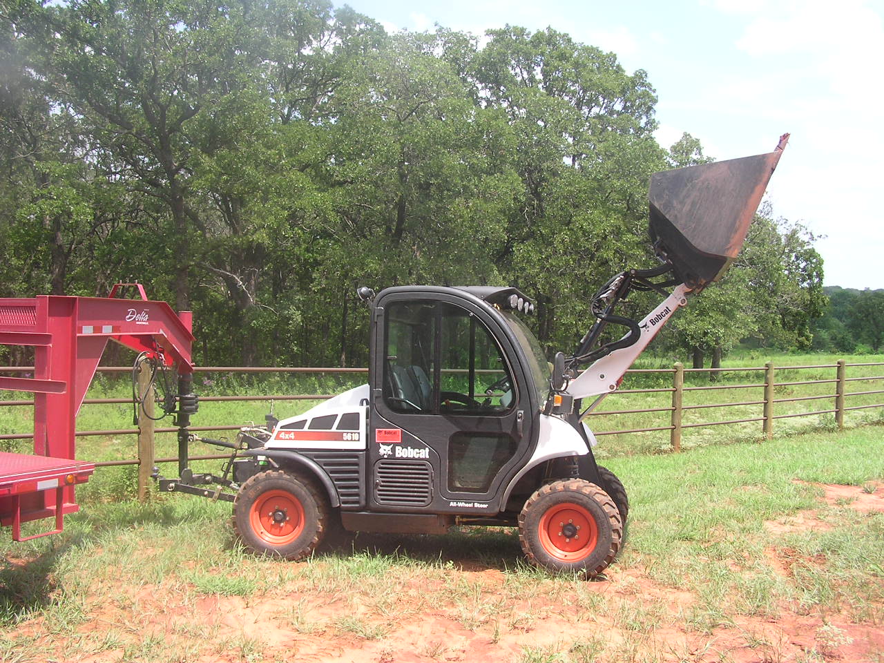

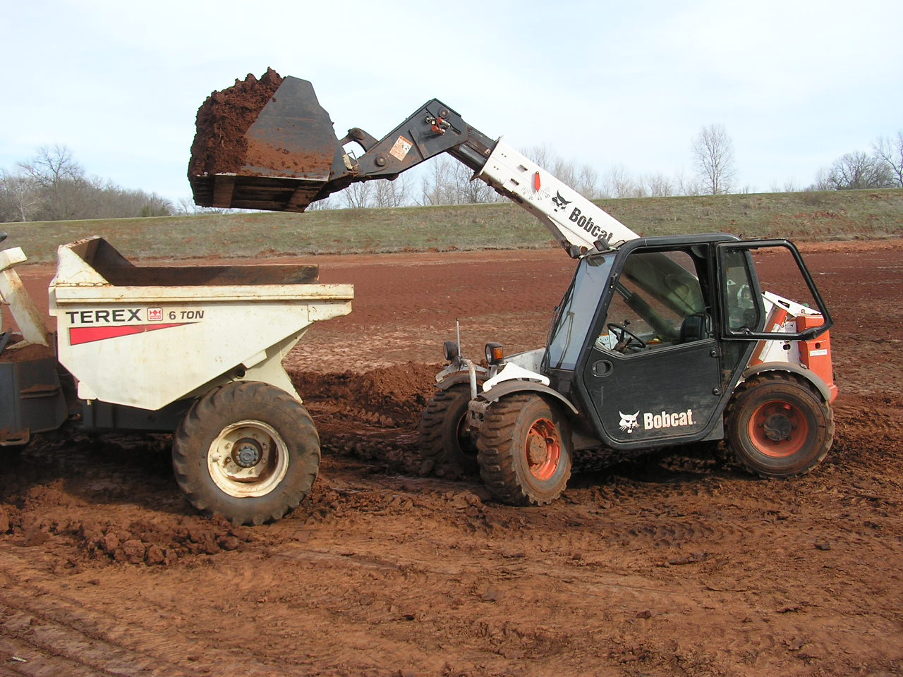

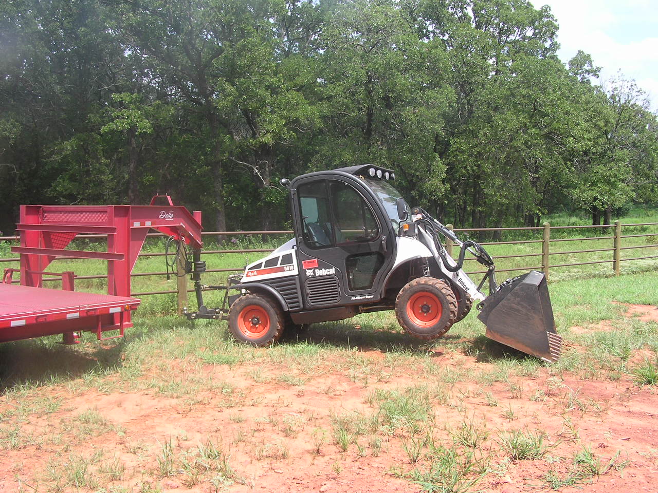

/ QA Loader roll back angle adapter?? #24

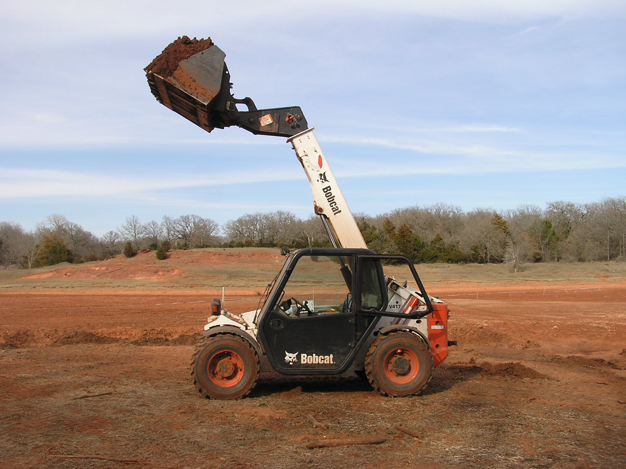

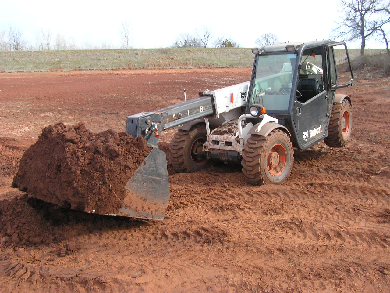

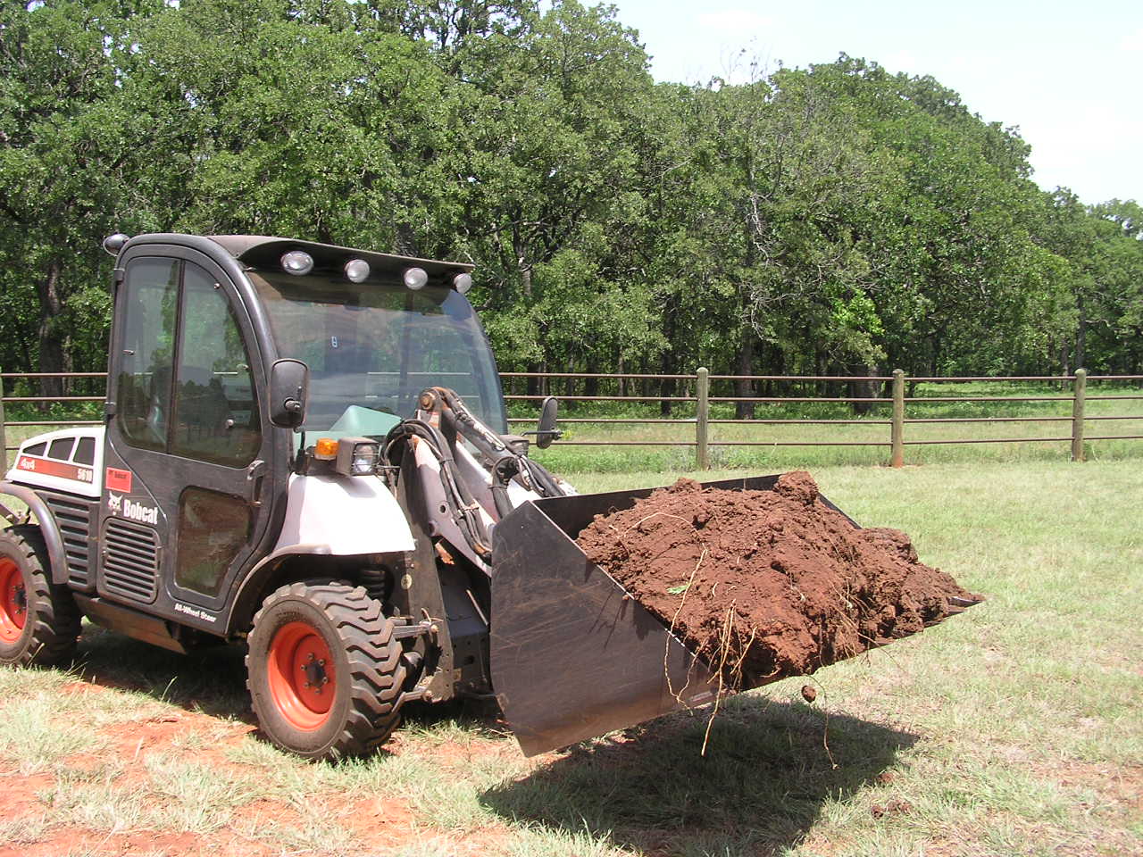

Did someone say pictures? :D
The Toolcat has an adequate rollback angle on the 6' one cubic yard Versahandler bucket.
The same bucket on the Versahandler.
