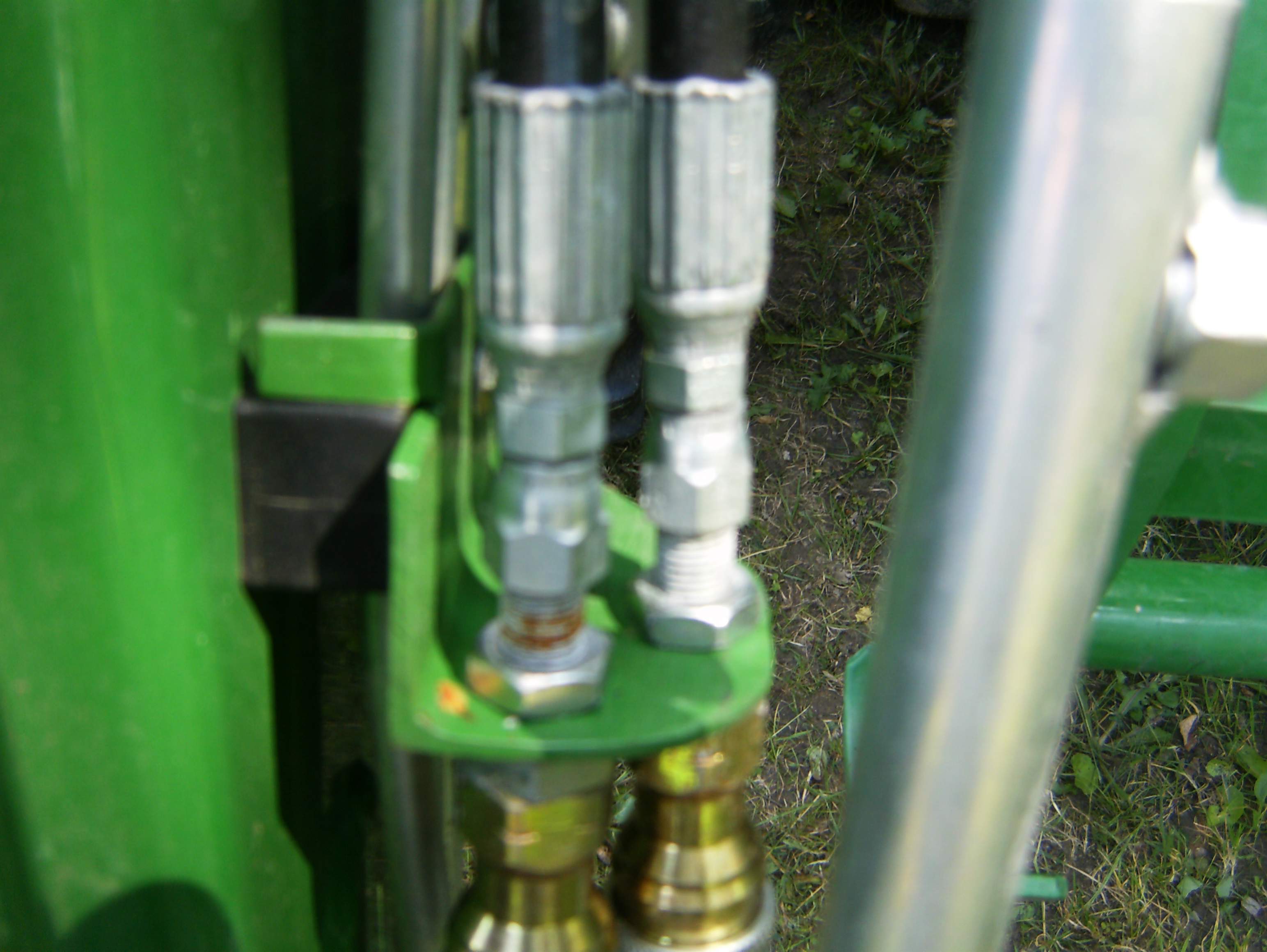

Any idea where I can pickup a coupler mount. This mount would be on my front boom. I found a picture of one on another thread and included it, but this was fabricated by himself. Any direction where to buy one of these online?

That is mine!
What you need, and I did not know about when I built that was Bulkhead Couplings. You just need to find the right one that matches your hose and QD thread configuration.

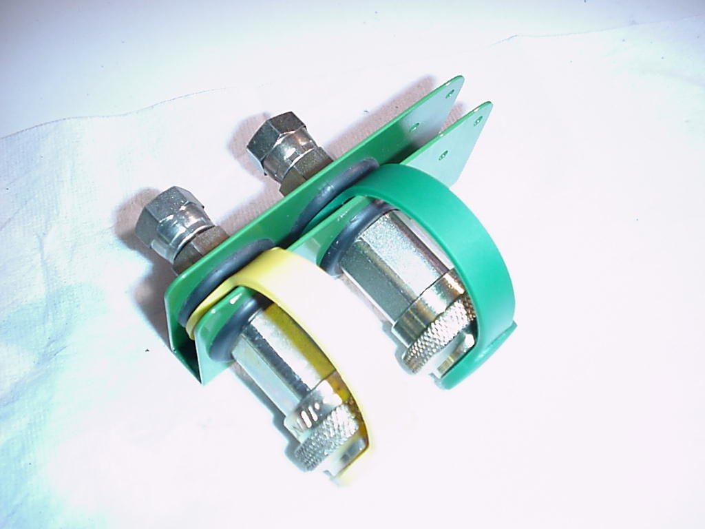

I'd be happy to help! Built mine to fit the 'line-keepers' on my JD, and used the same mounting bolts!
Only thing is my tractor is fifty miles away, so I'd need a good drawing! ~Scotty

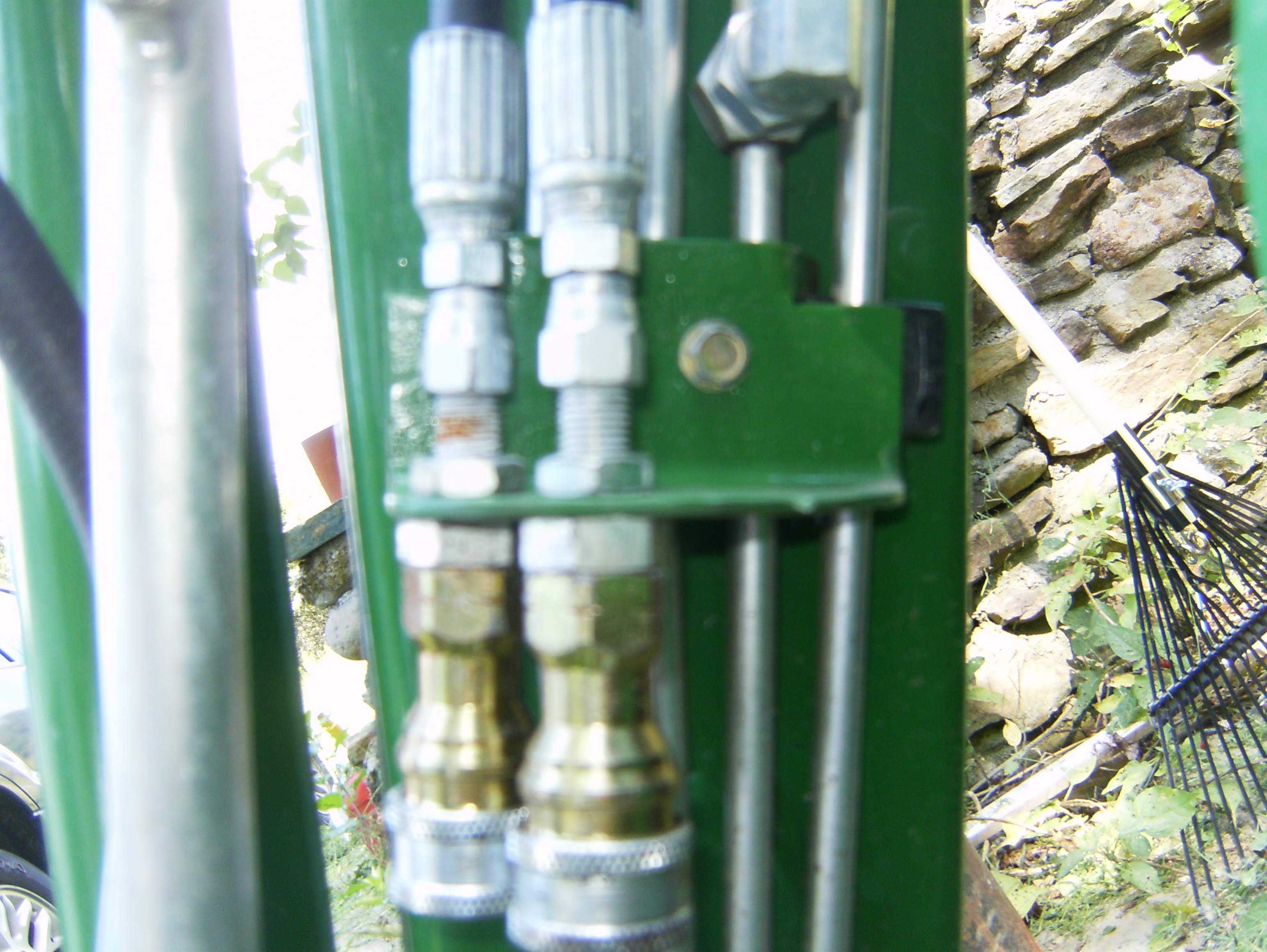

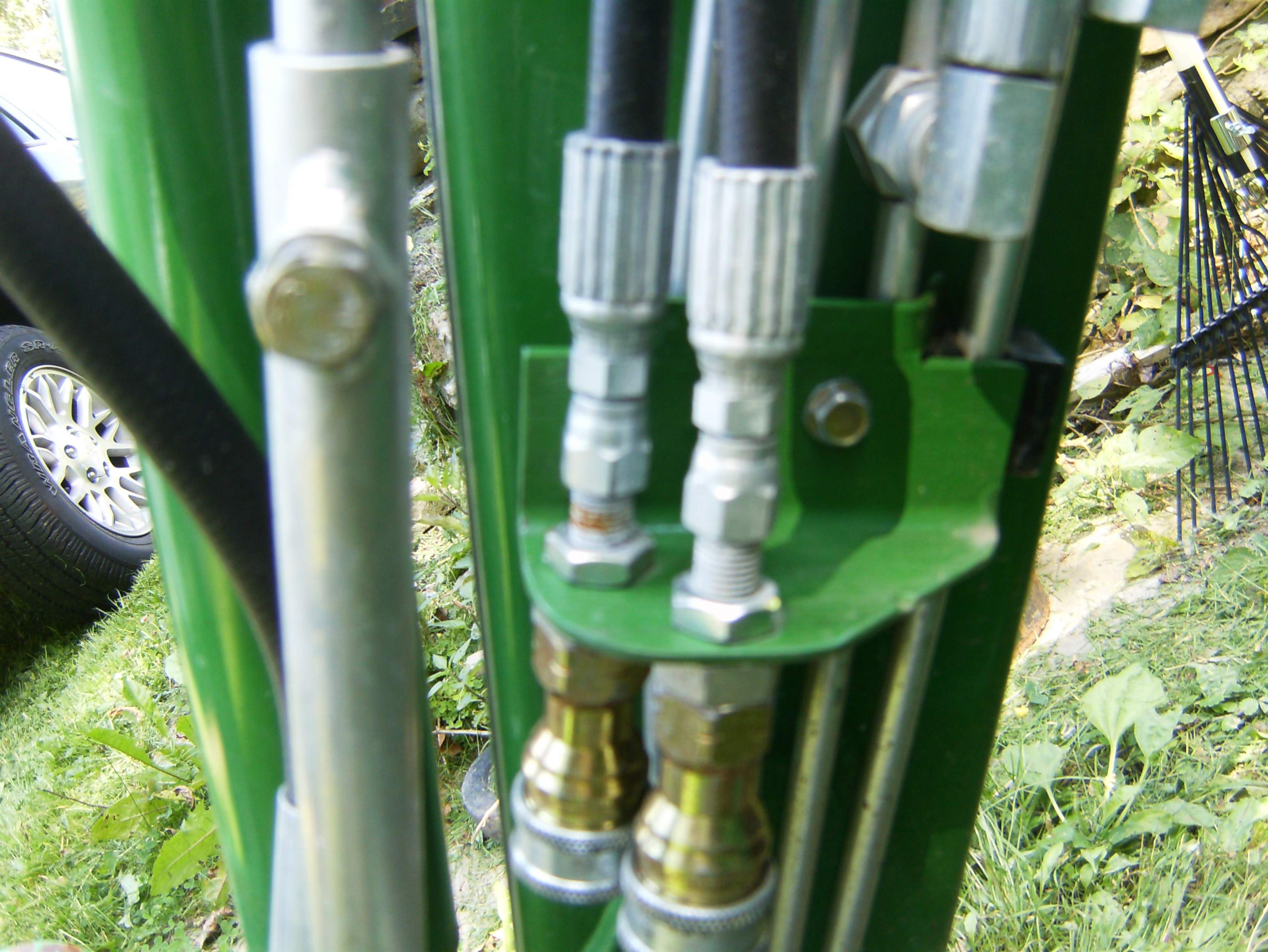

Thats the only pic I got! I'll try to remember to get some this weekend. I basically took a piece of 2"x2" 1/8" angle, 4"-5" long and 'massaged' it into a mount. Two QD holes on the one surface, and a mounting hole on the other. I then cut a couple slots with a hack saw, and bent the "ears" down so it wouldn't rotate.Then ground the corners round, some paint, and 'finni'! I did have to buy some 'Bulk-Head' fittings, that have jam nuts to mount through to the holes, then just QD's on one side, hoses on the other.~S

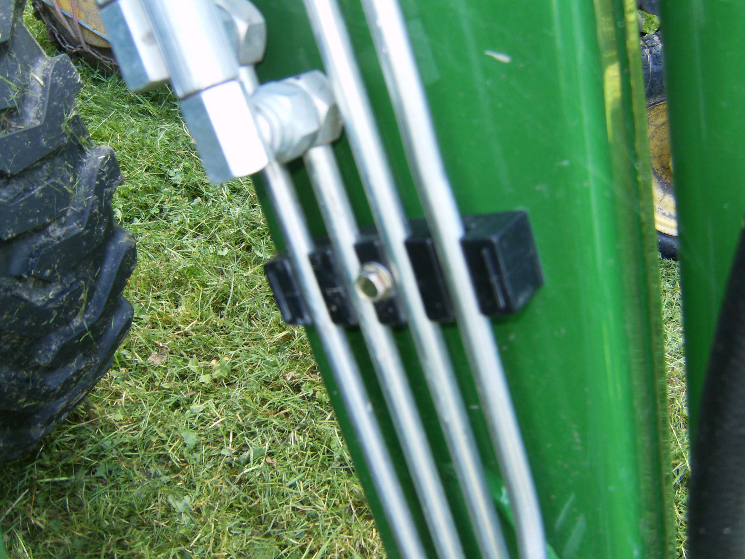

Spud- Here's those other pics. The last one is the left loader arm that shows the line holder. The right side was the same, before I covered it up with the QD holder.
Edit- Sorry Guys, new computer, and I gotta get this 'resizing' figured out! ~S
