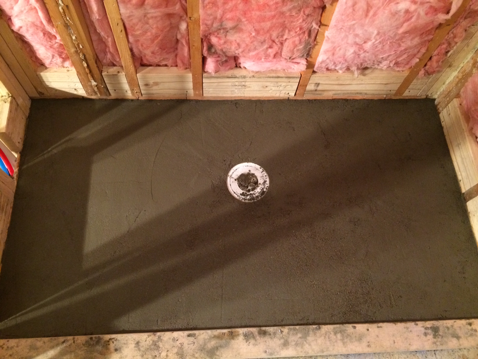

The first thing you do is put down tar paper on the sub floor and cut it out around the drain. Then you scrip a line around the perimeter of the floor at a height equal to 1/4 inch slope per foot. My drain sat 1/4 inch above the floor. My shower is 2 1/2 feet from the center of the drain to one wall. So a 1/4 inch per foot over 2 1/2 feet is about 5/8 of an inch. I rounded it to 3/4 of an inch. Because my drain sat 1/4 inch above the floor you add that to the 3/4 inch and scribe a line around the perimeter at 1 inch above the floor.
Then you put down your masonry pre-pan. Building it to your 1 inch mark at the outside and sloping to the 1/4 inch high drain.
The idea of the pre pan is to provide that 1/4 inch slope to the drain. A liner sits on top of the pre-pan and then you do a masonry floor on top of the liner. The liner doesn't get bonded. You can't learn what you need to from this forum. I would highly recommend watching a bunch of youtube videos on the subject.
This is what I did (pre-pan) last night.
I'll scrape it with my trowel this morning and smooth it out a lot more. That will remove any ridges. I was pretty tapped last night when I finished it.

Hi Bobcat,
I do a lot of custom PVC systems and use the Schluter systems also.
It looks like you have done a great pre-slope job.
Is that a clamping type shower drain (to clamp the shower liner)? If you are all set with the clamping drain, liner and ready for the mortar bed.
If your drain has weep holes, be sure to use some fine aggragate around the holes so the do not plug up with the mortar.
That will allow water to go into the drain if it were to get through the tile and mortar to the liner.

Hi HH,
Thanks! Yes it is a clamping style. I saw in youtube videos where they either put down some small pebbles by the weep holes or they use a plastic cover that goes around the drain and then they mortar over that. The cover has ridges that allows the water to flow under it. I was planning on using the pebbles.

We never have used adhesive to adhere the liner to the pre-slope. Just make sure it is laying flat and the corners and folds are sharp.
We do use 14Ga. Galv. 1/2x1/2 hardware mesh, some call it hardware cloth in the mortar bed. It won't keep it from cracking, if it does crack it will keep it from shifting.

I had an oatey brand drain that I ripped out. I didn't like the design because it sat flush to the floor and was actually recessed a bit into the floor. I purchased a new drain that had a clamping surface a 1/4" above the floor. That meant I could have a 1/4" of mortar depth around the perimeter of the drain.
I didn't put any metal in the pre-pan mortar. I did put down another layer of 1/2" osb on the floor (just in the shower) before doing the pre-pan. That gave me 1 3/4" of sub floor which should be plenty rigid. I didn't bother with durarock on the floor as it all gets covered with mortar anyway.
I won't use any adhesive on the liner. But I will put some slicone under the liner at the drain before clamping it down.
