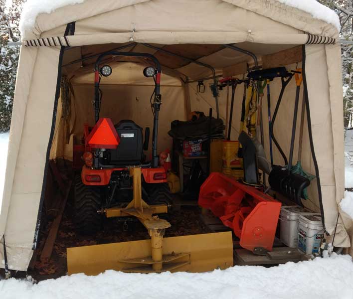

I have the older peak roof design one... the peak isn't enough slope to shed snow... what I ended up doing was getting a frame from a 2nd unit and doubling up on the trusses, which cut the spans in half. I try to get the snow off every 2-3 weeks but its located at an out of town property im guessing its been up for 8 or 9 years now but the fabric is ripe as **** now... new one come summer I guess the trusses will be in 3rd spans now with the new set as well as the old :p
I added some 2 ft wide plywood to support the cover. From inside I can shake the cover above and below the plywood and get the snow to slide off.
