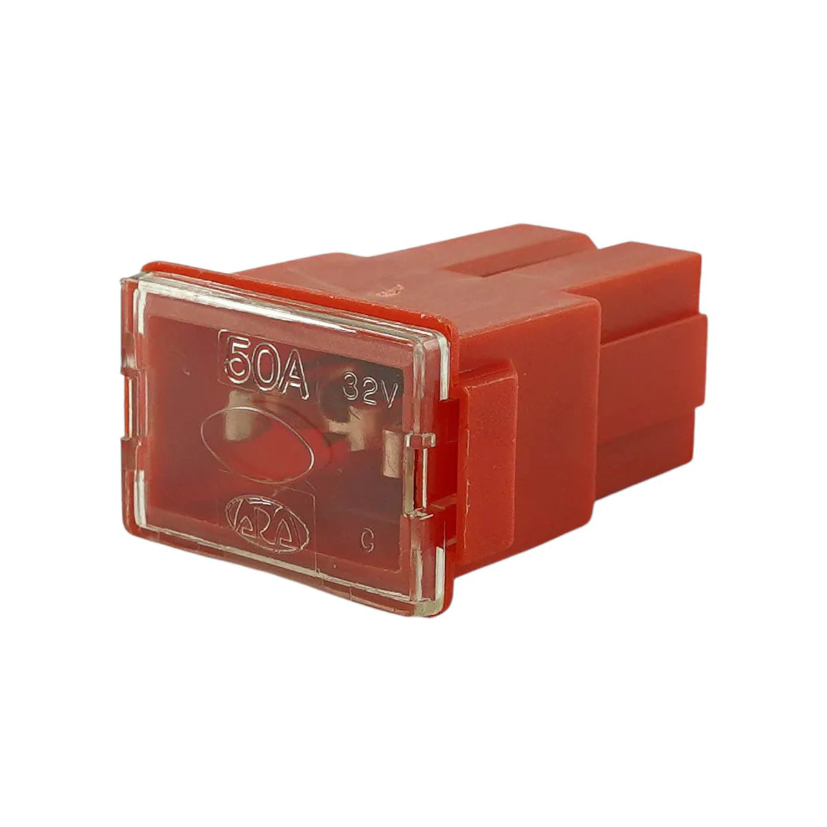

That main fuse probably looks something like this. You can use your new multi-meter to test it. Testing for ohms or resistance -- if it has a setting for continuity that looks like ->+))))) you can touch your leads together and should hear a tone. That indicates a complete circuit -- there is "continuity" from one termal to the other. Remove the fuse and check across the two terminals -- if there is a tone, it's good. If not, it's blown and you've found the problem.

Yes some look like that, but other times they virtually hide a round fuse in shrink tube or electrical tape the wire harness on purpose!
Had a Toro generator bad battery replaced the battery, still no start, so look at the wiring diagram theres a fuse somewhere before the starter. Well, after taking the front cover off, not there, then trace the wire harness - lo and behold a little 1/2" long glass tube fuse was tucked in a connector and wrapped with tape as part of the wiring harness.
Very hard to find these little buggers, but once replaced the battery worked fine.
