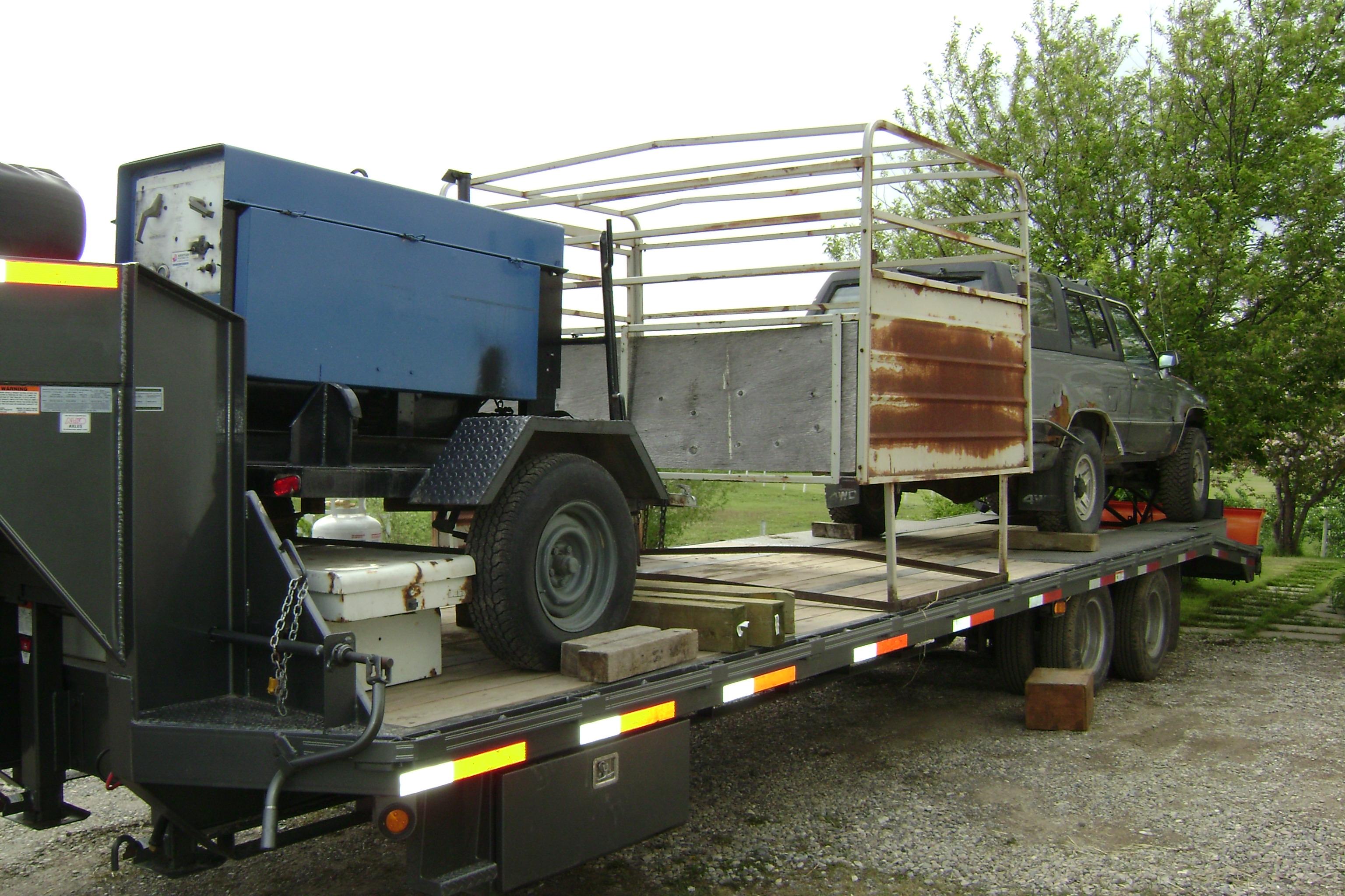

well the horse trailer on the flatdeck is out, it looks like id need a 20' gradual approch as the H. trailer is so low.
But I did manage to back the welder trailer on today, went up a little easier then I expected. Off on another run to the farm this weekend.
Wish me luck last trip there was no water in the house, I suspect the foot valve as the pump wont hold prime.

Can you back your flat bed into a shallow ditch to lower it? You would only need some short planks for ramps. You might have to look around in your neighbourhood for a suitable site but loading like that is much easier and safer.
If you load stuff like this a lot then why not dig a depression somewhere on your property specifically for doing this? Kind of like the inverse of a ramp.

I made up a "ski" that fit the bottom of the tonque jack, then pulled trailers around just by winching on the tonque. The horse trailer sits low when riding level but when the tonque is on the ground you should have lots of rear clearance. Just take it slow, a bit at a time and address each "tight" spot as you get to it. Rig a pulley at the front of your flatbed and run a cable to a winch/tractor/truck for motive power. If you use a nylon rope/strap you will reduce any shock loads BUT you will have an elastic band effect which could propel the load forwords when it crests a hump....

I used to operate a rollback wrecker and have used it to on and off load vehicles from semi trailers and straight box trucks.
I would just call one to load the trailer and then off load to your trailer then do the opposite at your destination. a competent operator should understand what your wanting to do and how. the HF trailer dolly would come in handy to keep from damaging the tung of the trailer while maneuvering. Just back the trailer up the rollback and then level out and transfer the trailer onto your trailer froward and tie down. reverse to off load. Think of it as a portable for rent loading dock. YMMV Sean
