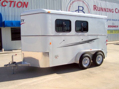

What might a trailer like hers weigh, Im guessing its tandem 3500#'s
Not as new and shiny, but it looks about like this (below)

Guess i should post the pic....

If its a 7K trailer it will weigh about 2,500# or less in 99% of all cases. Most 7K trailers, horse trailers are aluminum and have around 5,500# load capacity so that puts the empty weight closer to 5,000#. Yes they are currently $49 at HF. I bought one about a year ago.
