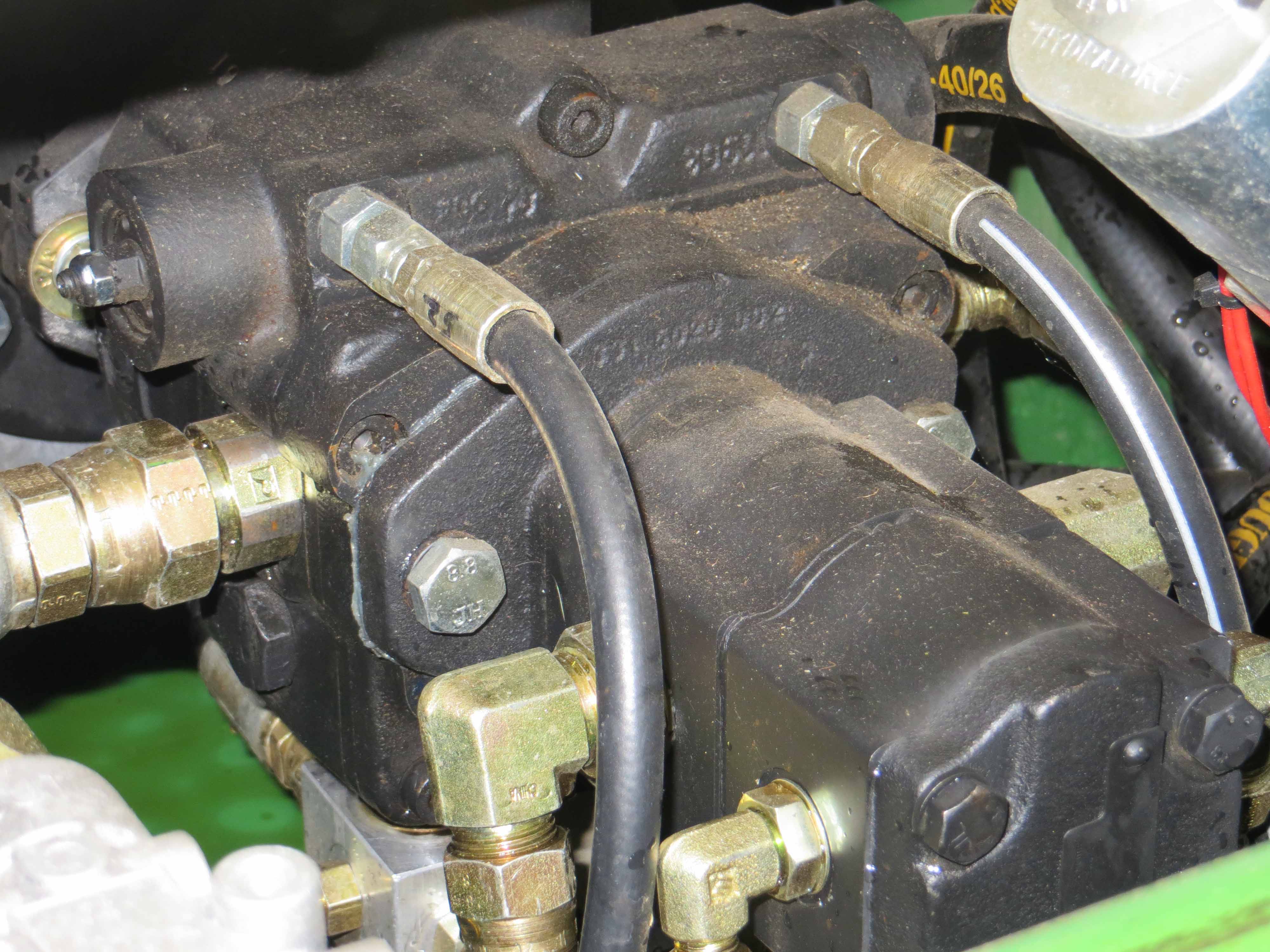

OK, I arrived home from a nice Father's day out and I noticed a gasoline smell in the garage. ... saw a few drops under the tractor ... thought that I'd simply pull it outside and deal with it. I could not start it and eventually the battery went dead ... tried to jump it from a mower ... no luck ... so, I pulled out the manual to see what valve had to be opened in the tram pump to allow it to be pushed and found that the image in the manual is not at all like the pump on my unit. ... in fact there is nothing on my pump that even resembles the "Tow Valve" shown in the manual. ... so for you guys that have a 6-year old 425 with a Robins engine ... anyone know what to turn to make this thing "pushable" or "towable" ?

Here's an image of my pump. (Not sure that I uploaded this correctly. This new and improved forum format is testing my capabilities).
Does anyone know what to turn to be able to push or tow this tractor? Figured I'd call Terry in the morning if I can't get it worked out.

On my tractor, there is a JIC fitting with a cap on it. I do not see anything like that in your picture. A picture from the other side perhaps? Mine is on the "Driver's" side.

Mine is a 2010 PT 425. It has the same pump and configuration as yours. Move the PT only a short distance once the bypass connection is made.

Thanks for the reply. So, if I understand this correctly we want to install a bypass between each of the two fittings (item #7) located on each of the tram manifolds (item #4 on the drawing) ... it would seem to me that this could be a permanent installation if it had a small valve in the line to open or to close the bypass. If one could conveniently locate the valve it would make pushing or pulling the machine much more convenient. (of course only short distances).
The bypass hose that I received with my tractor only has a fitting on one end. The other end is just a cut off hose.

Really getting cheap in Tazwell with a fitting on only one end of the hose. :confused2: That hose is not only supposed to be for purging air, but the tow bypass as well... Good luck.

Hopefully, it is very rare that you would have to tow the tractor and not worth a permanent tow valve installation. Also, by short distance I should have said a few feet, for example, to move it onto a trailer for moving it.
By 2010 when I purchased my tractor, PT wised-up as my hose came with fittings on both ends.

My tow valve is really simple.
There is a slot under a cover plate that when turned 45 degrees, opens two relief valves and lets the fluid cross over from input to output. Only used for short distance and slow.
