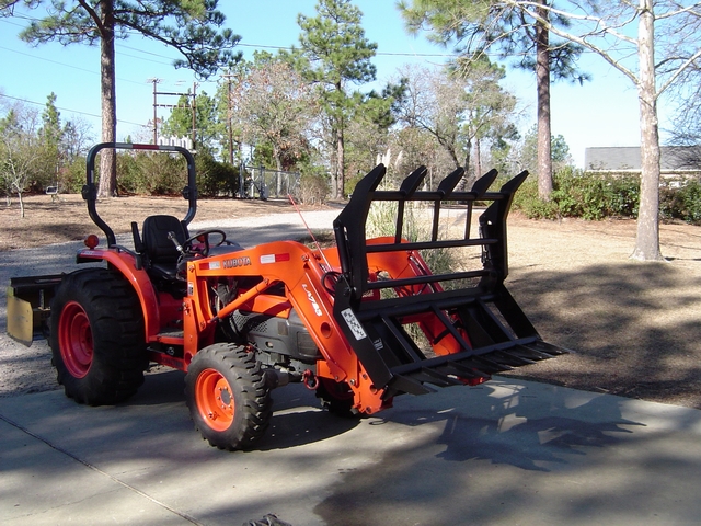

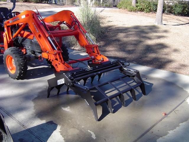

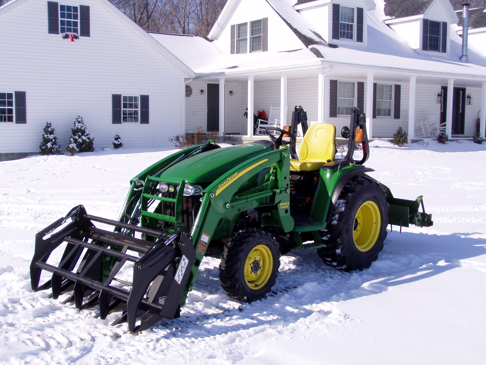

Some pictures of the WR LONG RBG2 60" model I picked up last weekend. The unit is very light at 365 lbs. I can't believe the difference in manuverablity & use from my 4 in 1 bucket.

Very nice - you have a great set up. Thanks for sharing the pics with us.

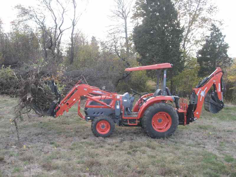

I also have a backhoe. I use the grapple to get any stumps/trees I can as it is much faster than using the backhoe. When I run up against a tree/stump I cannot handle with the grapple alone I use the backhoe to dig it out and then use the grapple to cart it away. The backhoe makes a dandy counterweight when carrying big stumps.

I looked at the last pics you posted. Pretty neat. That's a Woods BH I presume? What does it weigh? I am pondering...

I cannot remember. I'd guess something between 800-1000lbs. The BH90x is a pretty beefy unit.
