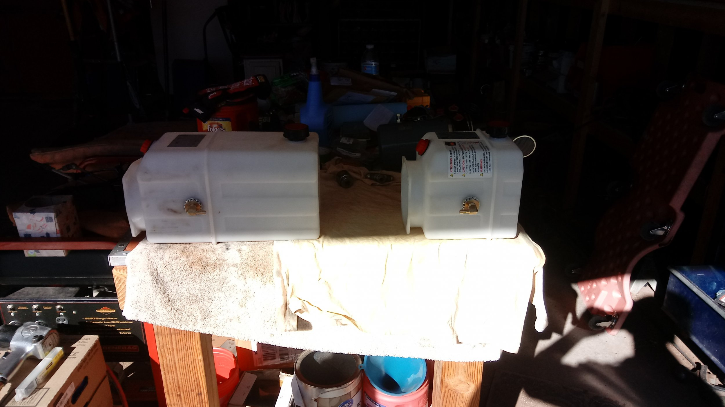

I posted this on another forum so I though I would share it here. As all you owner operators of dump trailers are aware, the lift is super slow. For me, it is aggravatingly slow. For a home owner with once in awhile use, it is fine, in a commercial setting, not.
(1)
Calling all dump trailer owners/operators. Or just anyone with hydraulic experience.
If you have a dump trailer you know how slow they cycle. The bigger the trailer/hoist the slower they go. I think jhenderson put me on to a double pump system that is offered. I am really thinking about it or just adding a second pump. The double pump is expensive or about $800 more than a second pump. Since two pumps will have two tanks, my concern is, will the oil level stay equal or will one or the other overflow. I think I can adapt a fitting to the tanks and run a hose between them. There is an unused plug on the tanks that I think is 1" straight thread. Is there a 1" o-ring boss fitting? I think they are straight thread. What do you guys think?
KTI Hydraulics Dual Pump Motor Hydraulic Pump w/ Remote | Fayette Trailers LLC
(2)

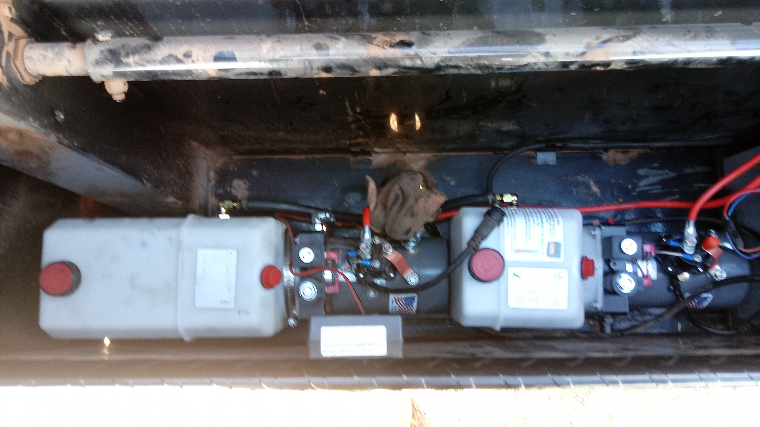

Almost done with the conversion, still lack one o-ring boss #6 straight and both tee's. Sunday is not a good day to find parts, I did get all 4 hoses made, that was good.

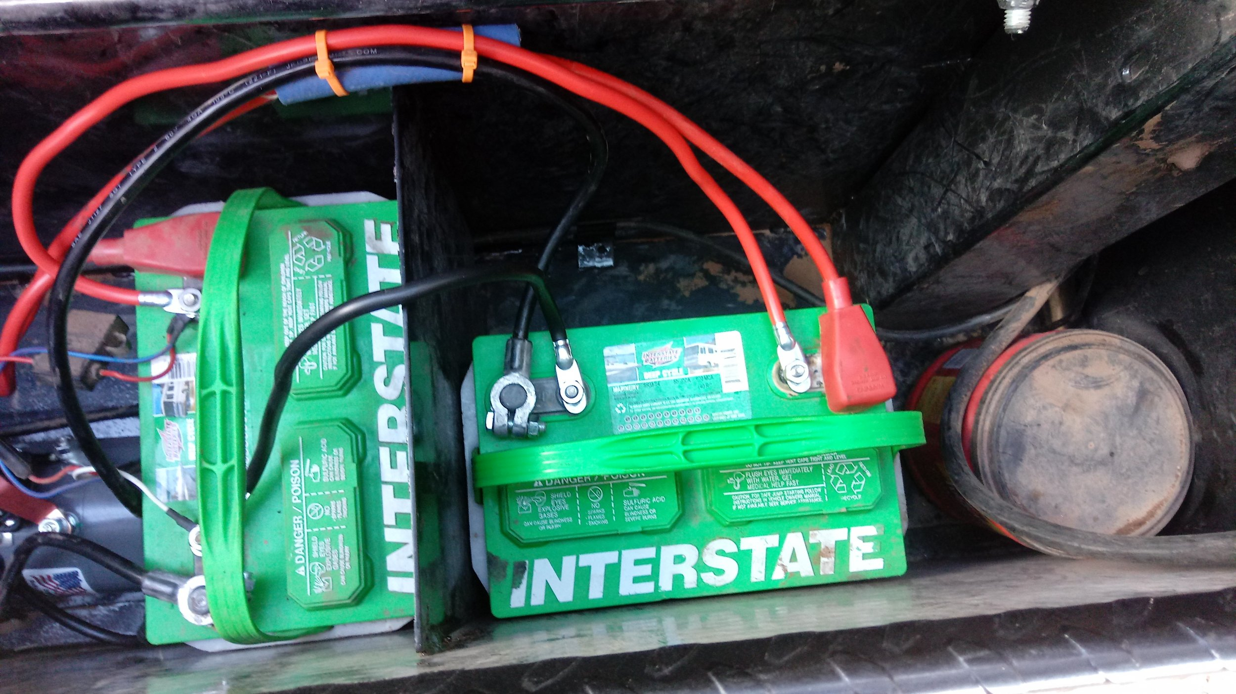

I moved one battery out of the large section of the tool box and turned the existing one, for clearance to add the second pump. I wired one battery per pump and jumped the batteries together. I am going to run both controllers for independent use of each pump or both.
I will be all in for about $600 v/s $1200 for the double pump, plus what they don't furnish for the install.

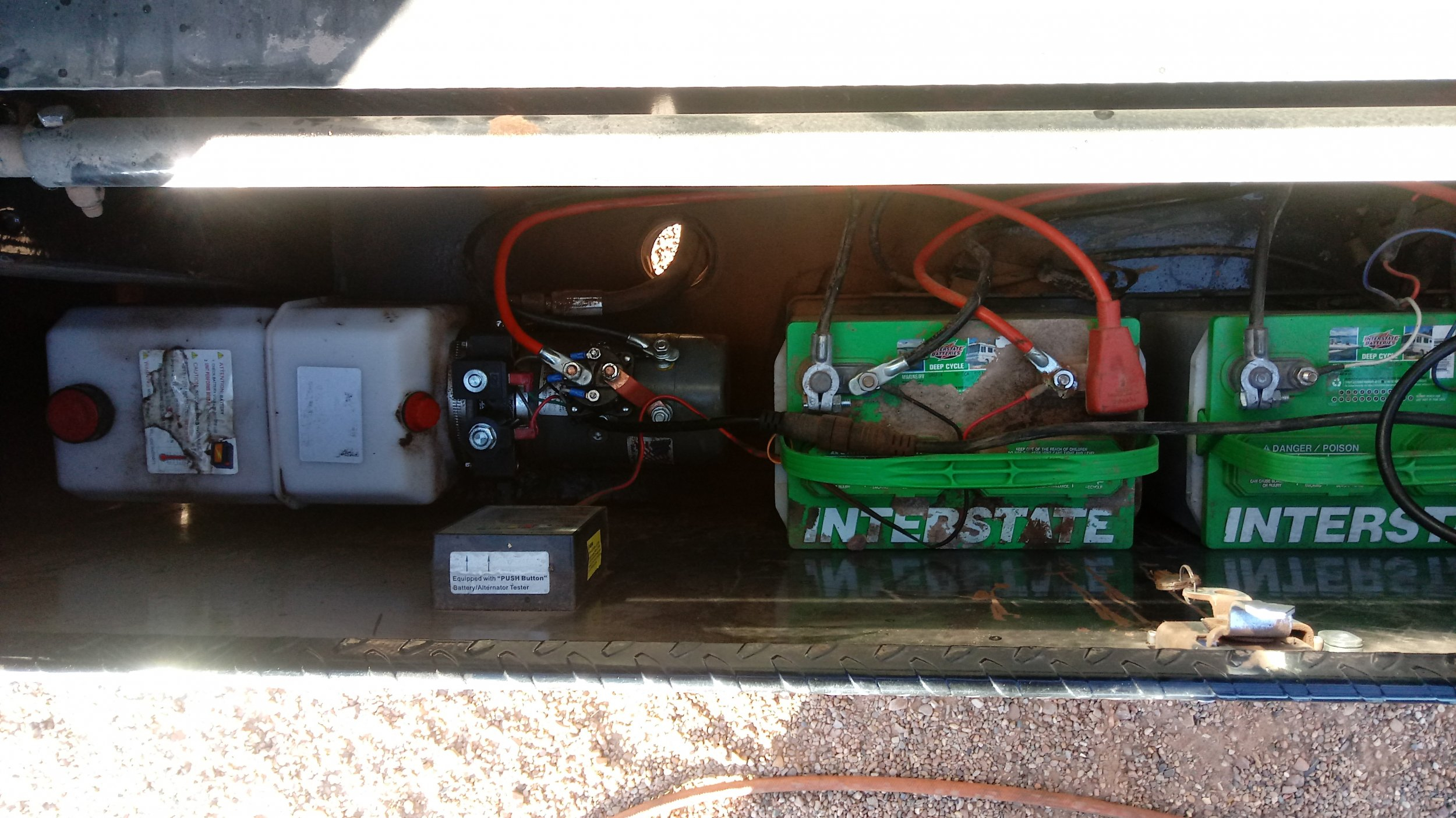

Finished the two pump install. I like it! With two pumps in operation, it goes about twice as fast, as expected.

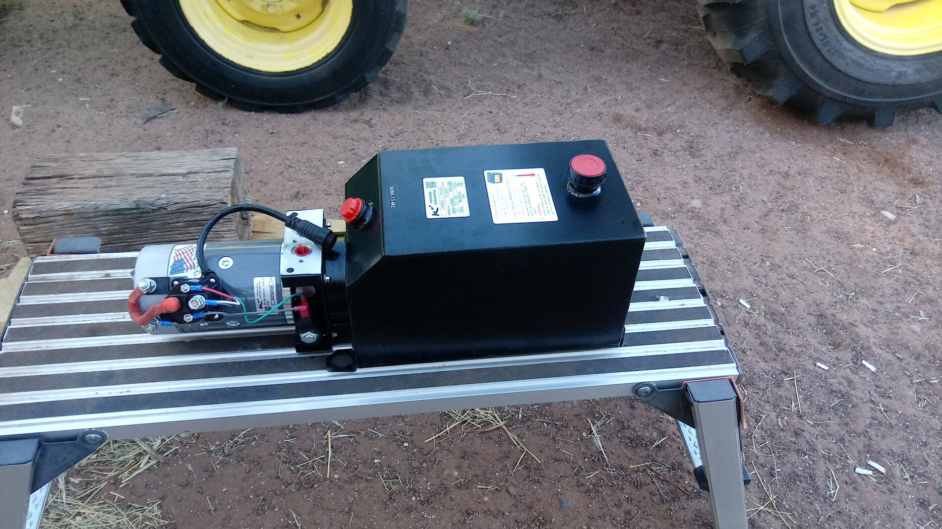

Diamond C and KTI developed a 3 gpm pump for the telescopic lift to help speed it up. Not sure why they didn't go for more yet. I bought one for my Lamar. I like it, about 50% faster up but since it is only gravity down, it is slow coming down. I just live with it, since there is no battery drain. I think I can speed that up if I change the load control valve or maybe even drill it out a little bit. I still have to dig into that. Too fast and it will overflow the tank.
You might install a pressure gauge and check your pressure. Picture of my 3 gpm pump. The motor on a standard pump is 1.6 kw, this one is 2.2.

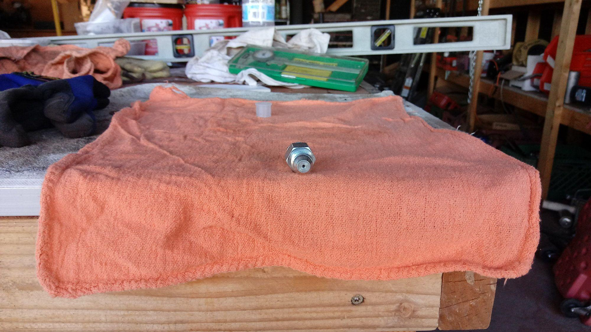

I went ahead and modified my load control valve for more flow. Oem is 2 GPM. When I added the higher volume pump I left the valve alone.
I was feeling dangerous, so I dilled it out. I went 2/64's more, from 1/16 or maybe metric, not sure. Empty, it is at least twice as fast, this is gravity down. It also goes up at least 50% faster. On a cold day, this is going to really help speed it up. I still have to test it with a load but I think it will be fine. I do have a spare oem valve if I need to modify it and start over.

You could probably ditch that fitting entirely and use one of these instead: 1/4 NPT 10.5 GPM DYNAMIC JPFC-1/4-NPT In-Line Flow Control | Dynamic | Brands | www.surpluscenter.com
This will provide full flow in one direction (like lifting the bed) while providing adjustable flow in the other directions (like lowering the bed). Basically, you could set how fast the bed lowers with this valve, while lifting at max speed.
The restrictor that comes with the pump will restrict flow in both directions which is less than desirable.

The resistance from the lift cylinder creates the pressure. The smaller the orifice the less fluid can pass through, which can cause excess pressure due to volume control. There is a fine line between too small and too big. Too small can cause a bottle neck in the pump flow specs and too big can drop the bed too fast. Empty, you can drop fairly quick but if you still have a partial load, it can fall too quick and hard when it gets to the bottom.
It is also a safety valve in the event you blow a lift hose. The valve will still control the fall. Without it, the bed would fall so fast it would destroy itself on impact with the frame.
In general, the oem sizes the valve with the pump flow. In my case, I changed from a 2 gpm pump to a 3, so I need a slightly larger valve to take advantage of the extra flow.

Those adjustable flow control valves will still provide the necessary safety in case of an hose blow out, as long as one doesn't leave it all the way open, which shouldn't really happen unless people like their beds hitting the frame hard.
It still regulates the flow when the bed is lowering, but provides full flow while lifting make for faster cycle times.
