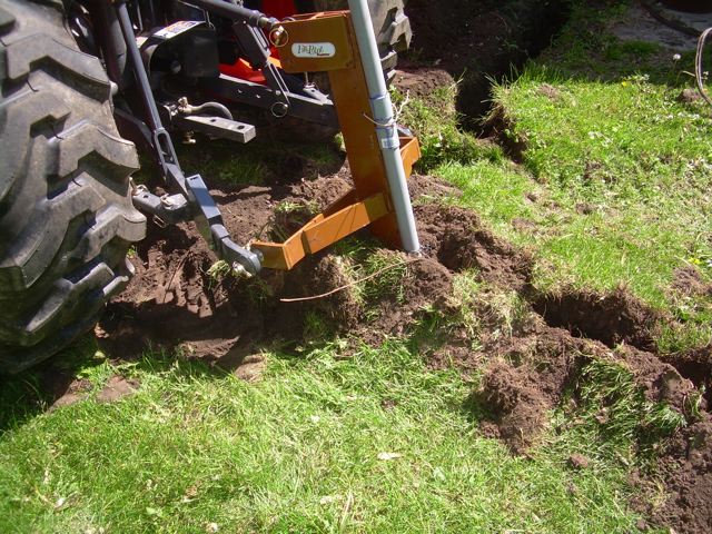

So i needed to run some power to 3 or 4 diffrent locations around the yard.
Most under 50' runs but when you looked at all 3 or 4, it was quite a few feet of wire.
Initially i thought about trenching and renting one, but really seems like overkill for such a project.
The old guy next door has this modified diching/plow thing. (like a patato plow) that ive used before to cut some WIDE trenches about 10" deep, it works but is overkill for wire. (cuts a great drainage ditch though)
I had heard about people riging middle busters to do this, and a real cable pulling machine is nothing more than a thin plate of steel that you attach the wire to.
So when cutting the fence line the other day i noticed another impliment he had laying in the weeds.
Figured if i could remove one of the 2 fingers, replace one of the bolts with an eye loop then icould pull some wire with it.
So thats what i did.
http://www.snjschmidt.com/pics/05-28-08/DSC03515 (Large).jpg
figure it will pull about 8-10" deep. good enough for the short runs to the
-well/pump house
-chicken coupe
-new above ground pool
-back to the service pole for a nightlight
http://www.snjschmidt.com/pics/05-28-08/DSC03517 (Large).jpg
area's were i suspected roots i cut first with no wire as i ususally couldnt pull it in one pass, but other parts of the yard that were clean were easy to pull in one pass.
http://www.snjschmidt.com/pics/05-28-08/DSC03518 (Large).jpg
after i was done i ran back over the seam with the wheels and pushed it back down, min disturbance to the yard . in a week you shouldnt be able to tell i did anything in the first place.

Sounds like that worked really well, although the proof is in the continuity check.
I was thinking it would be crafty to fab up some kind of hollow ripper and then mount a spool holder above it. I think they use something similar for laying sprinkler system hose.
My friend used to work for SpiderPlow, but that might be just a touch overkill for this application.

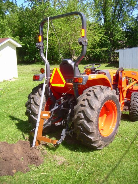

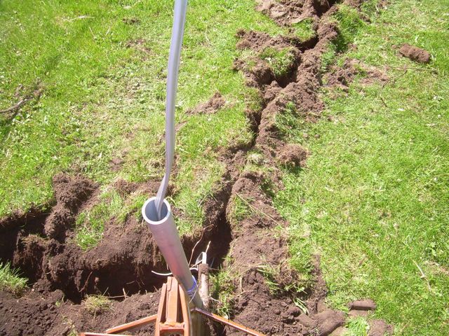

I've had coppying kennyds setup in mind for a while. I was going to solve botabill's issue by laying in conduit and fishing the wire through that - anyone tried that with a wider pipe on the back of the subsoiler?
/ pull'n cable
#11
ya it would be nice if they were 2' deep.
but then again that means i have to spend another $100 and 3hrs of time to rent a trencher.
half of them are temporary as the trailer that 2 of the runs come from, will be gone in a few years once we have the house built. So at that point when im forced to redo the system, i may consider puting them deeper.

as this was liked in the other thread.... though i would answer the question.
both the spool of wire on the draw bar and the stuff hooked up are both direct bury NM (the grey stuff)
the NM hooked up was from a new roll. the stuff spooled up on the draw bar is from an old spool was probabily5 years old that has been hanging on the wall. Might help explain the color diff.
That weekend I put in 4 runs. Barn to incoming power pole for outside recpt and overhead light. barn to chicken coupe. trailer to pool deck for outside recpt and pump motor, and trailer to well pump (really an outside recpt)
All have worked great with no problems.
I also ended up trading a few round bales of hay from my front field for the ripper you see in the pics. (there are actually 2 shanks, i just removed one for the wire pulling)
