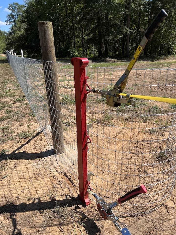

Another weekend and I didn't get around to pulling any t posts. I did manage to install 4 rolls of wire fencing for another 800 feet over the weekend instead. With the recent rain that we've received, I'm going to try the manual fence puller first. If not, I'll probably just wrap a chain around them and pull a few at a time, when I have the time. I've lost interest in fabricating anything.
   / Pulling T Post ideas #39
Eddie… i just hook my field fence gripping device to my tractor and back up. I gave up in come alongs. Because im just that lazy.
#40
I really like being able to adjust the top and bottom tension this way. If I have a lot of slack in the fence, I will pull it right with the tractor, and then finish it off with the come alongs
