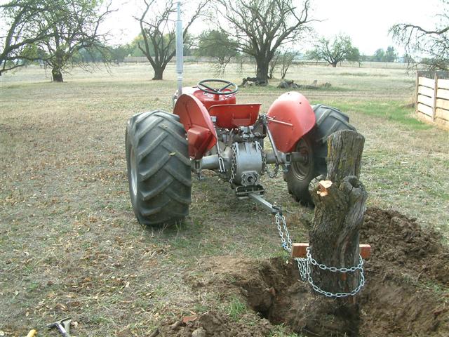

Hi all,
I have half a dozen stumps to remove, about 6 to 10 inches in diameter. I did a search on the forum and all I could find is recommendations to use a dozer to remove stumps. Thing is I don't really want to rent a dozer for such a small job. How safe would it be to attach a chain to the hitch of my 2720 and pull the stumps out? Would it work?
If it doesn't work I guess I'll just cut/grind them and forget about it, but I'm mostly worried about bending/breaking something on the tractor in the process of trying... I don't really know how sturdy it is!
Thanks,
- Jeff

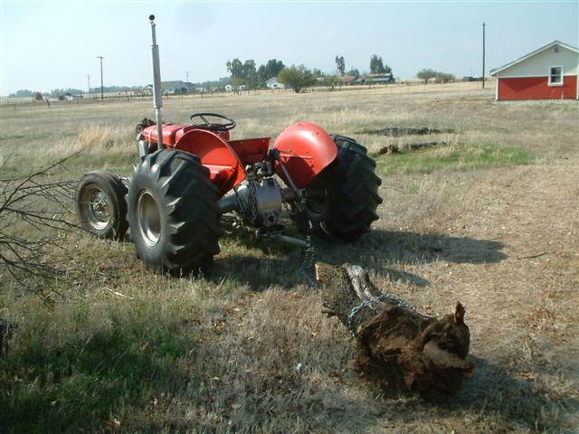

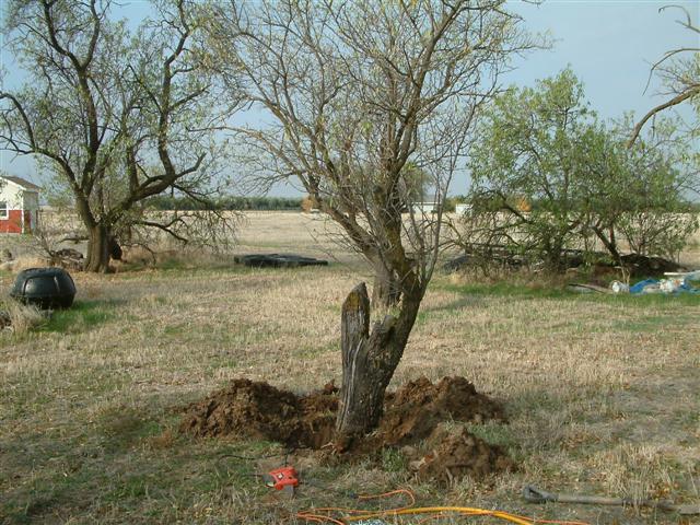

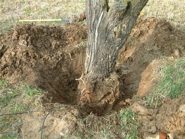

It took me quite a bit of digging and root cutting to get this old almond tree out of the ground. Used my 1964 MF135 diesel to yank it out via the drawbar once the lateral roots were severed.
DSCF0014 (Small).JPG DSCF0015 (Small).JPG DSCF0016 (Small).JPG DSCF0017 (Small).JPG DSCF0019 (Small).JPG
Those rears are Goodrich 6-ply 18.4-16A tires (18"wide, 16" dia rims, 40" tall overall) and are filled with water (as are the front tires).
Just be careful pulling from the drawbar. It's safer to dig a little more and cut a few more roots than you think necessary rather than trying to yank the stump prematurely.
