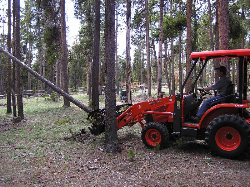

For pines, I use the FEL. Wish I had a grapple or root rake but I don't. So, I wait for the ground to be a bit wet. I approach the tree in a very low gear and catch the tree with the bucket edge about 4-5' up. Then I push it over. If the ground is right, the root pops up and out as the tree goes over. (If the ground is not just right the tree will often snap at ground level making it a major pain to get the stump and tap root out.) Once the root has popped up some, I approach the base of the tree with the bucket at an angle so that it hooks under the roots. Then I curl the bucket as I drive forward and the whole thing pops out. This has worked on young pines up to 8" in diameter. For smaller ones, I just dig the bucket in right at the base and pop them up.
This method does not work very well for gums, oaks, maples, etc. Most of the time they will shear off or break leaving all of the roots still in the ground. So I just dig them up. Much more tedious and slow.

Eastern Red Cedar, Juniper really (juniperus virginii or something llike that) can also be removed by shoving on the trunk. Push too low and you just spin your wheels, push too high and the leverage can break the trunk, but if you push at the right height you may partially shove it over and the roots on the near side will be partly exposed. Digging at these vulnerable roots will make it easier to get the tree out.
With my Kubota L4610 (40 HP) I can get trees out up to about 8-10 inches in diameter. Moist soil helps but at some point it makes for less traction so the moisture assist is self limiting.
The cedar has no tap root and does have a relatively shallow root system.
