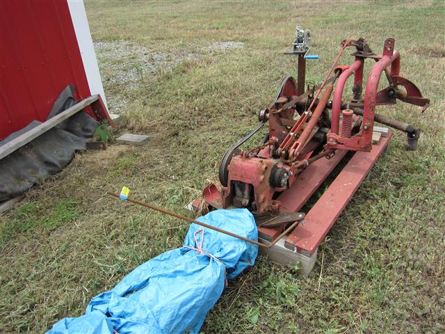

You're agonizing over 15 minutes? Rather than possibly messing up your ATV or pickup, why not just practice attaching and removing your sicklebar until you can do it in your sleep. The first few times I attached my old 7-ft Massey Ferguson 31 sicklebar to my Mahindra 5525, it took about 15 minutes of work with my 5-ft steel pry bar. I made a nice wooden platform for the mower to rest on and that helps a lot getting it onto the 3pt. It's a lot easier to move the mower around on the platform than on the ground.

Will the 3pt. pick the mower up high enough to get the rake on the drawbar?
As for raking with the Ranger, I'd say ok for the 1st go round. But if prolly won't be (because of ground clearance) be able to combine rows or "roll" the hay for the 2nd round.
