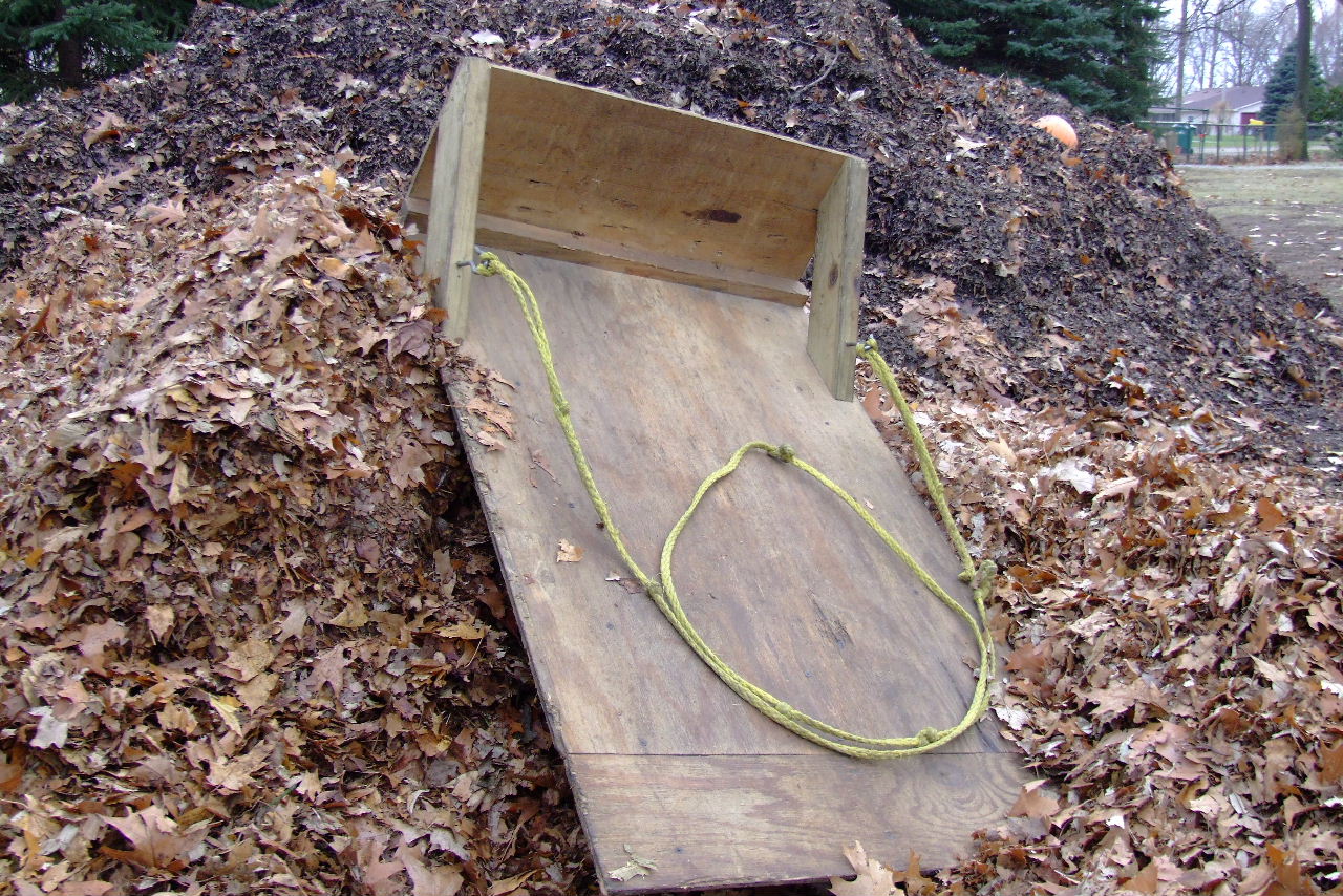

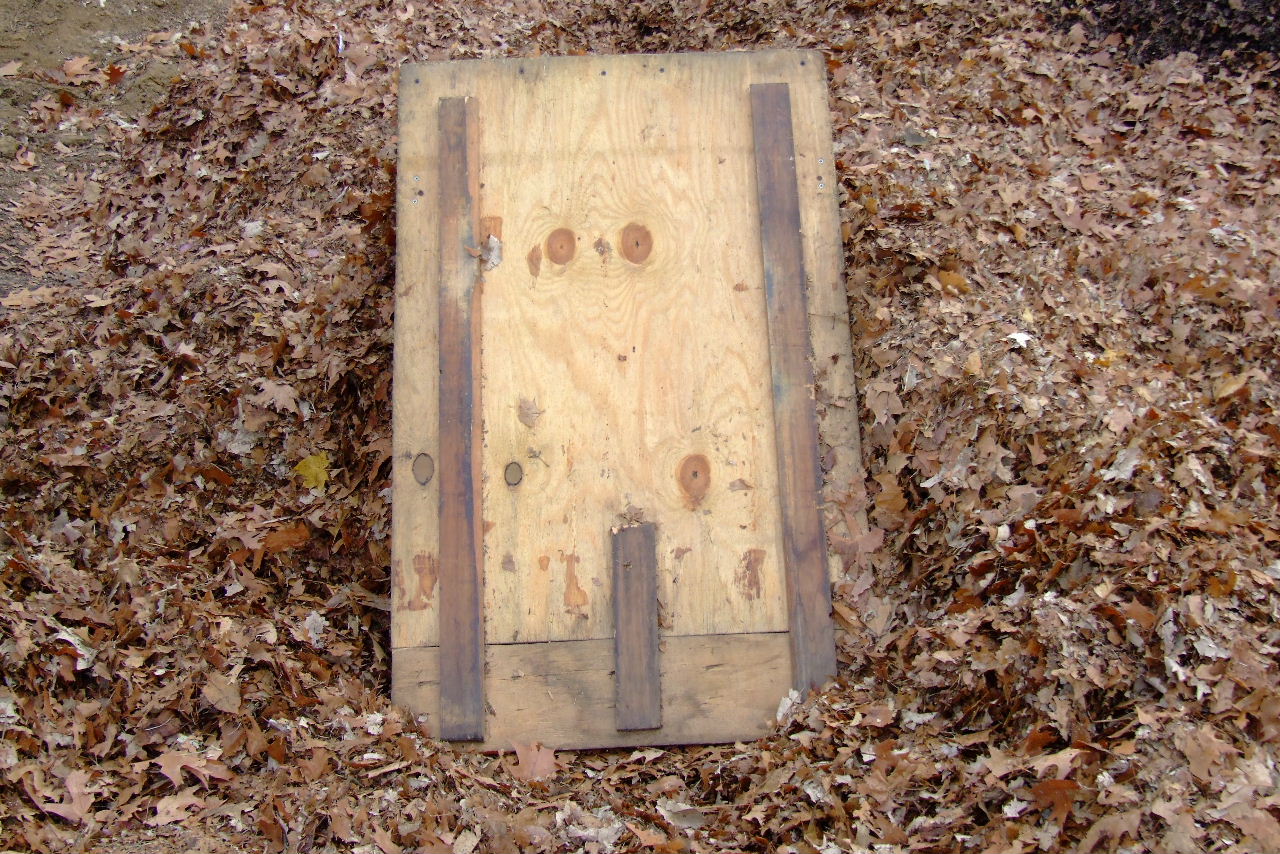

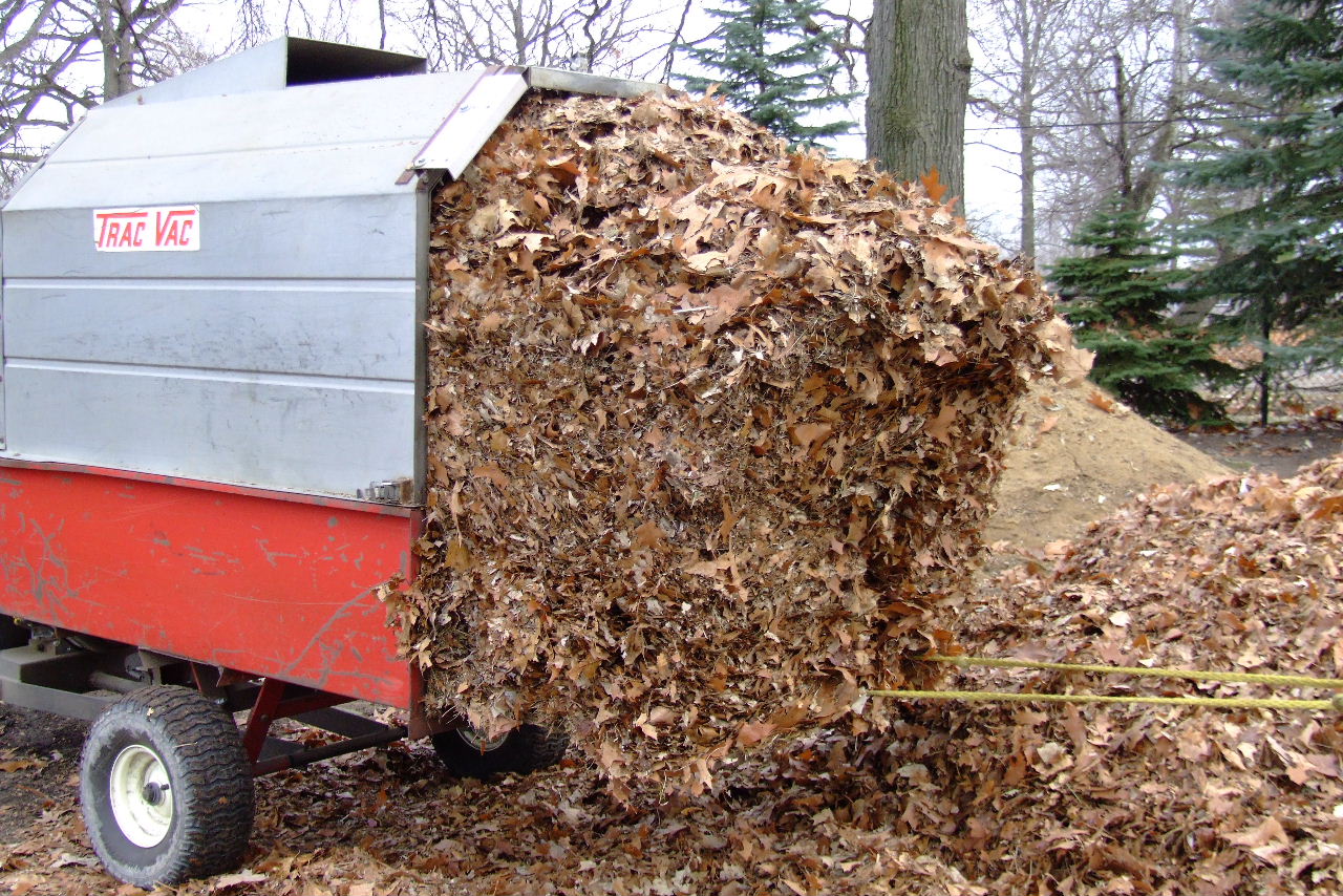

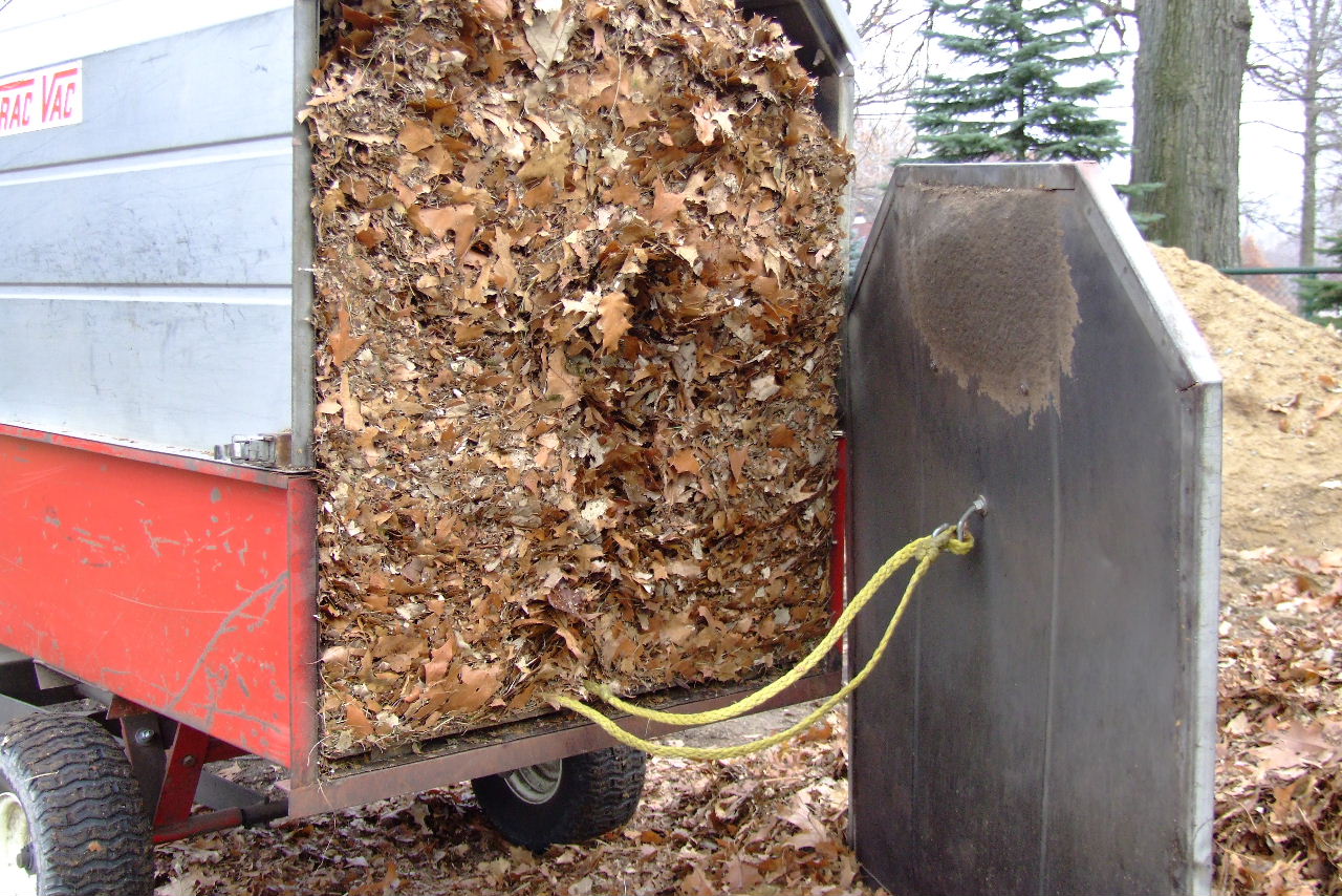

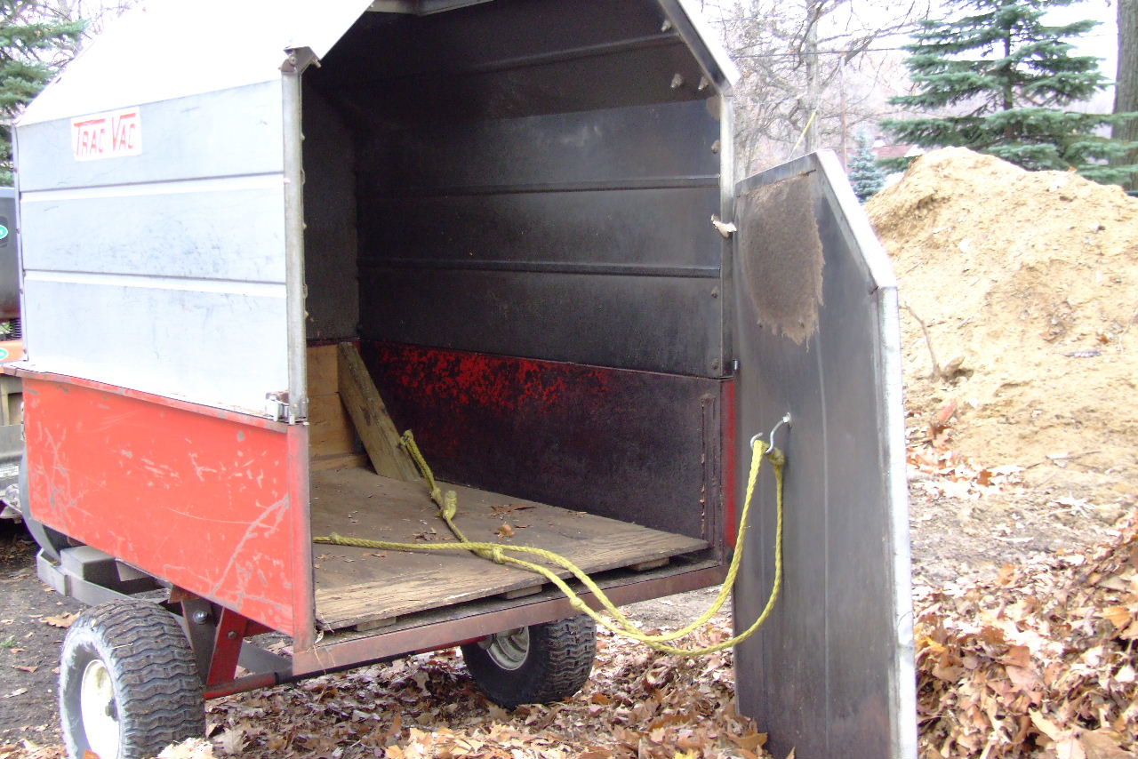

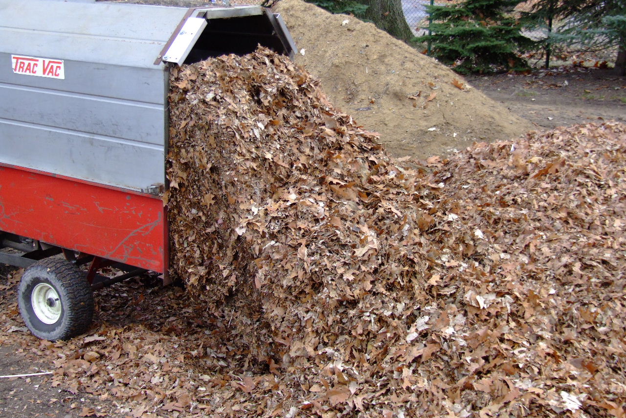

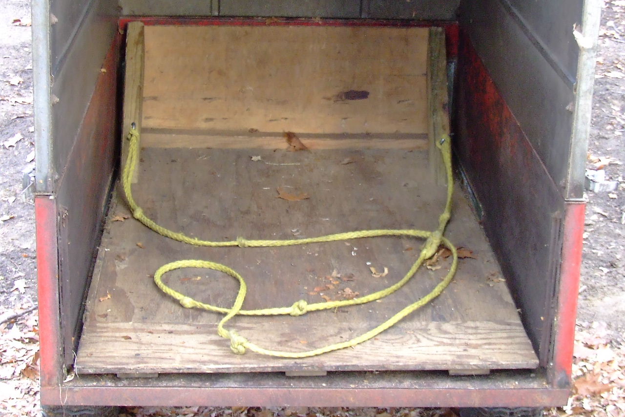

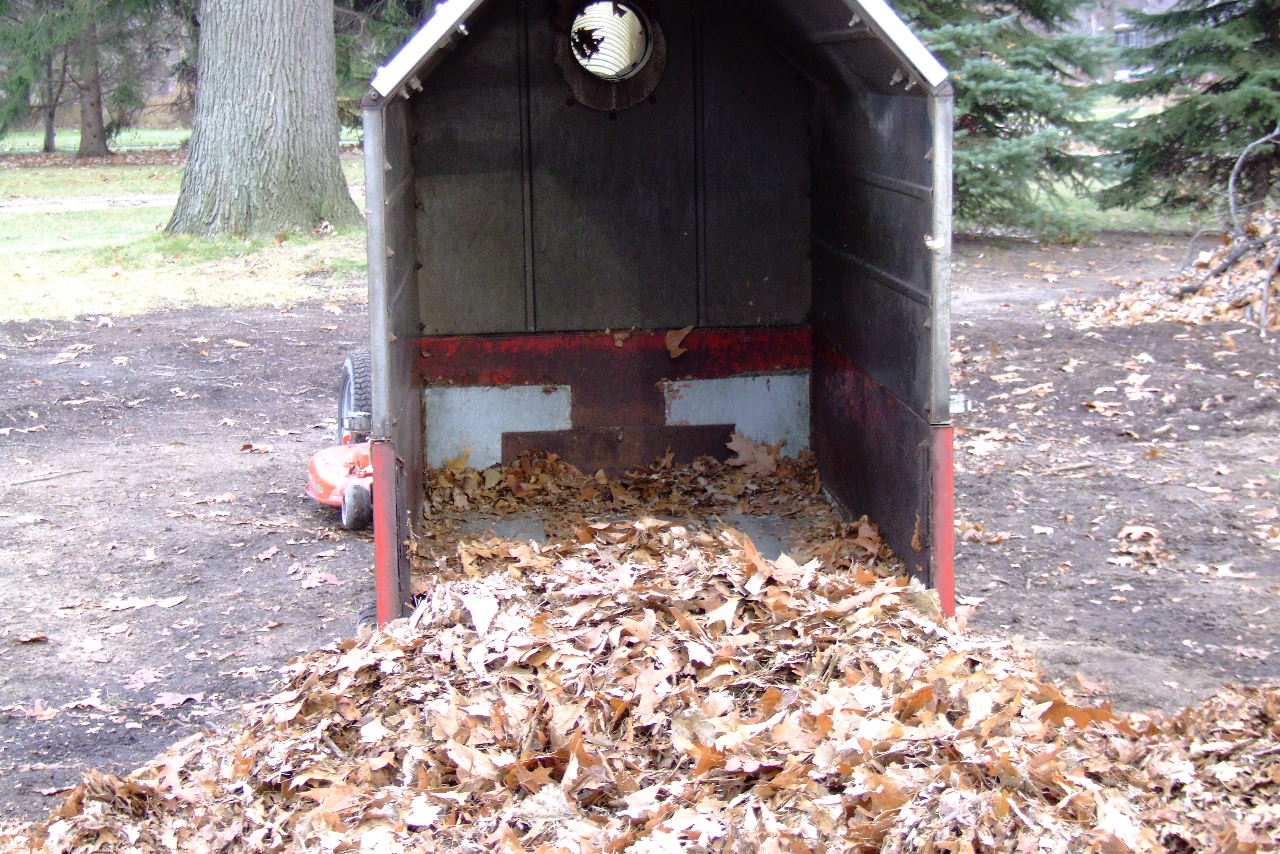

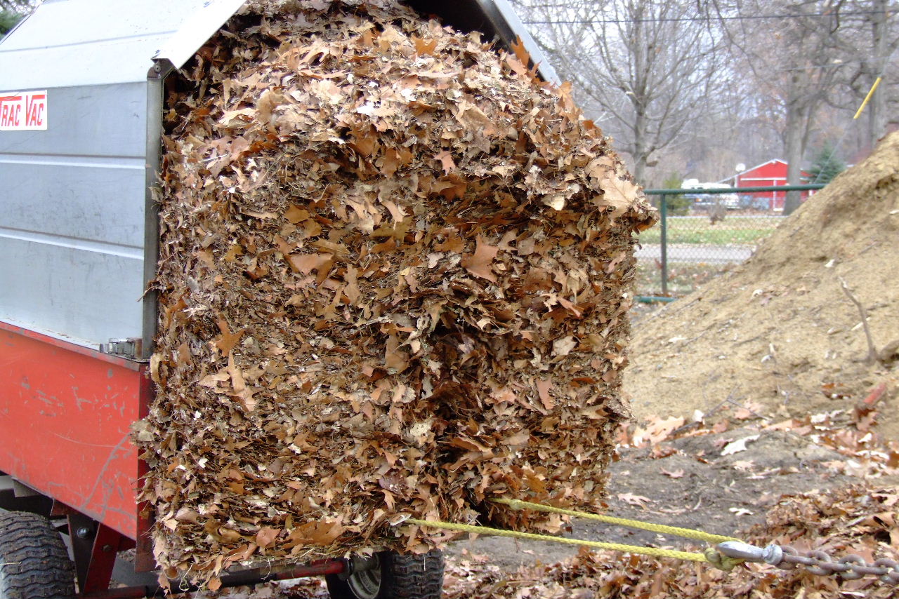

Tell me more about this "slide out". Is it just flat across the bottom, or did you put a lip on the front (tractor side).

Yes, the 'tractor end' has a 'back', about 12" high, with 2x4 angle braces mounted to the floor of the slideout. The floor is plywood with fir-ing strip runners mounted on the bottom side. The leaves come out in a 'cube'. I'm planning the final leave pick up later today. I'll try to get a few pictures to post...

Thanks - I'd love a picture - I might have to rig something up for the weekend (they are predicting snow on Sunday, I'm trying to get the rest of the leaves up b4 then).

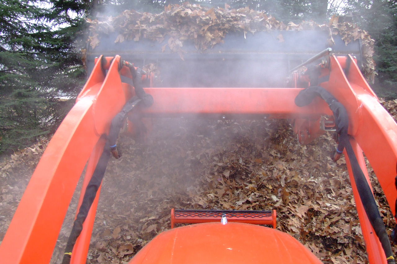

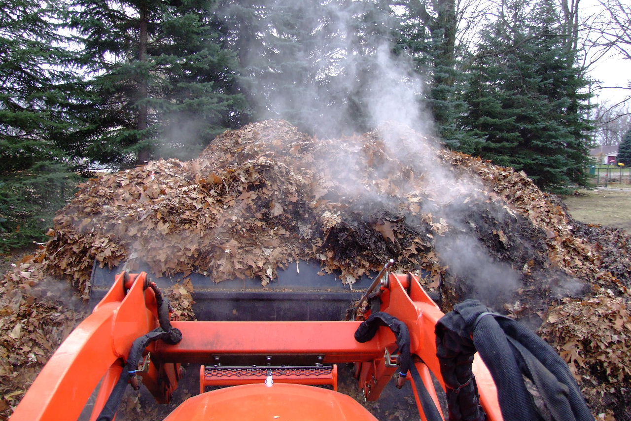

Pictures are here. I call this thinking "inside the box".:eek: Last two pictures are "compost at work". :)
BTW, When my clamps gave away on the output chute there was a broken weld on the trailer frame allowing the trailer to rock from side to side causing excessive stress on the clamps.
Hazmat wrote: The other problem is that when you dump it, the leaves don't come out w/o having at it with the pitch fork.
Put the pitch fork back in the shed. A metal landscape rake works much better for 'pulling' out leaves from the trailer(with or without a slide-out).

TB Donnely, wow, great idea!! I think I may have to borrow that page of your playbook.
I do find that dumping when 3/4 full is much much easier.

Thank you. Your welcome to use the idea! :) From repetitive use, I have a feel when the trailer is close to full and usually I'm pretty close. Every once in a while the trailer overfills and clogs the hoses, it's usually when I'm close to finished and trying to squeeze the last bit in.

Thanks for the pix Don.:cool: I'll probably stop at the Depot for a 1/2 sheet of exterior ply on the way home...

Hey, You're welcome! :)
Does your trailer have the taper, where it's wider at the back end?
Does your trailer have the 'slots' for a rear tailgate? My slots don't go all the way to the floor and my slide-out is just wide enough to slide underneath the slots(see pic number 1546). If the slide-out angles a tad on the way out it can get hooked under the slots. To tweak the design I need to place a couple guide strips at the base of the inside walls. If you have the tapered trailer, your slide-out will naturally come away from the walls as you draw it out.

This is so creative -- and simple --I'm mad at myself for not thinking about it, but i'm glad you did! I"m going to steal your idea too -- I have a larger trailer i built sides on just for leaves, but it is also a pain to dump, even with a jack. takes 2 people. I'm thinking i can do something similar to what you did.
great work! and thanks for great pics.
