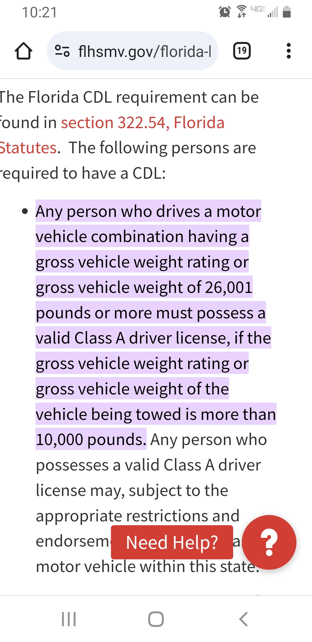

Here is a copy straight from Florida's CDL requirement book.It mentions the 10k trailer right behind the 26001.

You can drive dump truck or other straight truck above 26k with a class B CDL. You can tow a trailer up to 10,000 pounds with that same class B. If the trailer is above 10k and the GCVW is above 26k then you need a class A CDL.
