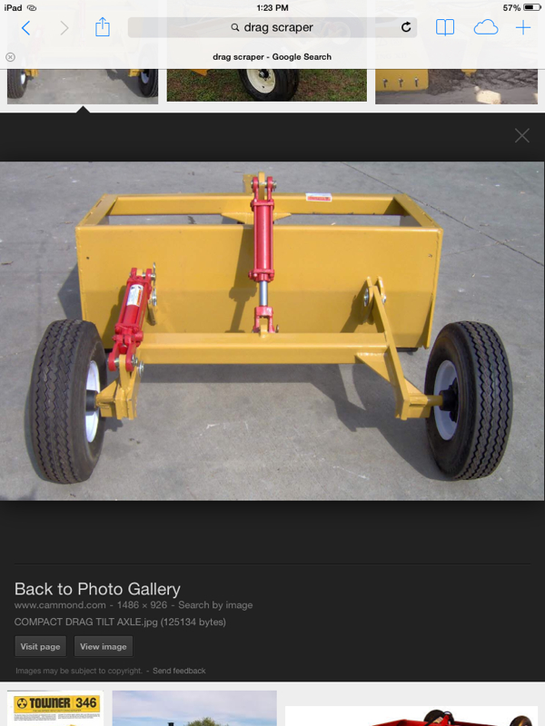

Been looking at pull type box blades , and thinking of getting one that has a tilt feature in the axle, but not sure if either style would be better than the other. Here are pics of the two types of axle styles I've seen.

I would rather not have that one in the center photo, where the axle pivots on a single bolt, very close to the elevation frame. If the axle had about a 1.5-2 inch pivot, and was spaced out from the frame so dirt and gravel didn't jam it, then a toss-up.

Agree with Bruce- the middle one looks like something that might get bent. First one seems to be a better way of tilting as it follows along and not dependent on a bolt for the axle operation

a tractors 3pt hitch gives you all that without the gauge wheels (some times gauge wheels optional)
1st photo, you can deal with ditches or maintain a dirt/gravel road that has a slant to it, to help shed off water
2nd photo, same as first with rear tilt cylinder, and then able to raise and lower it.
3rd photo, if you wanted a certain grade, and wanted to feather out the dirt as you were going on. this would be it. the 2 cylinders working together would be like adjusting a "top link" on a 3ph hitch. BUT! it does not do angling!
1st photo, i would avoid
2nd photo, if nothing but dirt/gravel driveway
3rd photo, if doing a lot of re-landscaping of property, and trying to get things nice and level.
though with above, i would most likely go straight for a 3ph box blade, and get a TNT (top and tilt) setup for the 3pt hitch (top link, and 1 or both side links, get replaced with hydraulic cylinders), and have everything, and be able to re-use the TNT for other 3pt stuff. and possibly be able to backup with box blade down, to kinda push some light stuff backwards.

I think the 1st and 3rd photo are the same equipment and #2 is a different machine. :confused3:

I see from a web-search that these come 8' and 10' wide, but the one in the picture looks small; maybe 4'-5'. If that is the case a BB with TnT might be better. What is price for the drag unit you're looking to buy?
TnT=$650 TSC BB 5'= $600 Total $1,250

Mine is like the 1st picture, without the hyd cyl. It seems to work real good when doing the road.

I don't have any prices yet, matter of fact I may take a six foot three point box blade and build my own wheels instead of buying a new one. I think I'll go with the tilt design in the first and third pic.

The biggest draw-back I see with this type of BB is there would be no close quartering to the back side...
It looks like it would be ideal for strictly (open ended) grading etc. applications though...!

Yes I would agree in small spaces it would not work very well I have a 3pt box to off set those times. I have a few bigger projects coming up that a drag style would be nice to have plus I may use it to keep the drive up until I built a land plane for that. Really trying to decide if the tilt is worth getting or just go with a standard rear non tilt axle design.

Get a tilt, even if you just have a ratchet adjuster on it instead of a cylinder.
If you buy non-adjustable, for those rare times you may want a tilt, add a skid shoe to lift the high side a bit. Another way is to have a larger or smaller wheel to swap into position as needed.

That may just be what I do, least I would have the ability if I decided to use it.

Dont forget you would need 2 sets rear remotes if you go hyd on tilt and lift.
