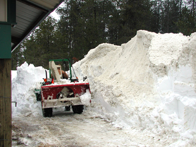

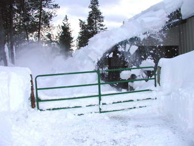

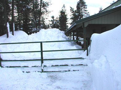

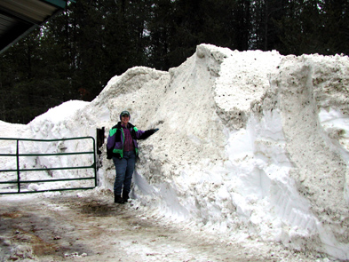

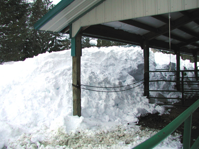

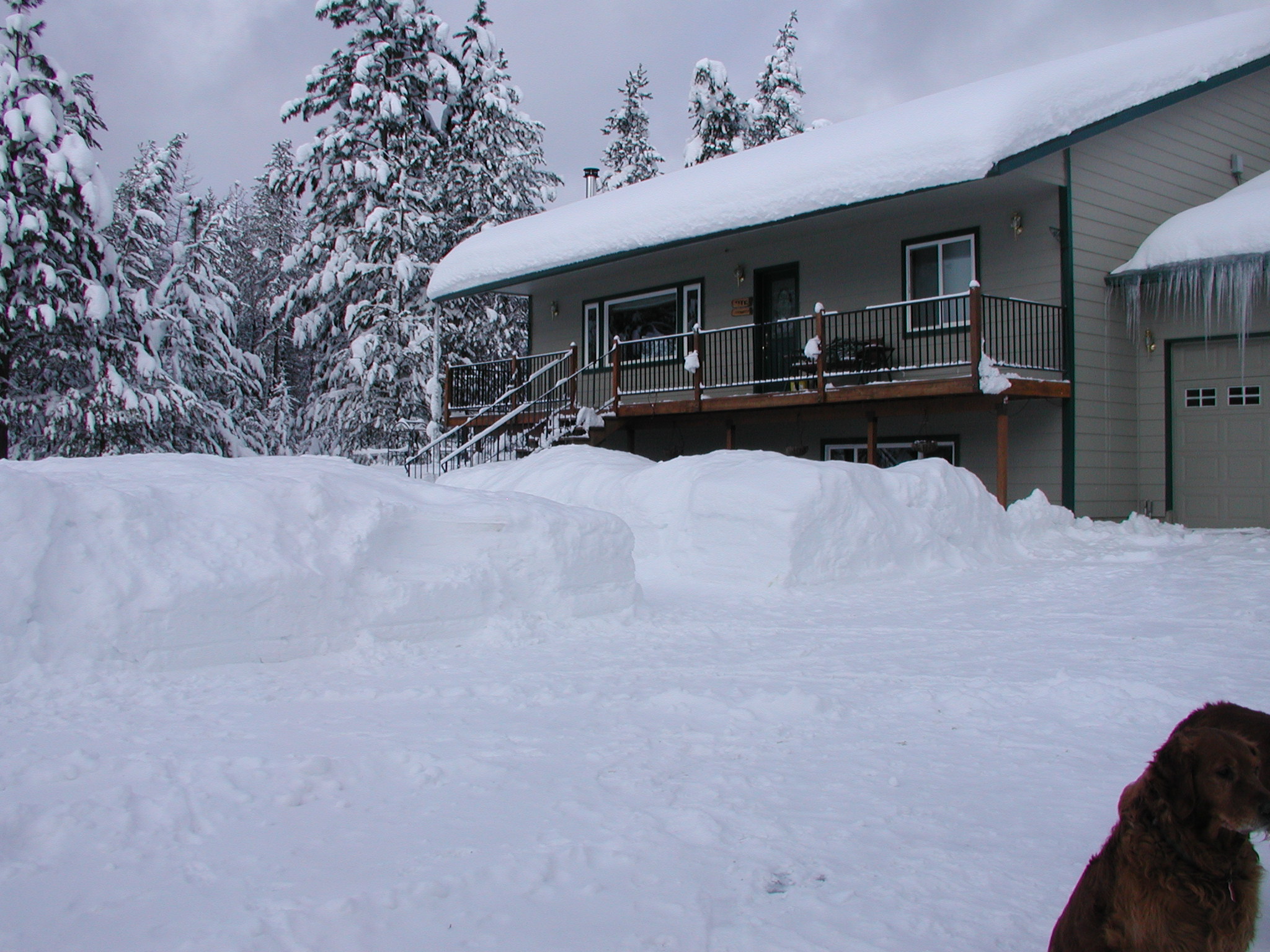

ya, i hear you. I take care of some neighbors driveways that have drifting issues. Can easily get 4 feet deep.
I was actually looking into getting a pull behind blower (way cheaper than what i ended up getting) but how in the heck could i clear the horse barn when it sheds????
You are way too domestic.:)
I blow a path to the horse barns so I can get to the round bale feeders and water tanks.... That's it
