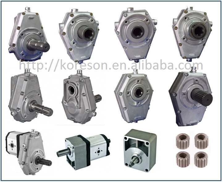

Went looking for the electric powered only PTO device on those Asian tractors. The dumb part is, you can not tell from the back of the machine! So, I then went looking for just the replacement PTO device with the electric drive motor and shaft. ATVs can use the devices too.

Those devices on the picture are just PTO speed increasers to run hydraulic pumps of the tractor PTO shaft.
They increase the 540 RPM at the tractor PTO to somewhere around 1500 to 1800 RPM. Several ratios are offered.
