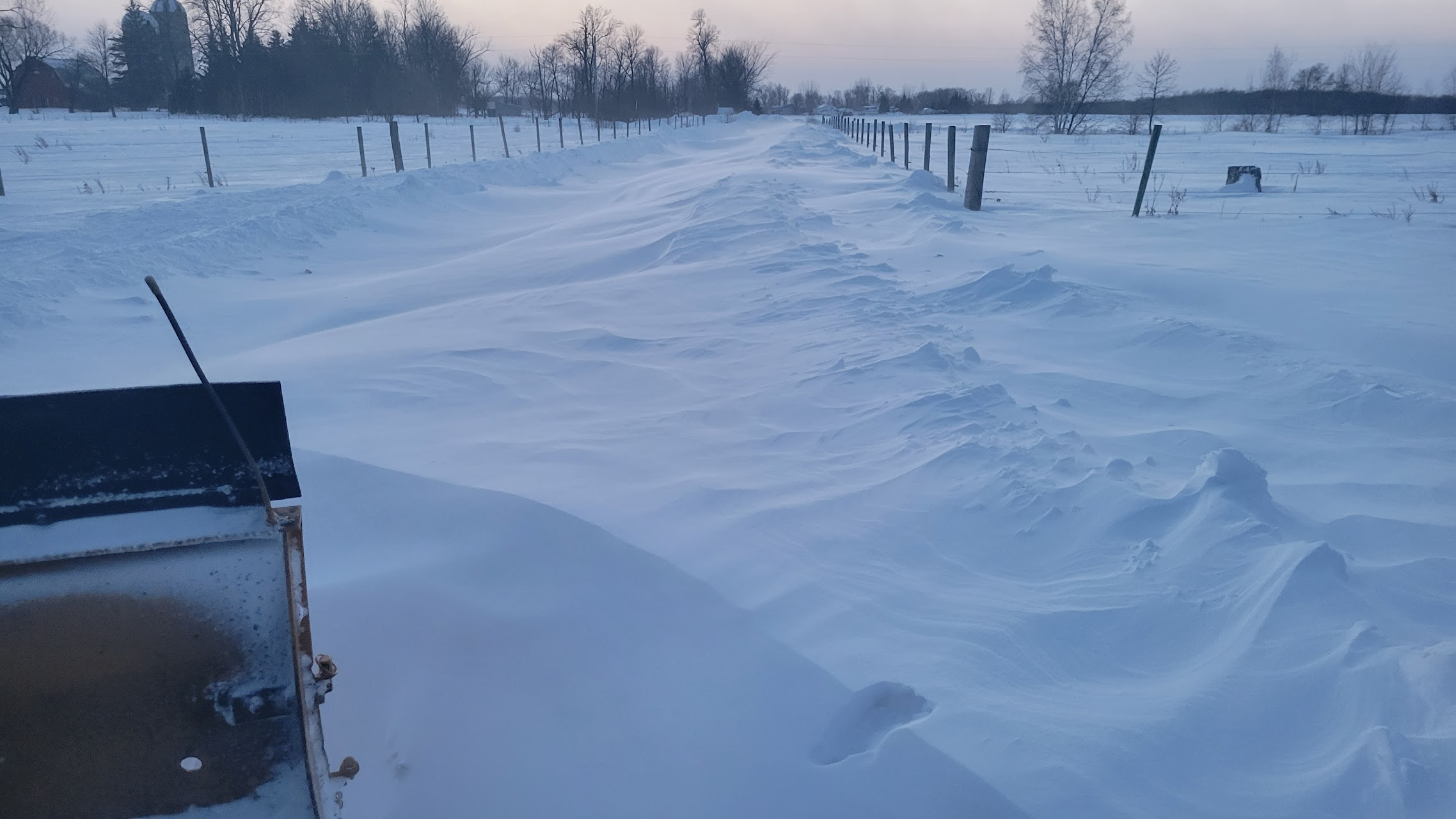

How much weight do you have total with the loaded rears? I'm still trying to figure out what the magic weight/width ratio for snowblowers is. Another thread seemed to say you want at least 5 PTO HP / foot of snowblower width.
Each snowfall normally isn't enormous, its the drift that happens that really closes the driveway. I honestly couldn't tell you how much I get, but I'll attach pictures of one of the worst days last winter. GRANTED, this is the result of plowing for 2+ months and creating berms which just aggravate the drifting issue.
Tractor weighs around 8500lb with loader and 78" HD bucket + weight of snow blower. More than heavy enough for 78", others near me run an 84" on same size of tractor. The 84" usually are taller and bigger fan, might move more snow and take more power, but they were way more money when I priced. (50% more)
You can carry the blower off the ground to put all weight on the drive wheels until final clean up/
I ran a different 78" on a much smaller 38 PTO HP 2wd with no chains with minimal complaints.
64 PTO HP plays with 78" I usually end up pushing snow with the blower without tractor lugging down.
For what you are picturing worst day with drifts, I'd have no issue with my set up. 3-4 foot tall drifts for long distances do require some extra work to open up first pass.

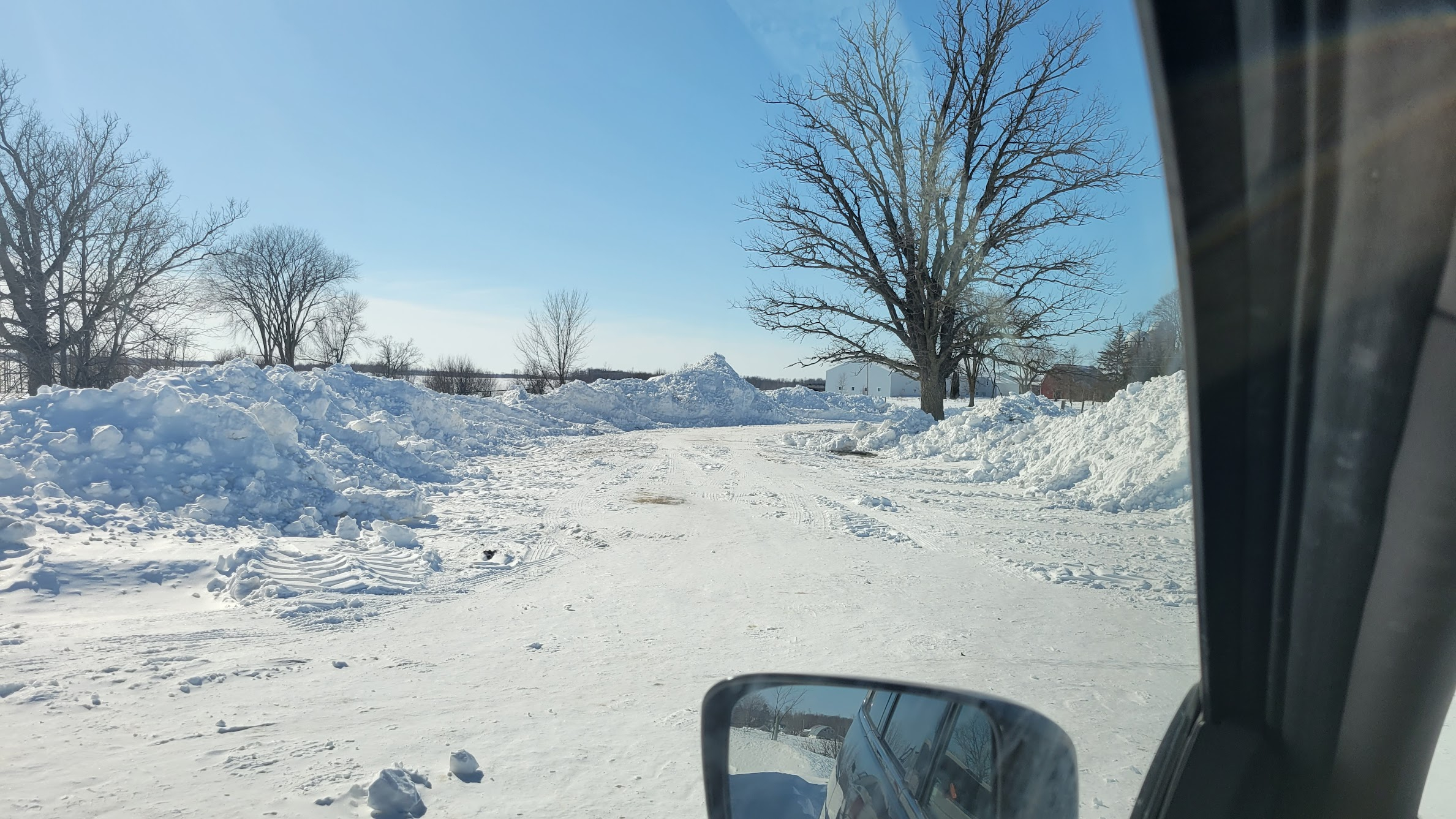

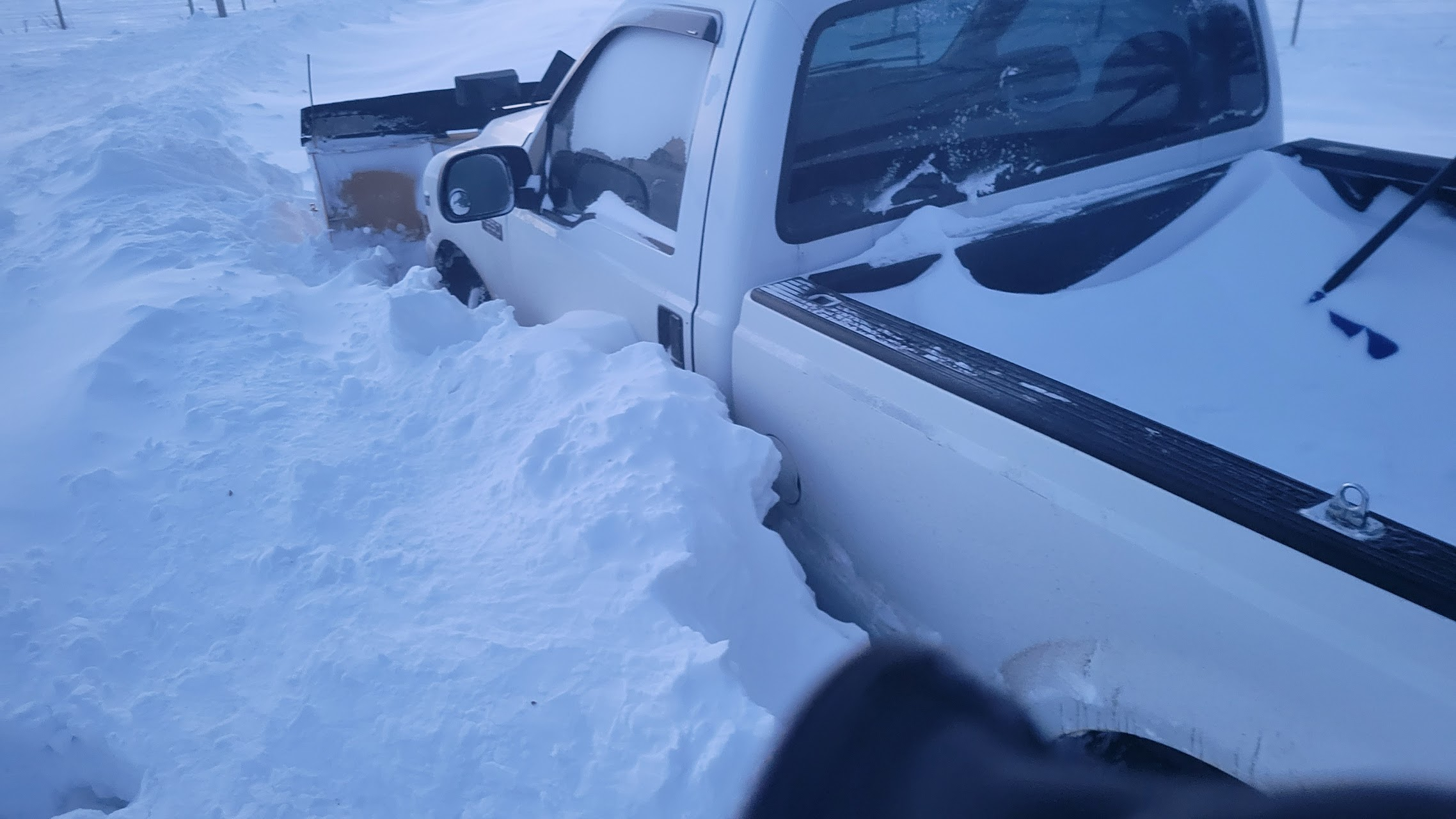

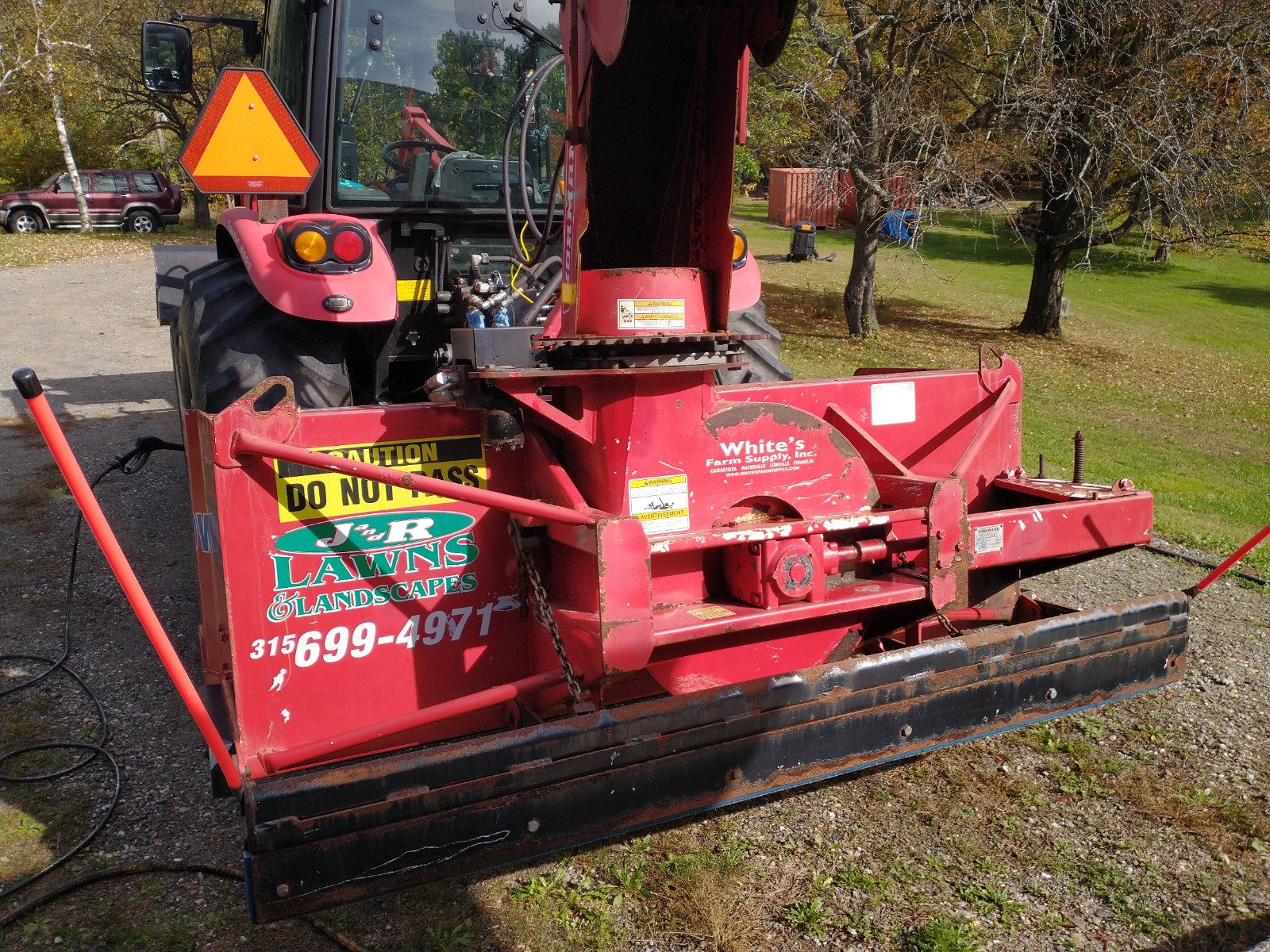

I'm from near Syracuse, NY. We've been known to get some blowing and drifting snow from time to time...
Currently using the only tractor snowblower we've ever owned, a Frontier 1164 on a John Deere 4600. 4WD, forward/reverse transmission, loaded industrial tires (that's what came on it), no chains. 64-inch working width, about the same as the tractor. 100 ft double-wide driveway at the house, longer and wider at the barn. Tractor has more than enough power to run the blower at full capacity. Yeah, we have to make more than one pass, but a blower that's too wide would limit maneuverability. Biggest thing is that we don't wait until it stops snowing to clear the driveway when a big storm is predicted. We'll clean it out as many times as necessary to get us out, or emergency vehicles in, as necessary.
