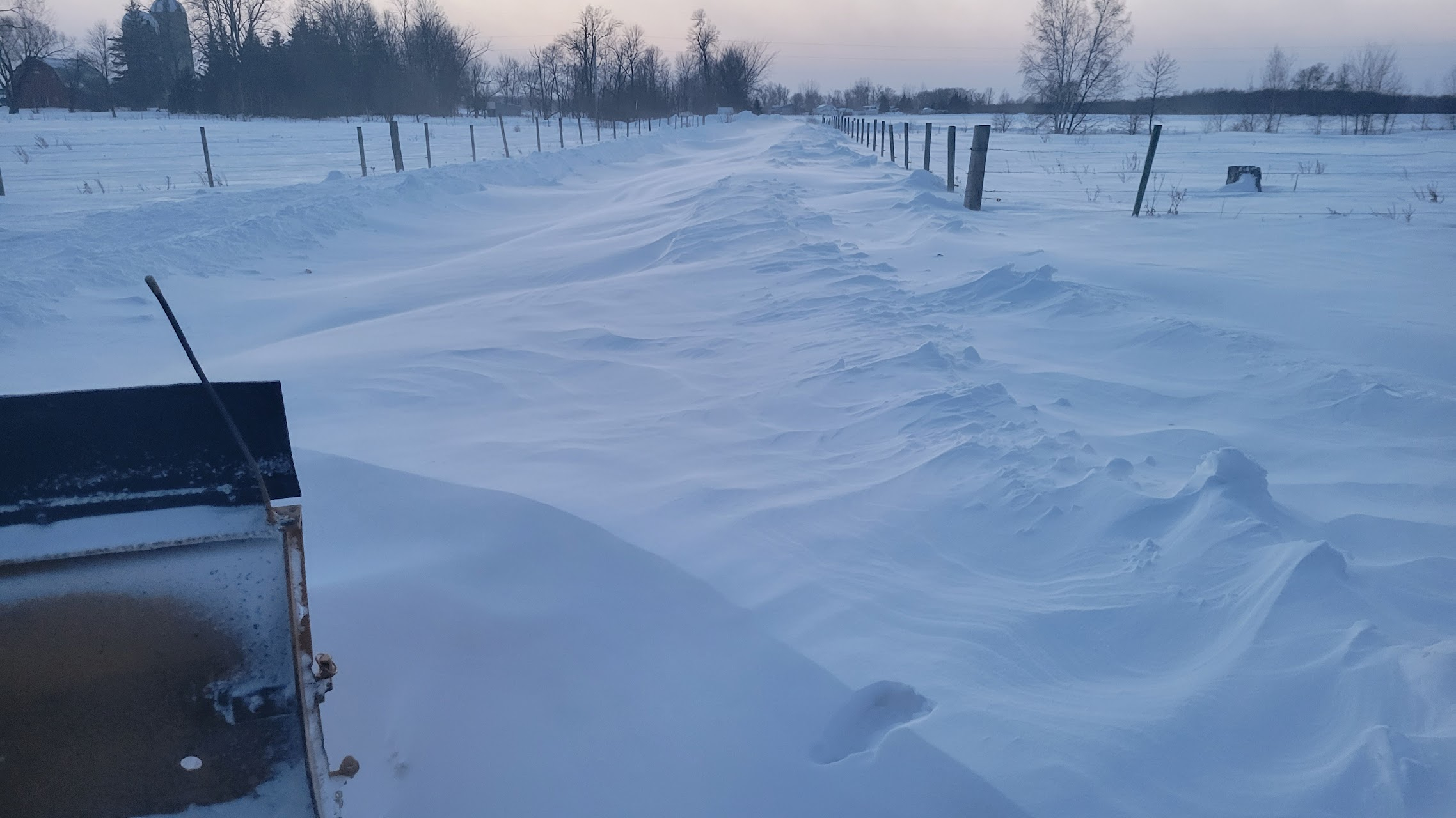

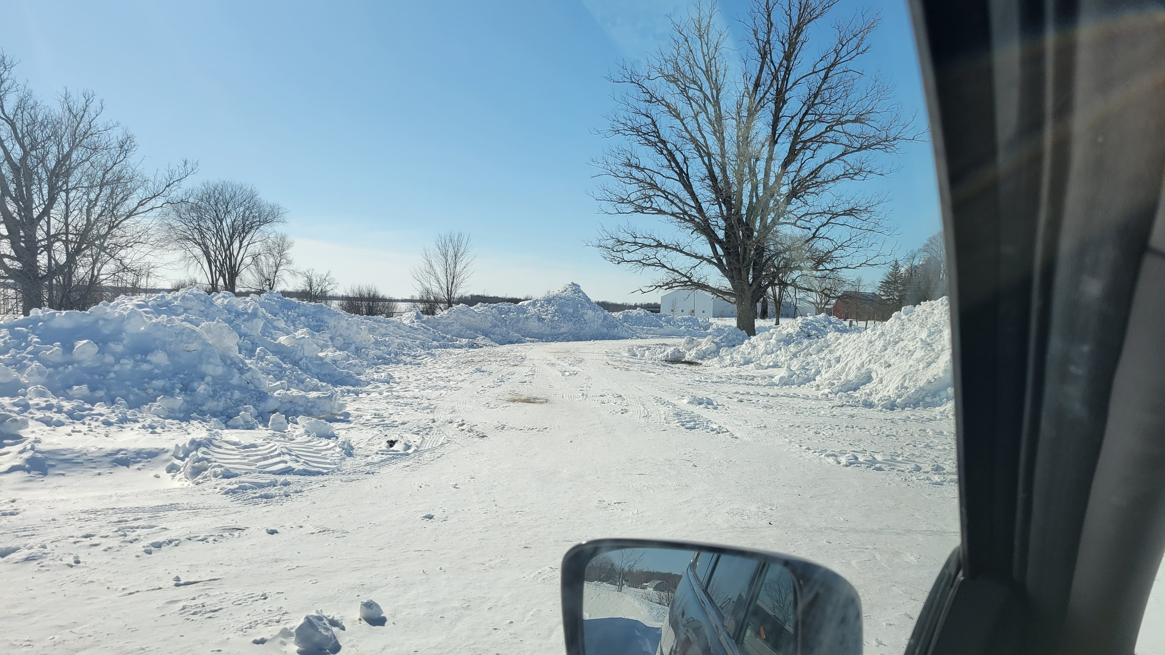

perhaps an inverted pull-behind blower could be an option?
Sadly this is not an option with the drifts. Does anyone know at what amount of snowfall the inverted becomes impractical? Maybe it works even in 3 feet if its all powder?
