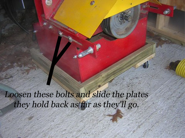

I hit a roadblock with the Jinma chipper - the pto shaft isn't long enough (10 - 12 inches) - I'm connecting it to a L5030 Kubota which can accommodate Cat 1 or Cat 2 hookups. I'm not sure what my options are - I know I can buy a different PTO shaft, but wondered if there were other options. Possibly a shaft extender or mounting something that "uses up" the space, and performs something useful - maybe protection in case the chipper jams. Possibly should be adding something like shear pin coupler anyway.

I have an L3130 and thought when I first tried to hook the chipper up that this was a problem I faced but I actually managed to overcome it by resetting the plates that hold the 3ph pins on the chipper further back. See attached sketch. You'll see that the plates are slotted for this very purpose. This has worked fine for me.

Techj, whether the pto shaft is replaced or not, I'd recommend moving the mounting plates back in their slots to reduce the cantilever on them and so reduce their liability to deform under load.
/ PTO shaft #8
I had put them all the way back when I first hooked it up -- didn't stop the problem.
