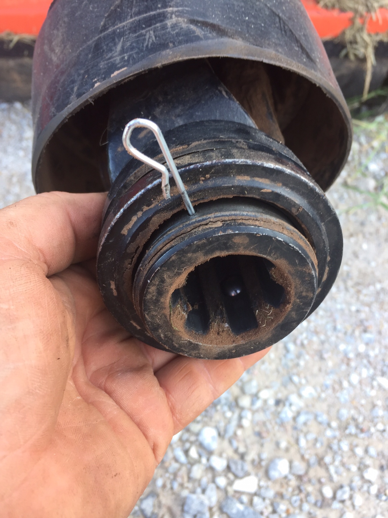

/ PTO shaft yokes #6
This is what I have done to make it easier to hook up the ring types. Pulled back the ring and drilled a 1/8 hole. Insert a clip or whatever, install on tractor, pull out clip. So much easier.

I like the design of the collar type on the PTO shaft I purchased a couple of years ago. When you pull the collar back, it automatically locks in place and then snaps back when it is slid onto the PTO drive shaft. Now that's smart engineering and a welcome change! ;)
Both good ideas.
