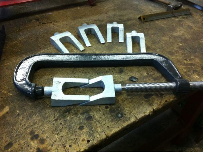

I have attached a couple of pics of a device I was going to help a mid west US farmer market about 12 years ago. Perhaps a pair of tie rod tools could be utilized for a wedging effect. Hopefully you've already solved your problem. Good luck.
Terry

Is the device you posted a picture of still produced?
