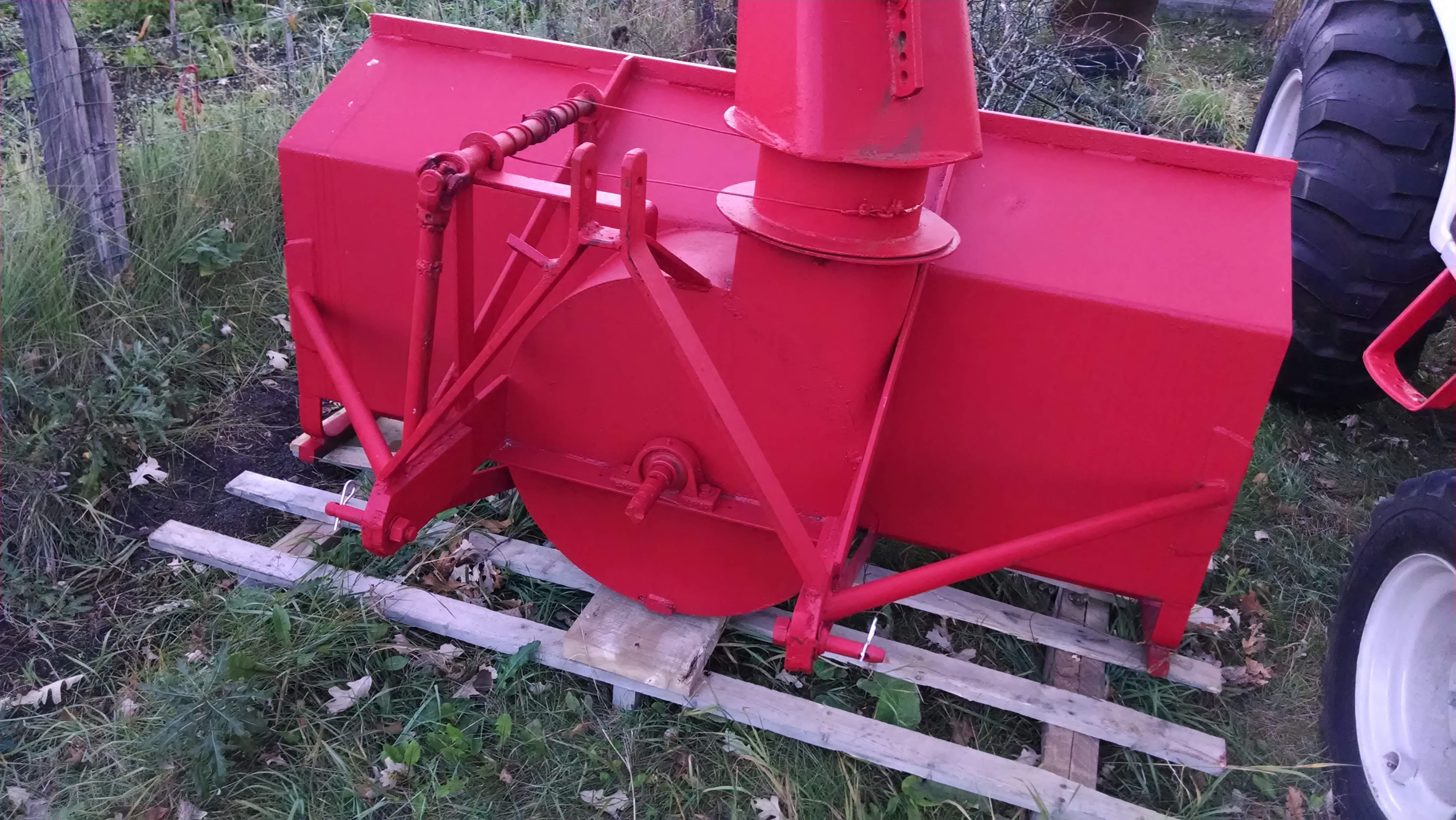

In case anyone was curious what this looked like, i also don't know who the manufacturer is either.

It almost looks like there was never any splines on there. But perhaps a siezed on PTO yoke that was torched and pounded off?????

This is why pictures are helpful. My understanding was that the actual PTO shaft was welded. I can buy PTO shafts that are smooth bore to fit over your blower shaft. Then you install a low grade bolt in the hole as shear bolt. Don't but a grade 8 in there or you could end up with some issues if something gets jammed in the blower, like a large chunk of ice.

Did this blower come with a PTO shaft? It looks to me like it is a smooth end with a shear bolt. These are designed so that if your blower eats a rock or a large chunk of ice the bolt snaps and then you replace the bolt clear the obstruction and keep going. Yes this is a bit of a pain. I snap 2-3 bolts a year on my 400m driveway. The bonus is that the bolt snaps before anything else such as impeller or tractor get broken. If you had a splined PTO then should the impeller eat a rock it stops spinning, then the PTO shaft stops spinning and that transmits back stopping the tractor. This risks damage to any of those parts. I would much rather spend $3-4 a year on replacement bolt than having to repair more severe damage.
