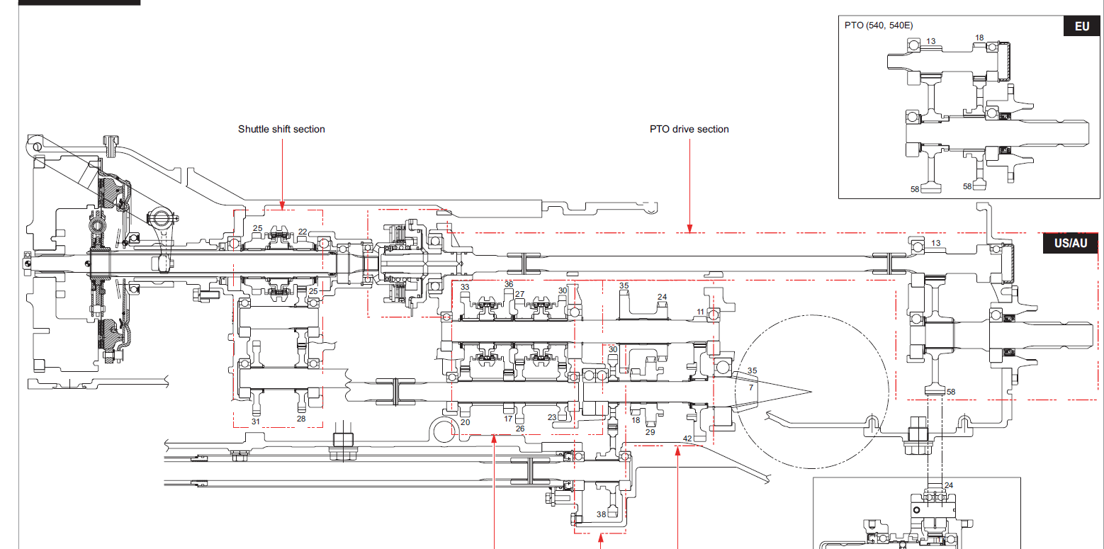

There is a direction connection between the engine and the PTO with a gear reduction with a fixed ratio in between, so yes, as you increase the engine RPM, the PTO RPM will also increase.
To switch between 540 and 540E, you would have a PTO lever that would allow you to select which speed. Think of it as a 2 speed gearbox just for the PTO.
I don't think the US models came with 540E but they do share the dashboards though, that's why you have the 2 marks there.
Running with the 540E gear engaged, at engine rated speed (2500RPM), will cause the PTO to spin at around 750 RPM. Technically overspeeding for 540RPM rated implements.
This is for the US market. Doesn't have 540E.
Here is the same for the EU market and you can see the 2 PTO speeds in the upper right corner:

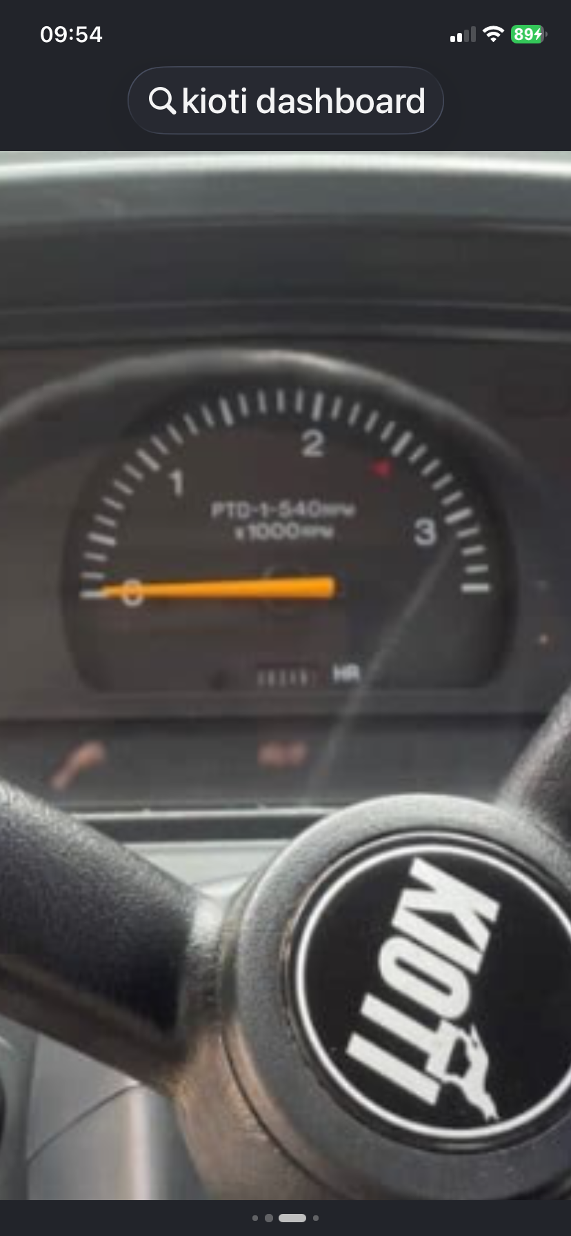

Here’s a Kioti picture, yours will be similar but different. Typically optimum Pto rpm for most implements is 540. The dash will display engine rpm with a red mark for 540 Pto speed. Once the Pto is engaged rev the engine until the tach needle is close to or at the Pto mark. Obviously the engine is revving higher then the Pto speed…

Similar to mine but I also have a mark for 540E. Not sure what that engine rpm is off hand, but I think it's around 1800. But apparently the US versions don't have 540E capability.

I wonder what my pto shaft rpm is at the 540 mark :unsure:

Not hard to figure out. The smaller gear has 13 teeth and the big one 58, so that's a 4.461:1 ratio.
What RPM does the tachometer mark when you put it in the 540 mark? Doing the math, should be around 2400 RPM.

My fault, I was wondering how accurate the mark on the tach is. I did not know the gear ratio.
Now I gotta wonder, how accurate is the tachometer :unsure:

I’d say the mark on your tach is plenty accurate. Fine-tune as needed.

I will go by the tach (2400 rpm), I was only joking about responding to the over-analyzing post 😁. I know how these things can be over-analyzed. Just go with it!
