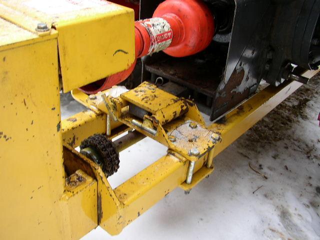

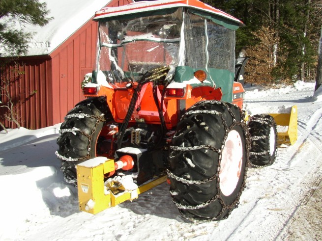

The big difference between Lorenz and Erskine front-mounts is in the rear pto gearbox. The Lorenz pto box uses gears to change the shaft rotation so the blower can be the same whether on the front or back. Erskine's pto box has a chain drive - so their front blower rotates the other way (mirror image chute and fan).
John - the pto box may extend back too much for leaving the backhoe on - it will be close. Erskine is longer than the Lorenz, but narrower. Pic of the Erskine attached. Lorenz pics at Roger's link above.
