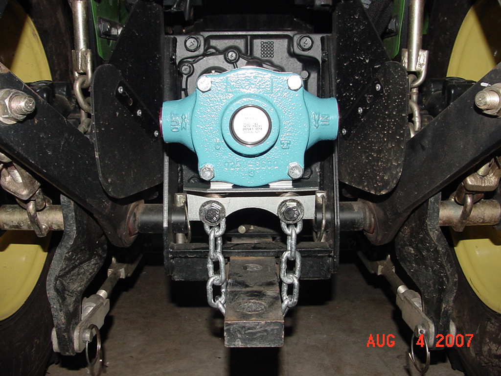

I just have a the chain loop under the drawbar for my PTO roller pump. Simple and effective.

kennyd - the chain in your photo looks pretty taut. Do you worry about binding or bearing wear? Also, does that pump lock on to the shaft? My Prince pump does not and I'm worried that if my restraining chain loosens too much the pump may work its way off.
That is just the picture, the chain is not taut at all. And yes. my pump locks onto the PTO stub with a coupler like THIS
