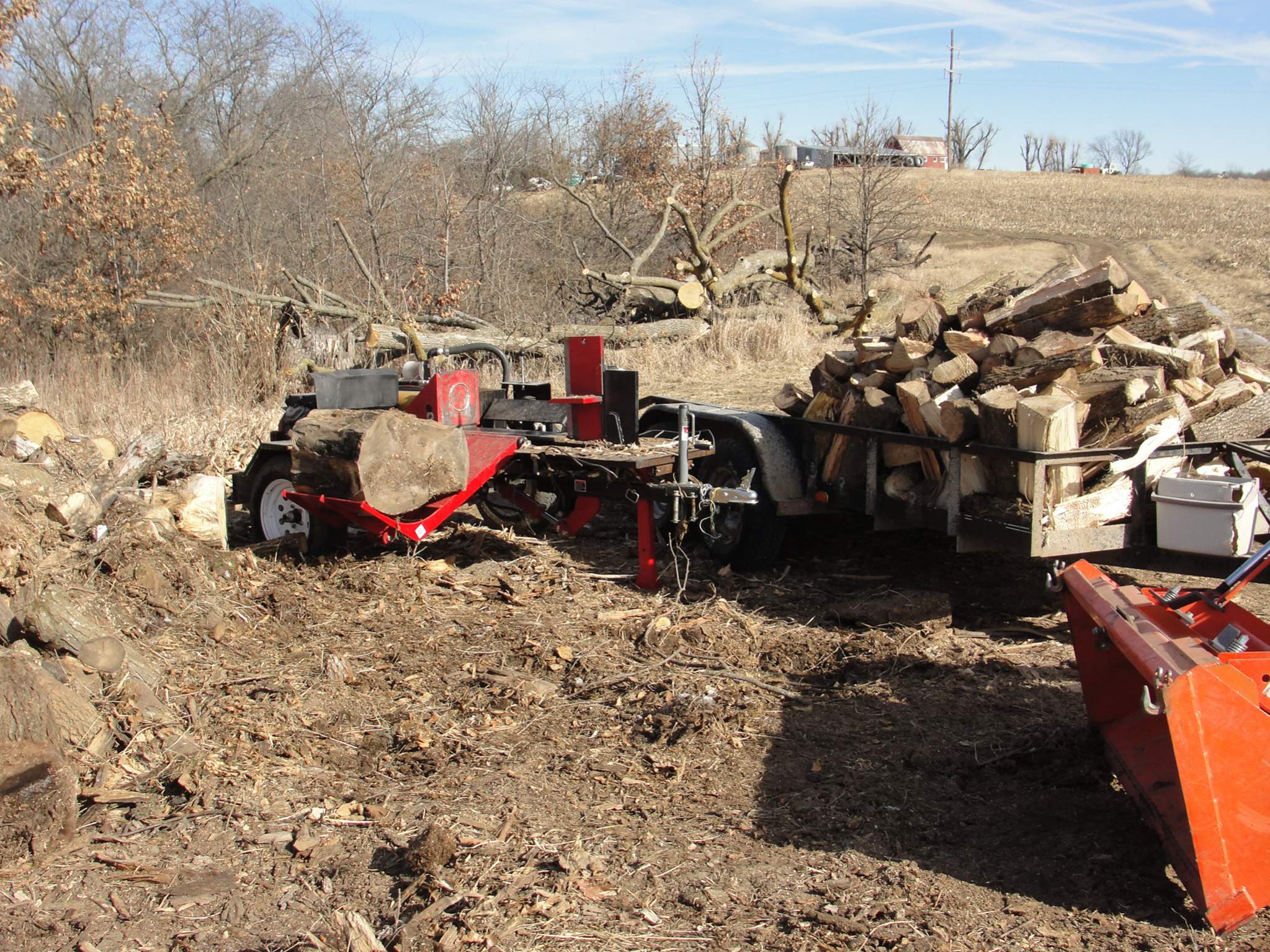

Personally i would stay with a stand alone, put another throw away motor on and your done. I have an American Splitter that was a stand alone. I converted to ride on the 3pt hitch because it sat to low to the ground. Well it sits in the barn now as a paper weight. Wore out 5 briggs and scrap iron motors, several valves and 1 pump. This was over probably 10,000 cord of wood. I have a new 30 ton from Northern and thats the way im going to stay. The little Honda has an auto idle on it and even though it runs fast its still cheaper to run, ( about a gallon every 3 hours or so ) and easier to replace than my tractors engine. We put close to 500 cord of wood through this splitter last year with no expense other than gas and an oil change now and then. Besides with a stand alone you can transport it real easy and you dont tie up a tractor with it on the back. Happy Splitting . . .John

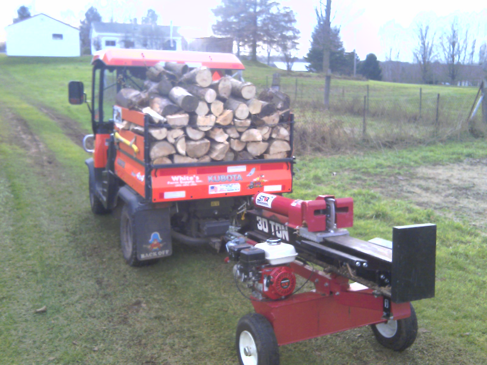

John,
That's the one I have too. I added the wedge wings a month ago. There's pro's and con's, but IMHO there are more pro's. It's a very good splitter and I really like the idle down feature. The height of this splitter is right and it's convenient to just hook it up to the ATV and tow to my various piles of wood I have pre-cut around my property.

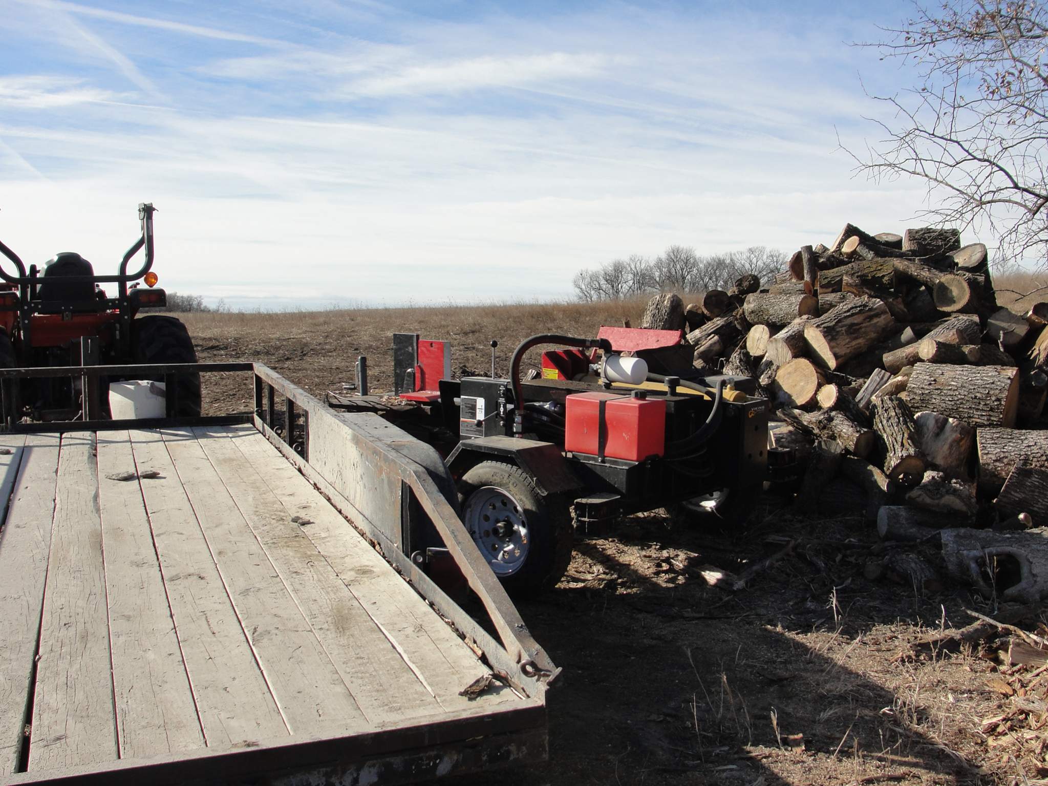

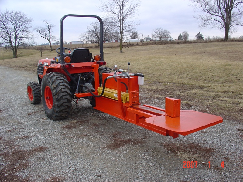

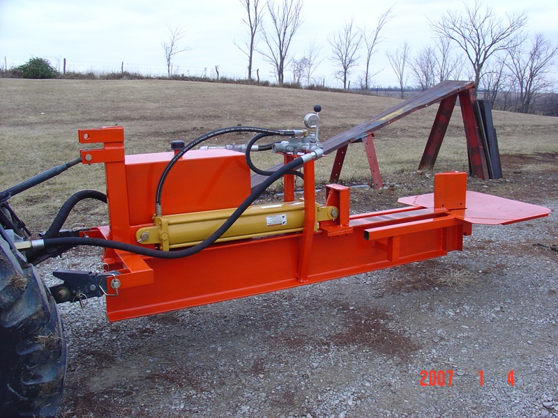

Gordon, I'm not planning on running it from my tractor hydraulics, using a pto pump, no one tells you true facts about the pto hp to the one stage pump, I just want to know if I can run the pto power splitter to it max speed with 25 hp@pto, is there a formula a 10/21 gpm 1 stage ?
I built a 3pt PTO splitter several yeasr ago. Ran it with my Kubota 2910. Had no HP problems at all, Ran tractor engine at 1500rpms. I liked the setup just fine. Only drawback was it tied up the tractor. Now I have a self powered/trailer mounted. I like the versatility better. But as you mentioned, you got another engine to maintain also.
