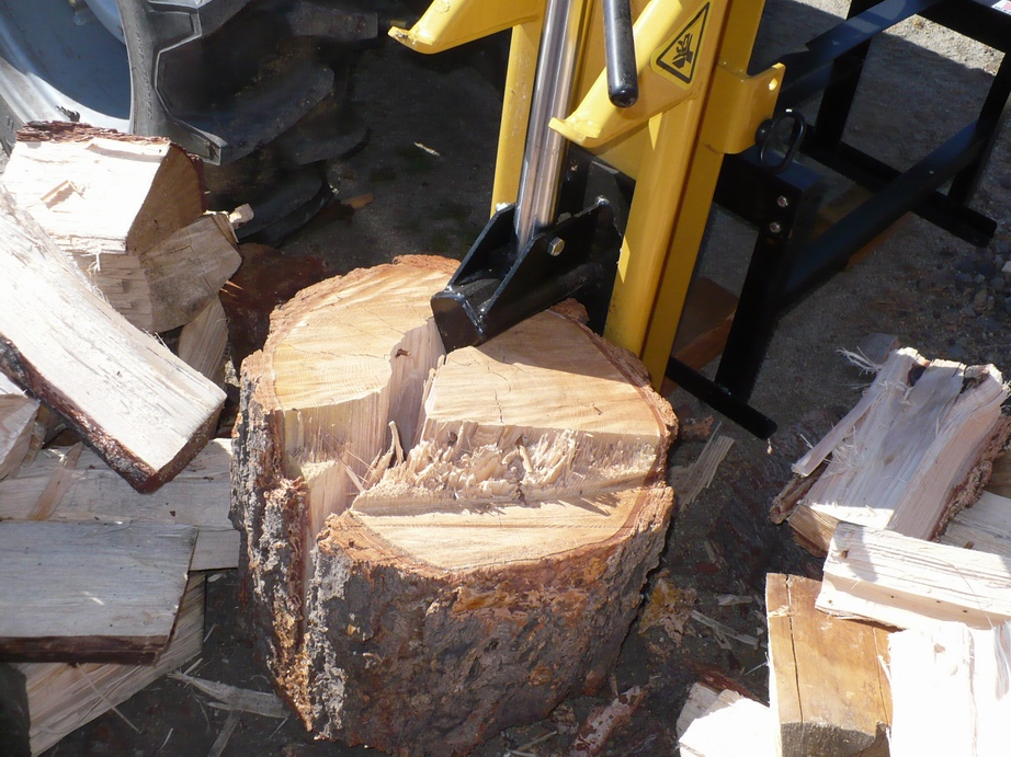

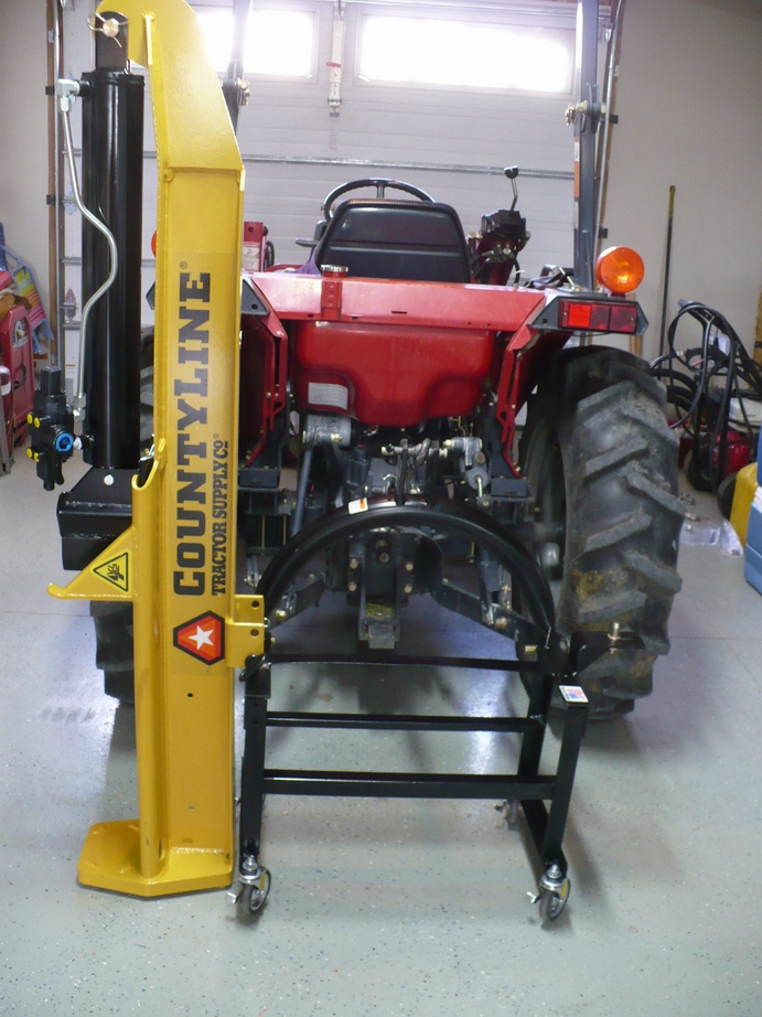

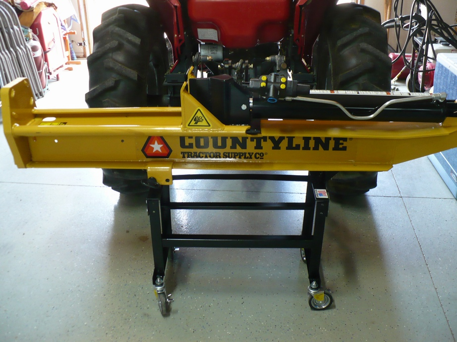

Contrary to many I'm 100% in favor of the 3 pt. I've attached castors to the splitters legs and roll it flush up against my garage wall for storage. I split about 2 cords/year and do it all in one day so tying up my tractor is not an issue. I purchased it at Tractor Supply on sale for > $700 and have used it on various tractors from 24 to 35 HP with no issue. The ease of storage, lack of an additional motor to service, and convenience and power of the 3 point attachment cannot be beat IMHO. Quick connect hydraulic couplers makes hookups easy.

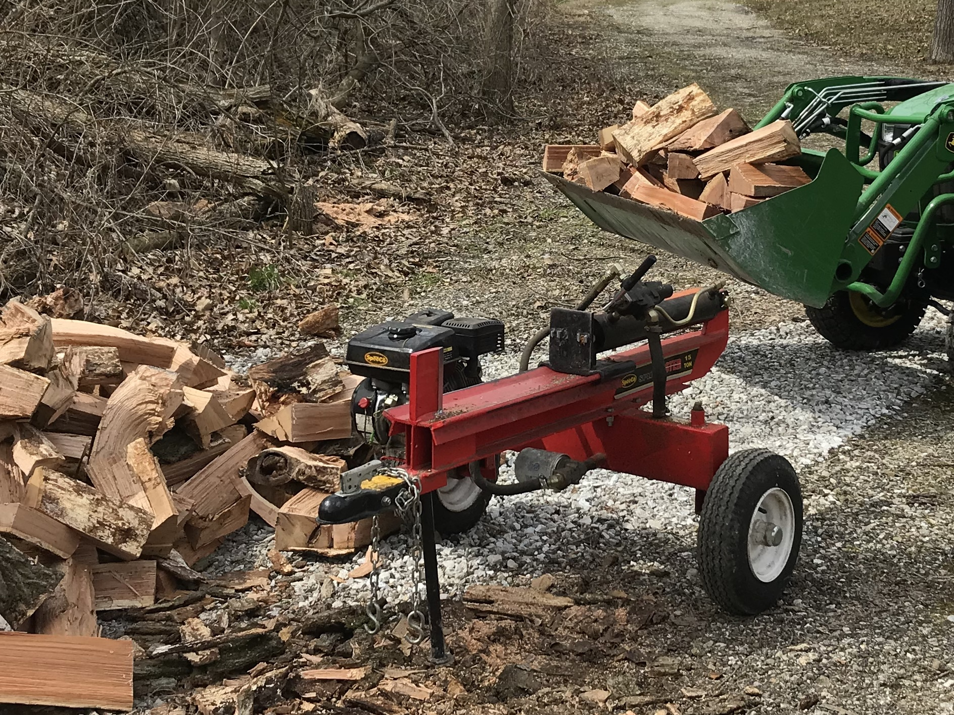

I have a stand alone 20 ton splitter that pull behind my RTV when needed. I like the convenience of not having to get the tractor out and hook up a 3 point implement... Back the RTV up, drop the hitch, load my gear in the back and head to the wood pile... I use mine several times a year and put Stabil in the fuel, in 20 years never had a problem with it.
