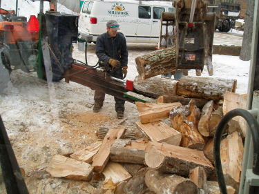

I have a homemade 3 pth wood splitter that runs off a 21 gpm pto pump.
One advantage is I can run it off any tractor, whereas a stand alone is bound to not start when you need it after a few years. I always have a tractor that will run.
As for fuel, my 45 hp Kubota runs about 2 quarts an hour of fuel when running it. I set the pto on 750 mode and idle the tractor back.
Here's a few pics, I was feeding it with the excavator while a friend ran the splitter.
