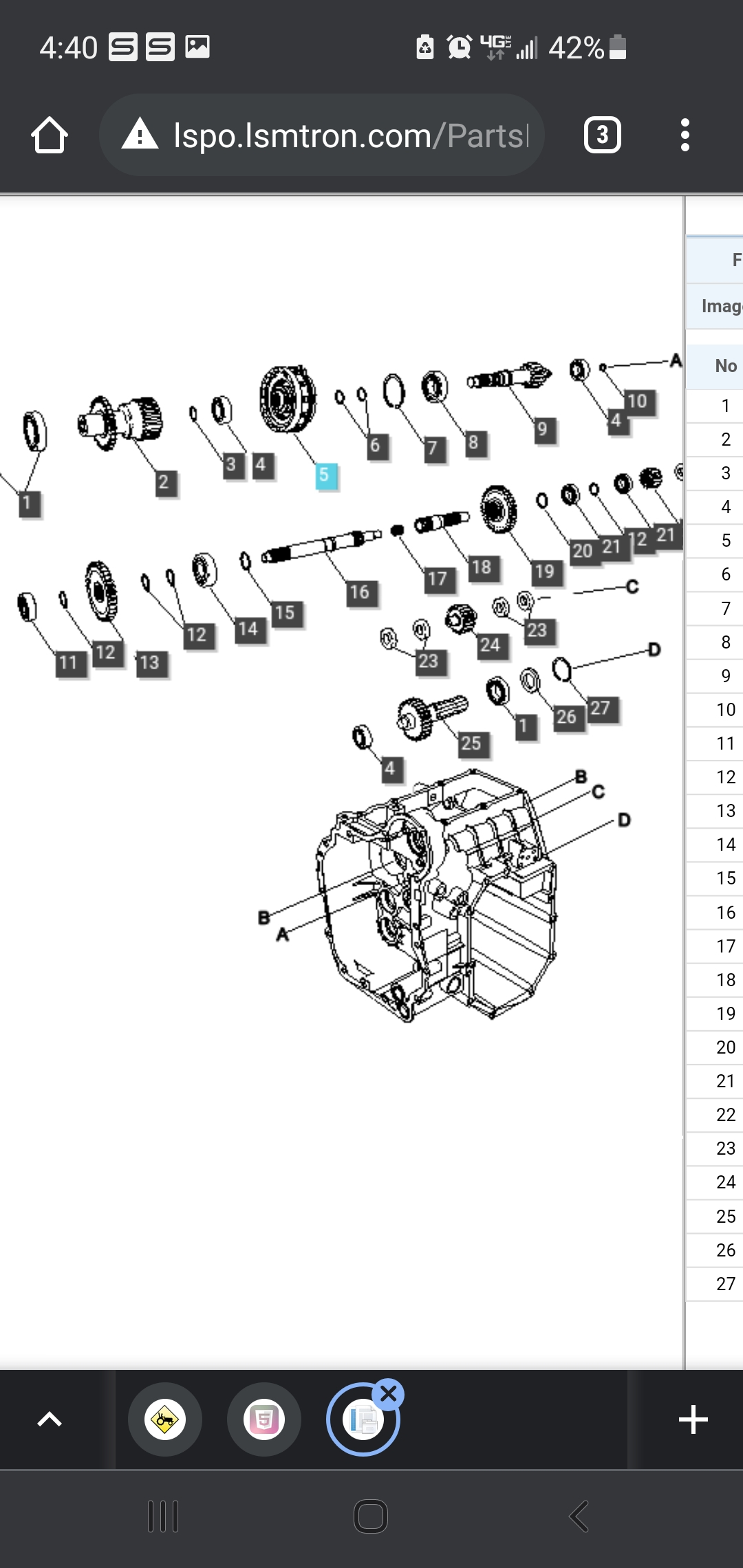

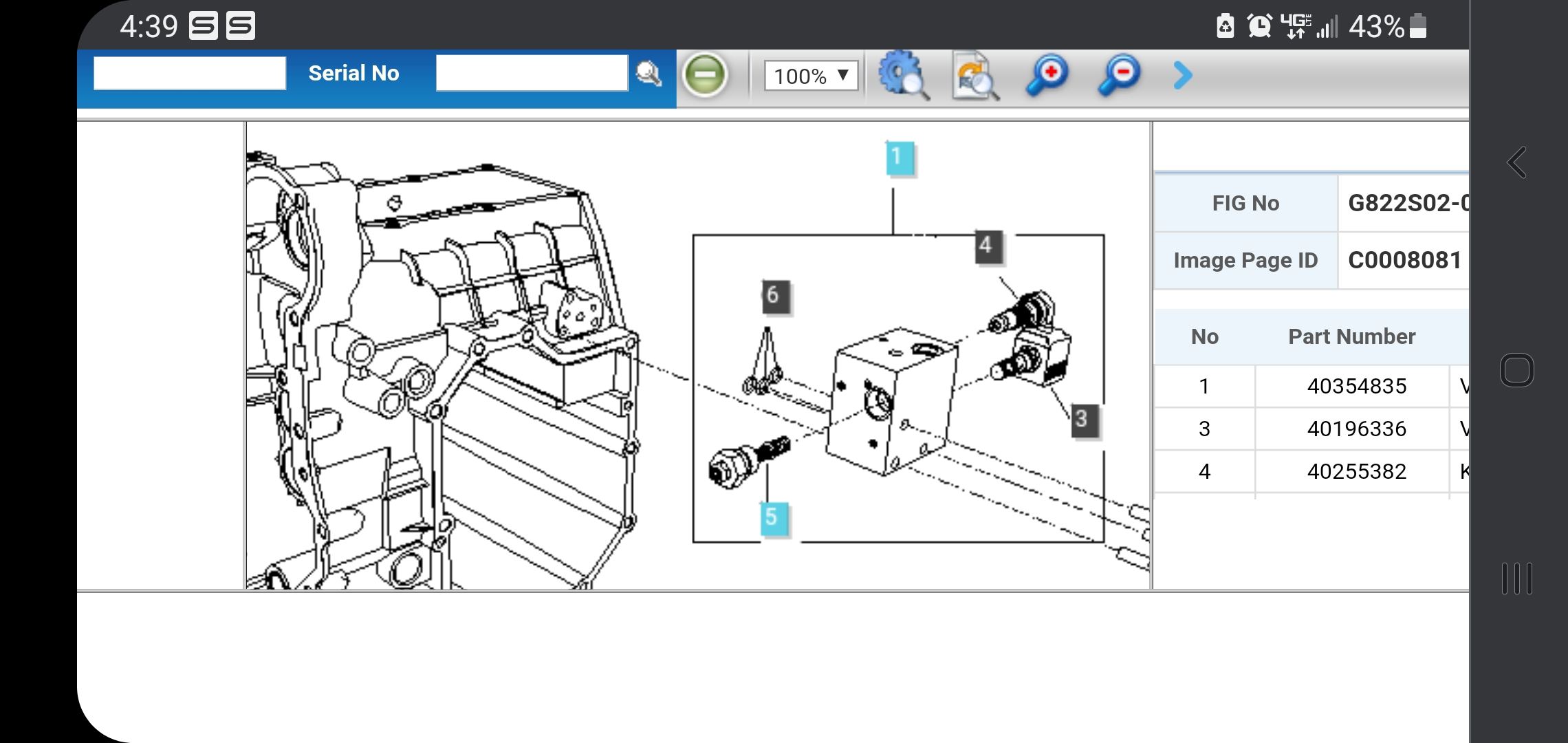

Ok for clarification pto shaft does not move when tractor off and rear pto selector in rear position. The solenoid or brake it what i fear failed as once tractor is running/on pto spins with tractor engine even though pto selector is off. Turn selector on and no response.
As far as part schematic yea you can find em but few and far between.

Your first picture seems to be the culprit.
Test that circuit with your PTO switch on/off and see if you have power.

Went out and tested few things tonight. Good news is solenoid valve clear up issue pto now comes on and shuts off with switch. The valve body was stuck.
Still have issue where pto shaft is slowly rotating whenever tractor is on Pto on rotation speeds up pto off rotating slow maybe 60rpm by my count. Could this be related to that valve sticking? Or is it what I fear it may be and the pto clutch(which i assume is what system uses as the brake) is worn and need replacement.

I'd say that the PTO solenoid valve is still sticking if the PTO won't fully shut off.
Take the part number you are looking for, put MT in front of it, and call CNH to see if they have one.

Ok found solenoid valve 3hr drive one way but only one on a shelf at new holland dealer in tri state area. Pto works with implement. But still has constant turn like the pto is getting pressure through the block when off. With implement attach has enough power to turn implement
Would this be bad oring on solenoid valve or is it one of the other valve in block? Or is solenoid valve just not seating shut fully allowing fluid to leak by into pto?
   / Pto issues wont turn on was running and stopped #20
Are you getting some stray voltage from the switch? Try unplugging the solenoid and starting the tractor, does the PTO still spin?
