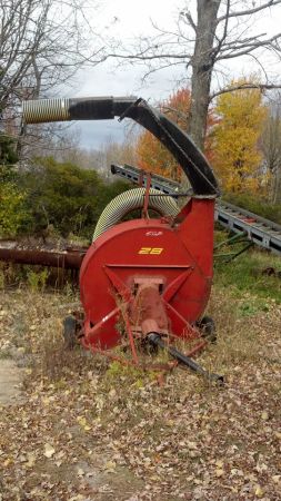

Ed;
Here is your machine. Make sure you put about 40hp on the blower to get the full effect.
/ PTO Grass Vacuum #48
Agent Blue: Please post more pics from all around your machine. Looks like the ideal vacuum blower.
