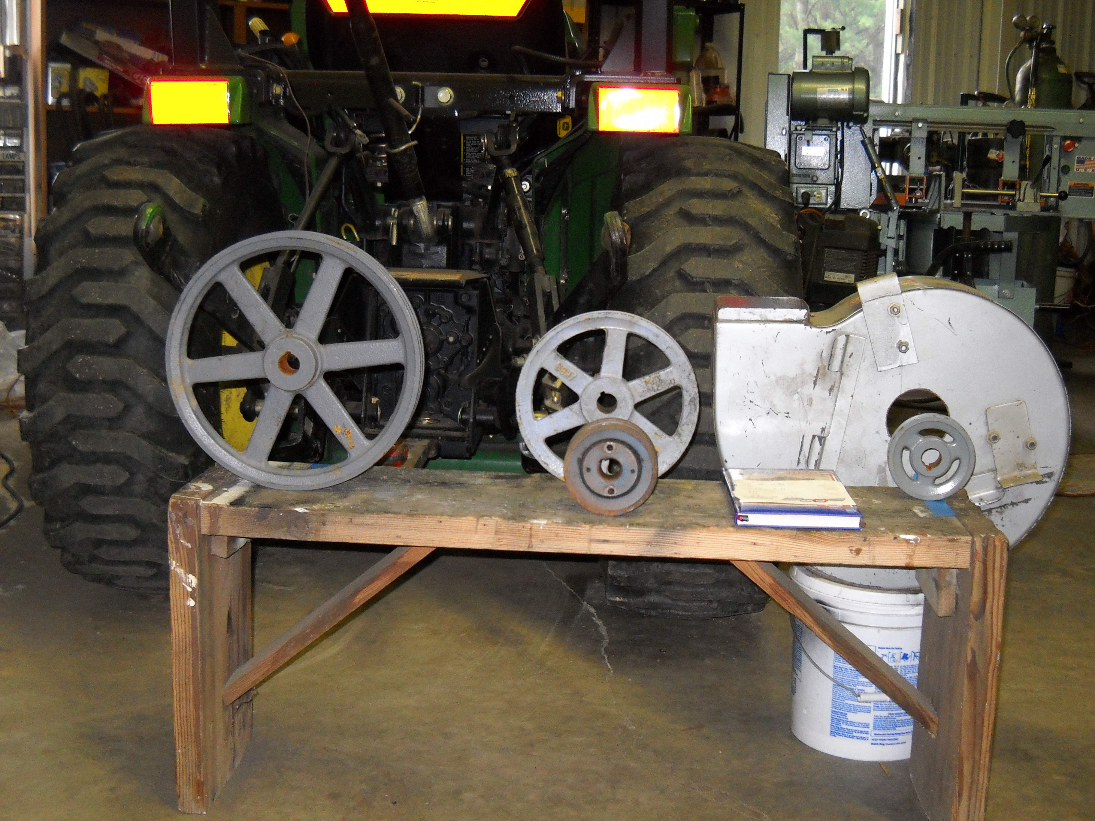

Anyone build or own a PTO powered vacuum for lawn care ? I am about to use my imagination and build one. I have some parts, pieces, and a blower housing. If it don't work I won't be out much but time. The pine needles have won in the past. I hope this will be their downfall.

I don't see why a blower wouldn't work, if the squirrel cage is strong enough. I'd probably have it sucking the mower discharge (if you have a belly mower) to make sure anything you suck gets a chance to chopped first.
Do you know what speed you blower was designed to run at?
   / PTO Grass Vacuum
The fan is 12" with 4" paddles. Have no clue what speed it turned in a former life but with these pulleys the calculator indicates 3139. The fan will be 4' from the mid mounted mower chute with an 8" flex hose connection. I have no doubt if it runs without vibration it will create the lift necessary to empty the deck of swirling debris.

You said, 12" fan with 4 paddles.........
That tells me it is designed to move some kind of product suspended in air. Not just air alone.
Go for it............ And post LOTS of pictures of your build and results.

Four paddles, 4" deep. This housing / fan came out of a lawn vac that one walks behind. It is going to be operated by a 21 hp JD diesel. The mid mounted mower and the vacuum can be used seperately by moving a selector lever. If it takes too much power the frame can be used to bolt in a four cycle engine. Still eliminates the trailer and its width / turning / backing problems. I bet it out performs a leaf rake, especially on a large lawn.

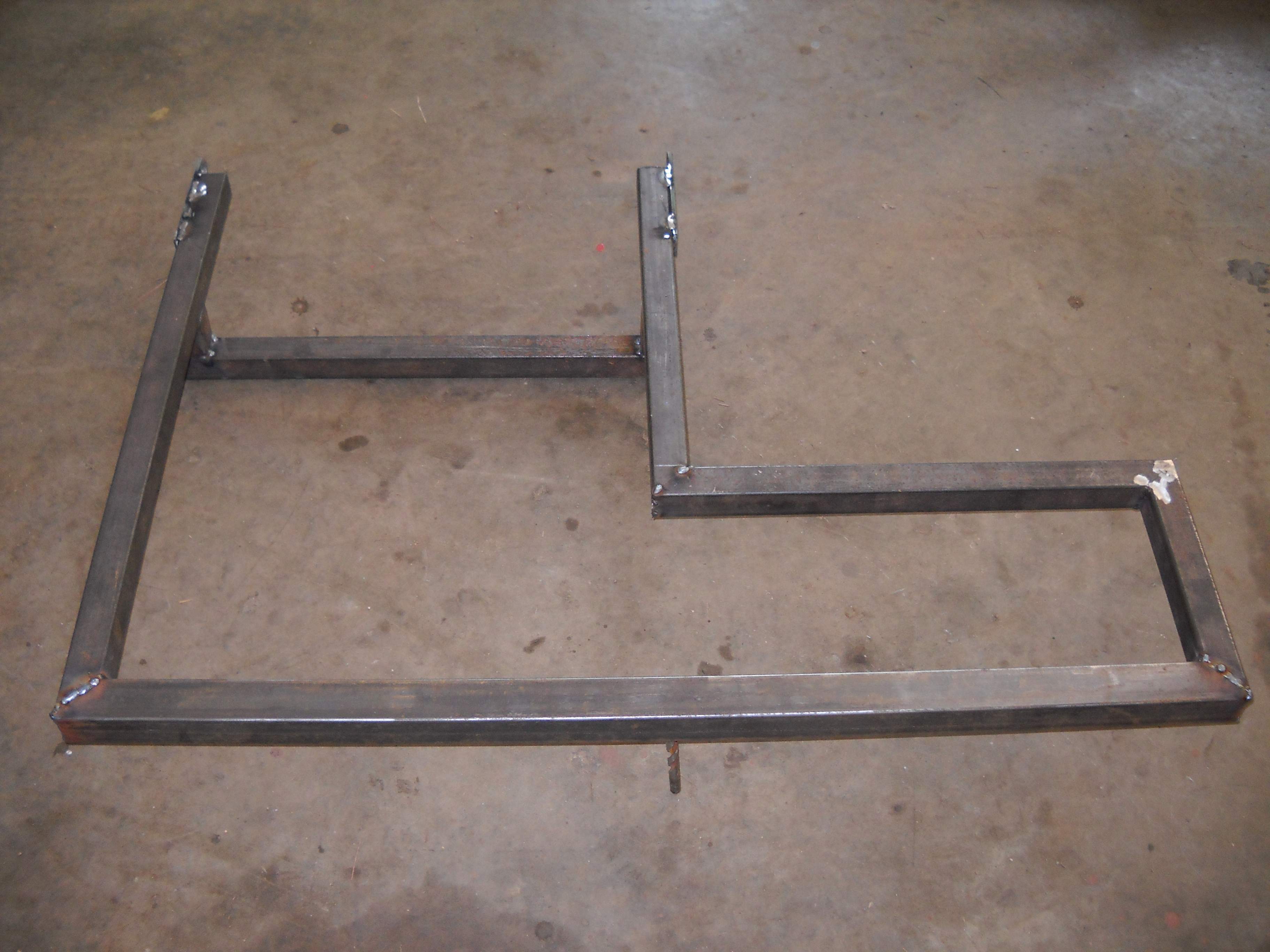

That is interesting, thanks for the info. It sounds as though your setup is for pulling a seperate trailer. My goal was to make the unit all in one for ease of maneuverability. You bought the deal of the day as their web site indicates three grand, now add shipping, tax.
I am waiting for the bearings to mount the shafts so I just have a frame temp welded up. I have learned not to complete the welding process as I go because of alterations needed I didn't plan for. ( More hind site than fore sight in most cases. ) I need some light sheet steel to make the transition from mower to tube also so its off to the steel yard. This past year I am getting to be a frequent customer.
